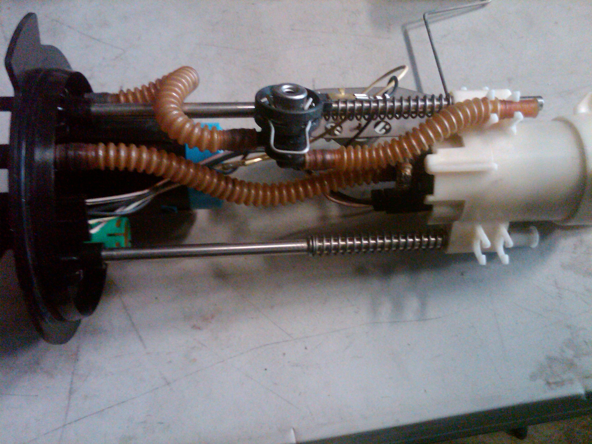

fuel pressure on 2007 ford ranger
64K on the truck, auto-trans delivery truck for our business. 2.3L 4 cyl. AC. The fuel pressure falls on it's face sometimes. We have been fighting this off and on over 6 months. We have put 3 pumps in it. Fuel filters etc. The pressure measured at the port on the rail is about 65-70psi when the problem shows up it goes down to 15. The system is return-less. Two lines go into one end of the fuel filter, one goes out the other end to the fuel rail. The fuel pump assembly has a regulator on it that is inside the tank. I know BMW's and Porsche's very well...but this POS is really throwing me. Our first pump died because of junk in the tank. It was 100% cleaned out and filters swapped (and cut open to look for goodies). We have done the oblivious.
May 1, 2019 at 11:36 AM
(Merged)
AUTOBAHN_PARTS
MEMBER
9 POSTS
Photo of the first pump...
Image (Click to enlarge)

I was told the voltage was checked. I will have to check it myself to be sure. Believe it or not, this is the second new pump installed. Due to the problem, I had the first replaced with a second. Problem remained. I picked up the idea somewhere that the pump controls pressure by varying the speed or somehow pulsing the pump. I am wondering where the signal comes from and how to check this. Have you ever run into anything like this? Am I misunderstanding something?

No, you are describing Pulse Width Modulation which your truck is not equipped with. That requires a Fuel Pump Driver Module which you do not have.
Checking voltage and voltage drop are two different thing. A voltage drop test reads loss in the circuit.
