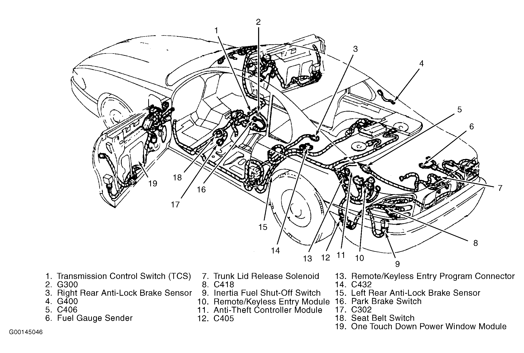

Fig. 1: Anti-Theft Control Module Connector Pin ID (Mustang)
Courtesy of FORD MOTOR CO.
ANTI-THEFT SYSTEM -1996 Ford Mustang Page 1 of 7

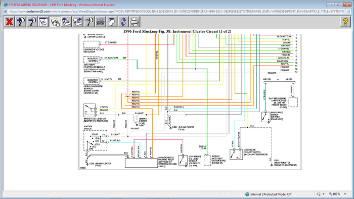

PINPOINT TEST A - ALARM DOES NOT ARM PROPERLY
Start vehicle, then turn ignition off. Disconnect Anti-Theft Control Module connectors. With
doors closed, measure voltage at Anti-Theft Control Module connector C2, terminal No. 14.
See Fig. 1 . If voltage is less than 9 volts, go to step 3). If voltage is more than 9 volts, go to
next step.
1.
Disconnect both courtesy lamp switches. Measure voltage at Anti-Theft Control Module
connector C2, terminal No. 14. If voltage is less than 9 volts, check door courtesy switches and
retest system. If voltage is more than 9 volts, repair short to battery power in circuit No. 24
(Dark Blue/Orange wire) and retest system.
2.
Disconnect Anti-Theft Control Module connectors. Measure resistance between connector C1,
terminal No. 6 (Dark Green/Purple wire) and connector C2, terminal No. 26 (Black/White
wire). If resistance is less than 100 ohms, go to next step. If resistance is more than 100 ohms,
go to step 6).

realy good info thanks ,where is the anti theft controll module on the car. also on the ignition block theres a device with a black wire wich seams to hook in on top of the ignition key block any idea what this does
Mar 9, 2017 at 6:04 AM (Merged)

RIVERMIKERAT
  • 6,110 POSTS
Left rear of the trunk. See image. I have also attached a screenshot of a portion of the instrument cluster schematic showing the ignition switch.

well i removed the anti theft unit from the wiring(its in the boot found it with picture you supplied)plug started the engine it still cuts out and flashes theft on the dash same as before,if engine runs but cuts out 2 sec later with or without the alarn connected .any idea what unit is causing problem
