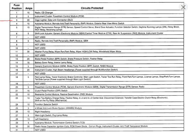

1999 Ford F-150 Scanner Won't Power On
HWESTRA1
Using a handheld scanner i don't get any codes, it will not even turn the scanner on.
Mar 16, 2006 at 12:33 AM
SQM
  • 6,383 POSTS

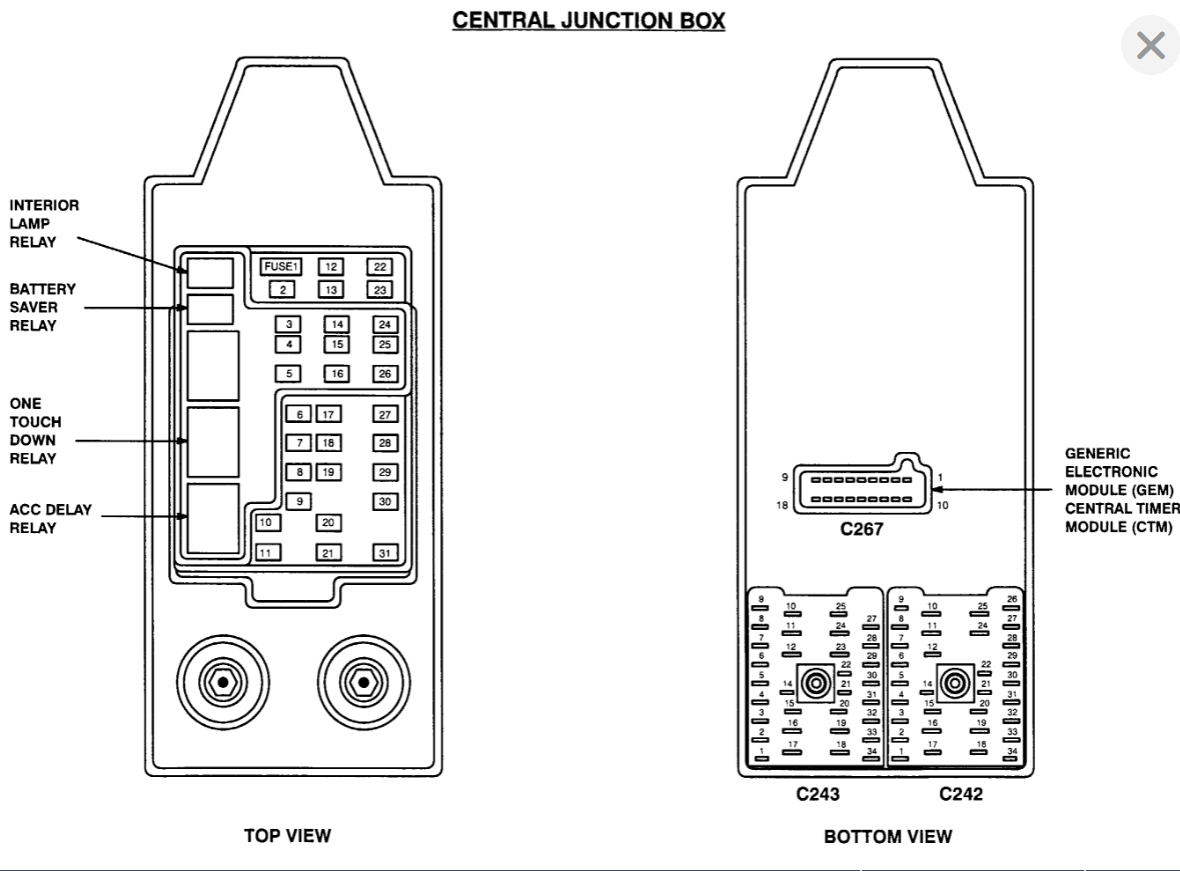

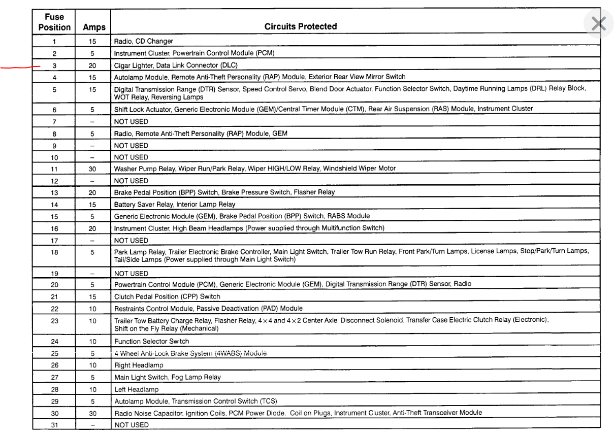

No getting power to the scanner is likely due to a blown fuse.
Check the #3 fuse in the under the dash fuse box. It should be a 20A fuse.
I have attached the diagram below.
Let me know what you find.
Jan 14, 2022 at 5:50 AM
Suggested Repair
Check the #3 20A fuse in the under-dash fuse box. No power to the handheld scanner is likely caused by a blown fuse.
