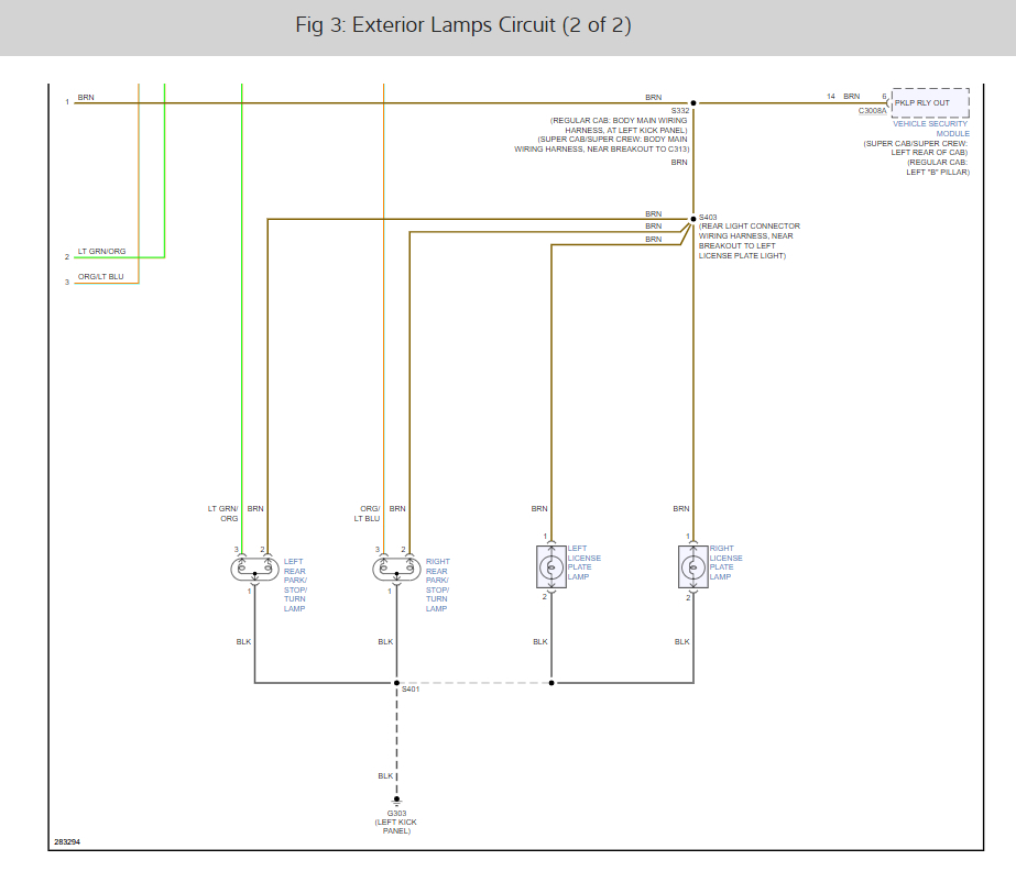

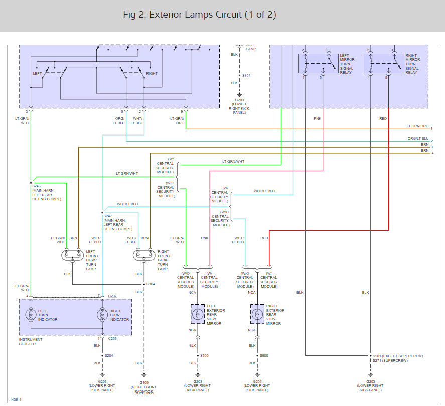

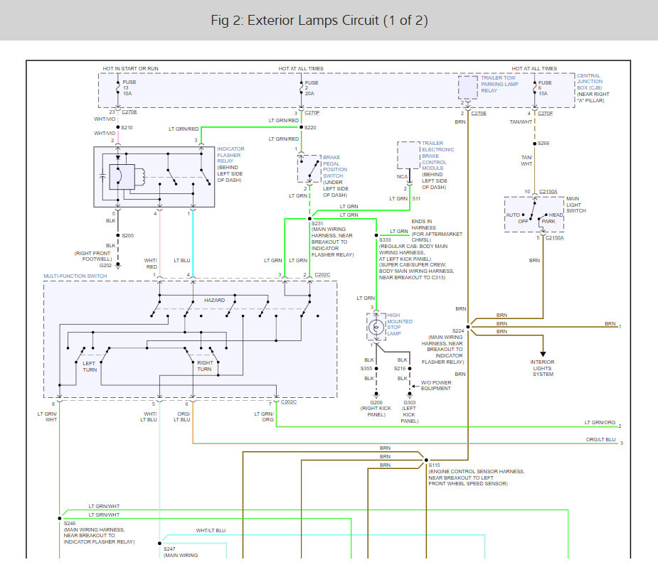

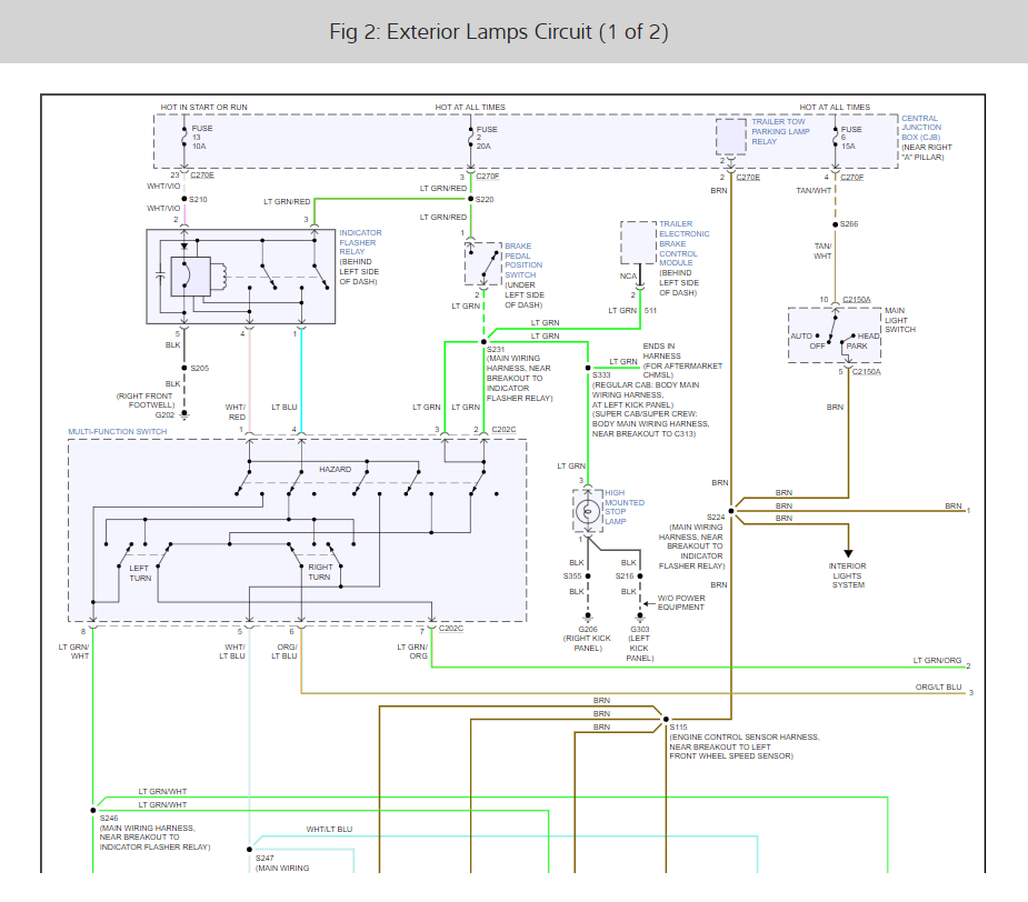

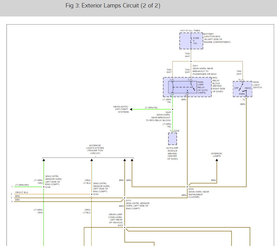

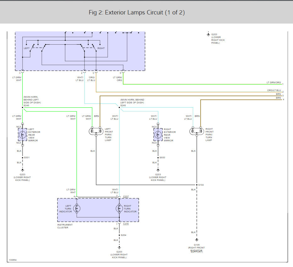

We have pulled several trailers over the last year and a half with no problems. Now the running lights do not work. The turn signals and brake lights work fine. Where do I start looking for the problem?
Sep 25, 2010 at 9:46 AM
KHLOW2008
  • 41,814 POSTS
Hi Robert ,
It sounds like it could be the headlight switch but to be sure lets check the fuses and run down this guide to get started.
https://www.2carpros.com/articles/no-tail-lights-exterior-running-lights-tail-lights-out
Here are the running light wiring diagrams so you can see how the system works. Check out the diagrams (Below). Please run this test and get back to us.
Sep 25, 2010 at 11:30 AM
ROBERT A MEYER
Yes, it was fuse #6 fixed it, thanks for your help and the guidance.

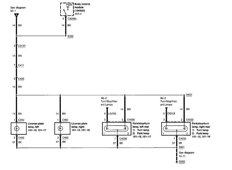

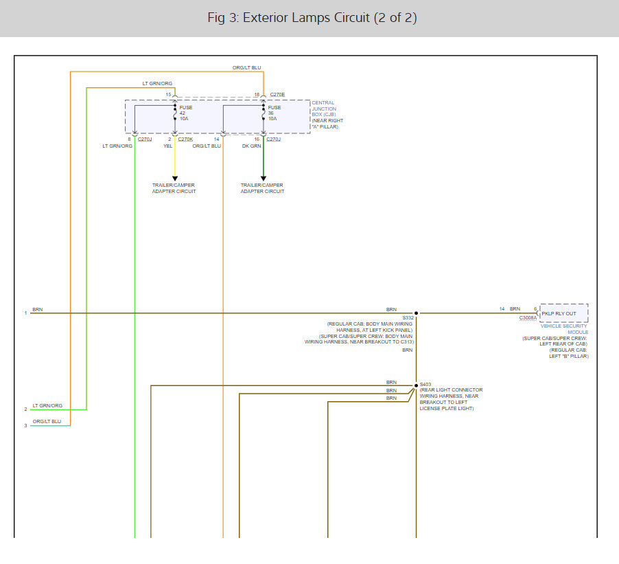

When I turn on my headlights, my taillights do not come on. All other lights work as they should. My turn signals to the front and rear work, my hazard lights work, my back up lights work, and my dash lights work. When I turn on the daytime running lights(one click to left from off position), my taillights work, but I have no dash lights. I have checked the switch, fuses, relays. I have changed both bulbs to the rear. I am suspecting a possible bad ground somewhere but have no idea where to locate the grounds. Any help would be appreciated.
Jul 28, 2020 at 12:15 PM (Merged)
Good morning.
The rear tail lights are controlled by the BCM. It looks for a command from the headlight switch to the BCM. once that is sent it will turn on the rear lights.
You need a scan tool that can read live data from the BCM. You need to verify a signal is being sent to the BCM from the headlight switch and that the BCM is seeing it and sending commands to the rear lights.

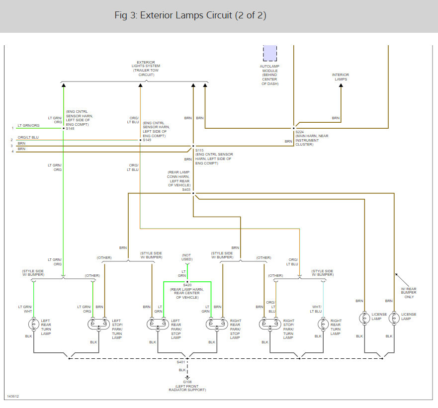

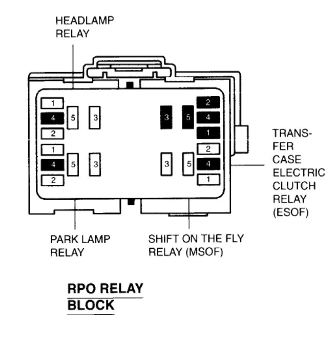

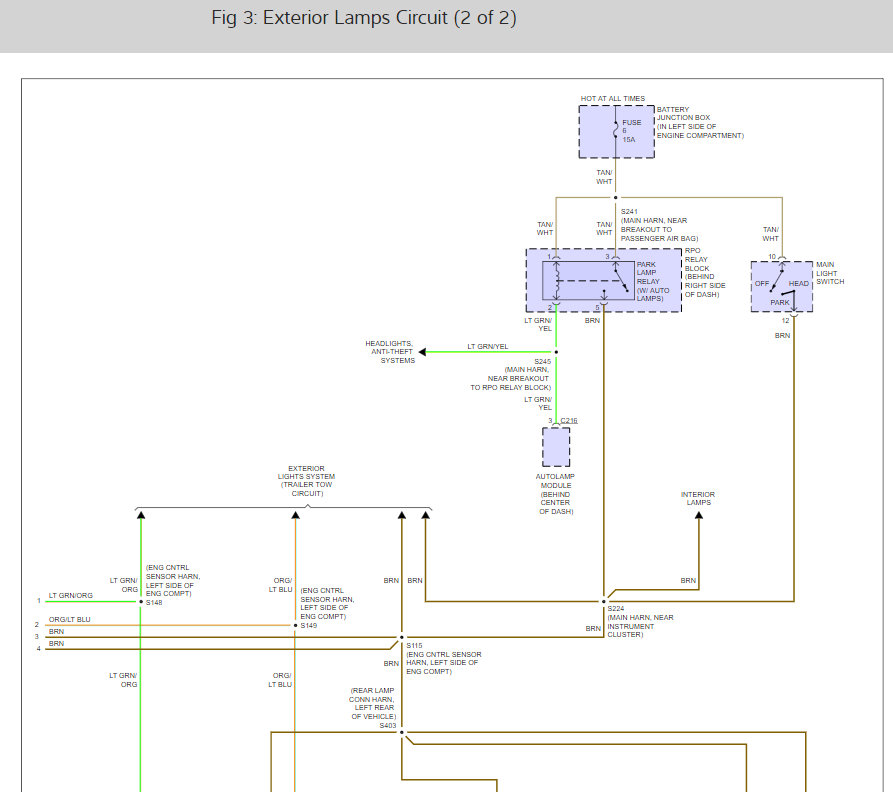

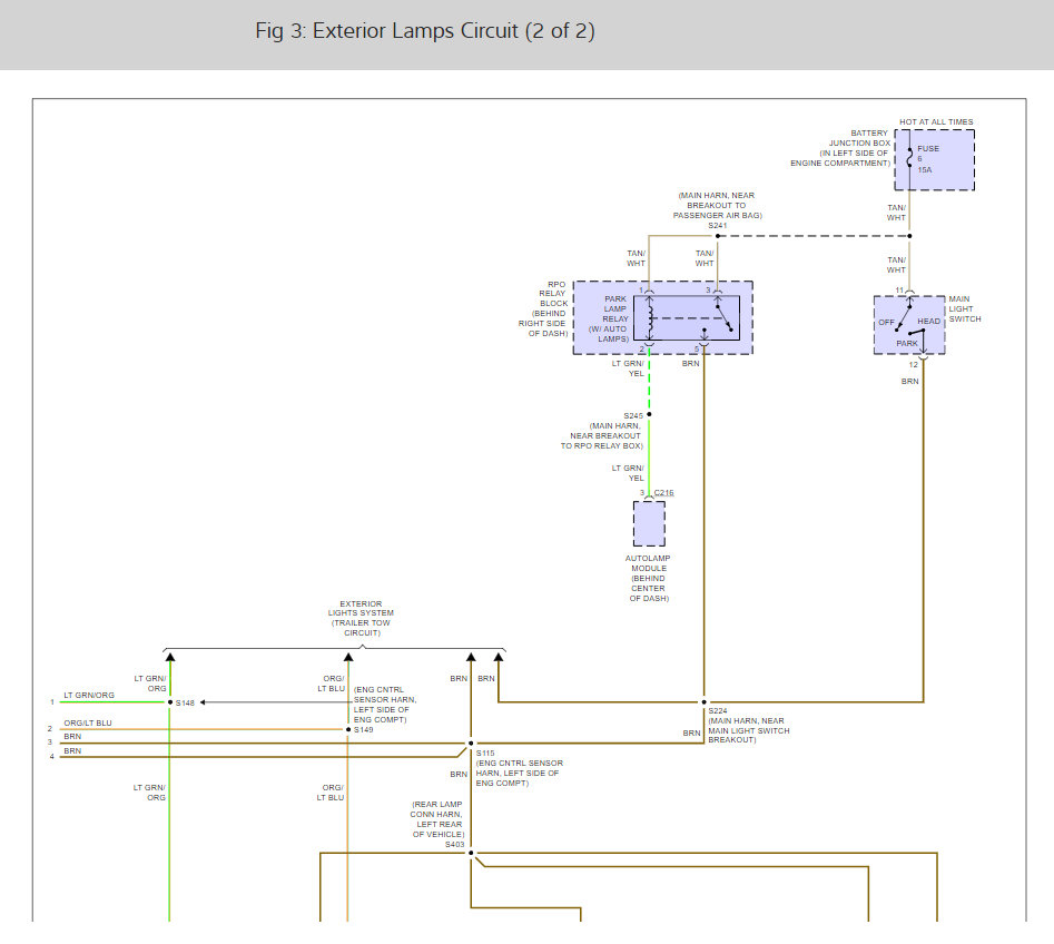

tail lights have stopped working. All fuses and lamps have been checked. Electrical circuits have been tested and are checking out fine. Light switch has been pulled and tested. Where do I go from here? It seems as if everything is in working order, but no tail lights.
JDL
  • 16,098 POSTS
It sounds like the parking light relay is not working but to be sure are two guides and the tail light wiring diagrams to see where you are losing power.
and
Check out the diagrams (Below). Please let us know what you find.

JDL
  • 16,098 POSTS
Do you have voltage at the brown wire, headlamp switch turned on?
DUTCHLADY
Yes there is voltage at the switch. Switch was taken out and tested.
JDL
  • 16,098 POSTS
I'm talking about at the rear lites, not the switch?
DUTCHLADY
It was the relay thanks for he guides and helping me I love this stie all for free god bless you guys.

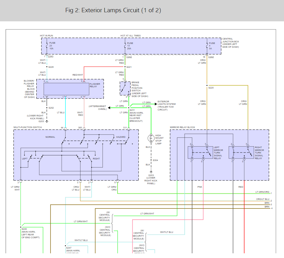

NOHJ
Now I have problem with tail light. I have front amber running lights. Do not have tail light. Talked to auto electrician. He said,"The power distribution box in right side engine compartment has possible failure. Find the tail light wire in distribution box. Put battery volts to the wire. If the tail light lights up then that is the problem.". He told me the distribution box is made up of several layers of connections. The connectors between the layers fail. The fuse test will always show volts. I would like to know correct wire color is for my 2000 F-150 xlt 4.2l. I think it is brown white tracer.
  • 54,840 POSTS

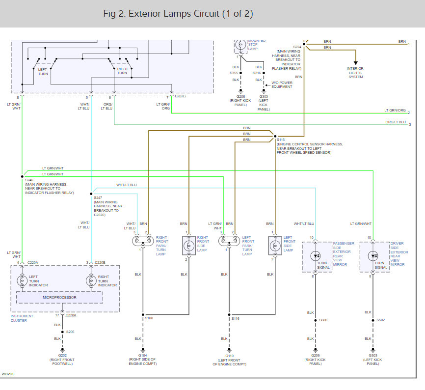

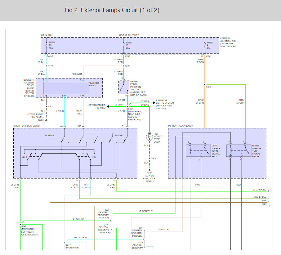

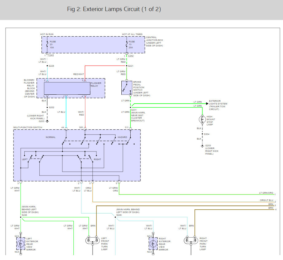

It sounds more like a hazard switch that is out. Here is the wiring diagram and a guide to help you do some testing so you can get the problem fixed.
Here are the blinker light wiring diagrams and you can see there is no PDC in the circuit except for the fuses.

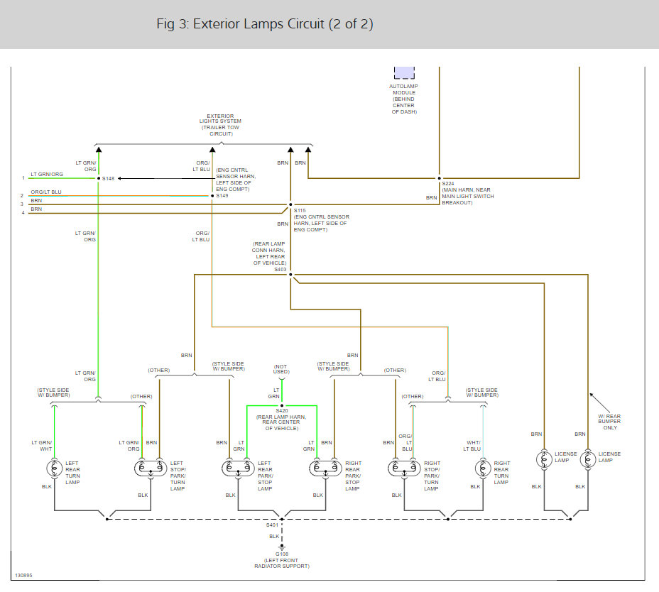

1991 Ford F150, headlights, brake lights and turn signals all work fine but no front or rear running lights (tail lights). I've checked the fuse and it has power to both sides. Could this problem be related to the trailer hitch wiring? Not sure but the problem SEEMS to have started when the trailer was plugged in bacwards.
I'm stuck! Any suggestions.
Jul 28, 2020 at 12:16 PM (Merged)
NOS
  • 320 POSTS
pull the switch out of the dash or at least get where you can look at the wires Ok find the brown it may not be hard to spot it will be the burnd up looking one take a test light and turn the switch on test lite the brown wire if you have no light pull the plug out of the switch i bet you will find it melted. the wire is not heavy enough to hold the load of the truck and the trailer. and if trailer was wired wrong it feed power to ground and burned the wire up. the brown wire is the whole key from front to back .(NOS)
