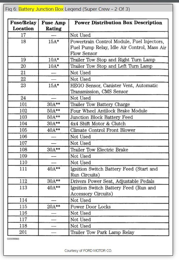

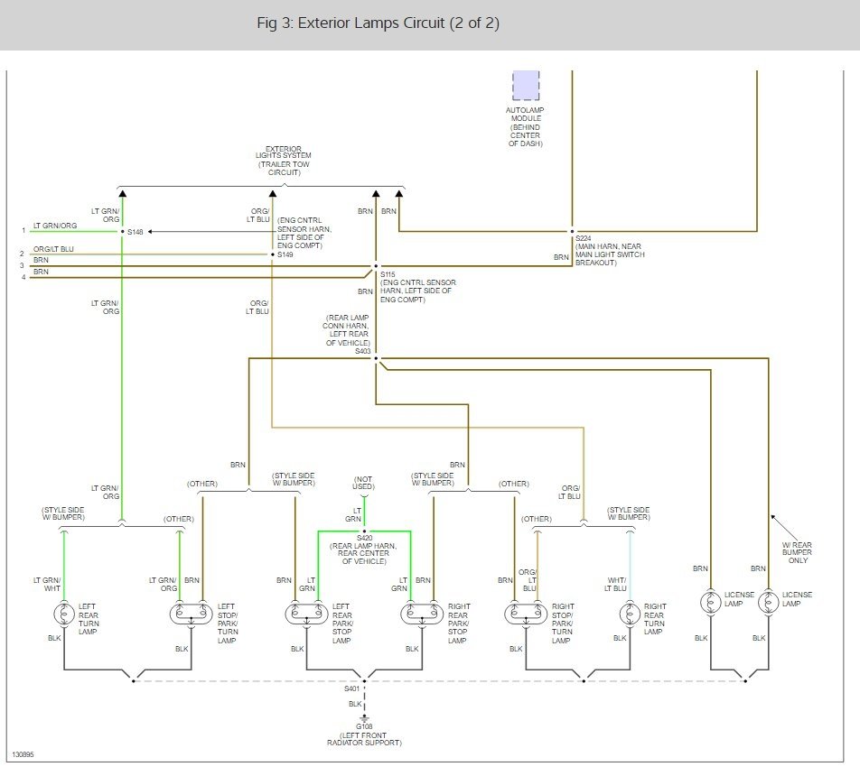

For the first time yesterday my parking lights will not turn off without disconnecting the battery pulled the switch out and lights stay on. It does have trailer hook up factory installed. please help
May 29, 2017 at 2:02 AM
  • 55,238 POSTS

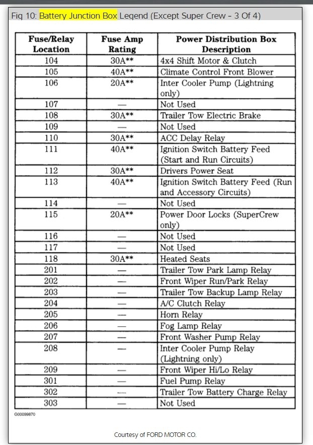

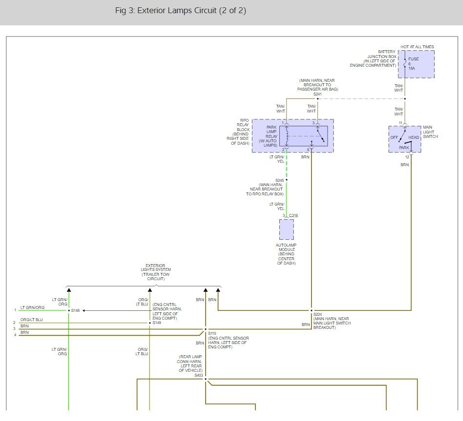

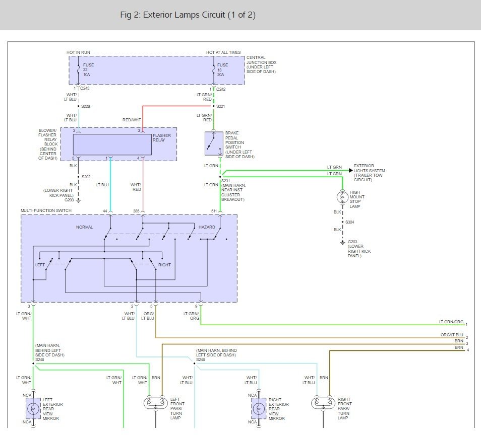

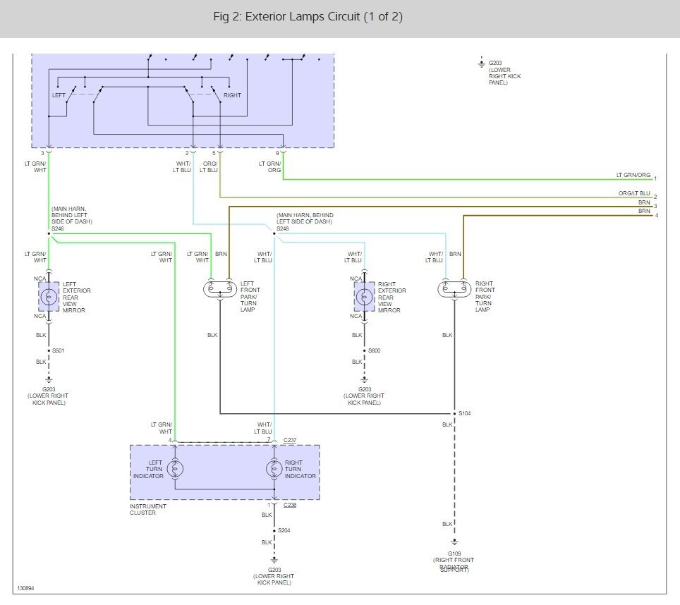

Yep there is a parking light control relay that is stuck on and it needs to be replaced, here is a parking light wiring diagram (BELOW) and a guide to help you do some testing to be sure.
and

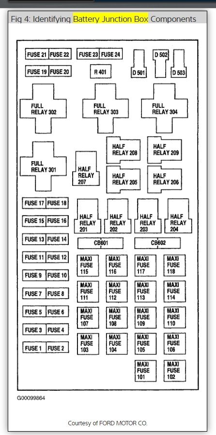

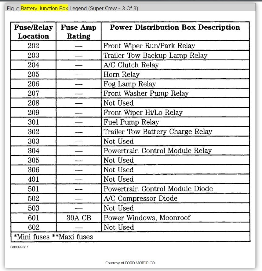

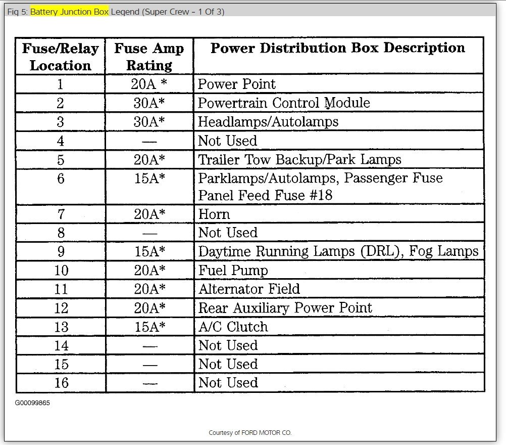

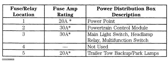

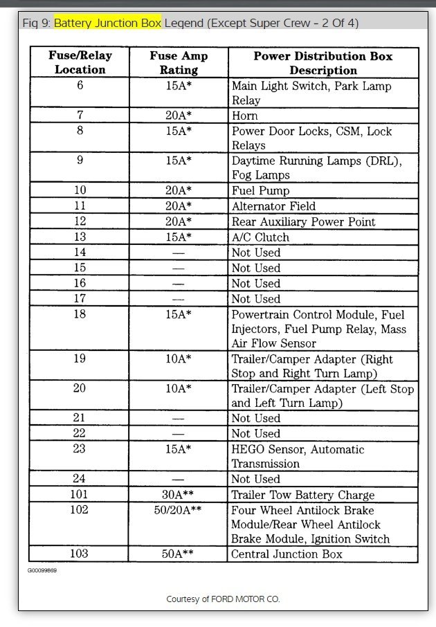

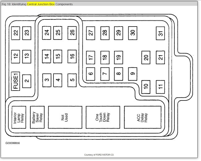

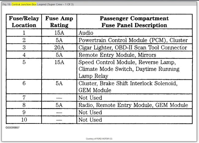

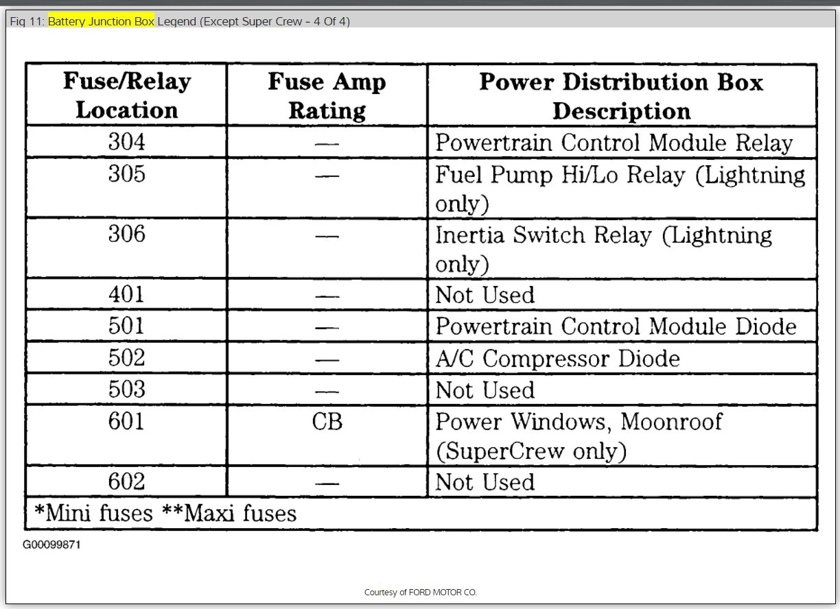

Here are all the fuse and relay diagrams as well.
Please run some tests and get back to us so we can continue helping you.

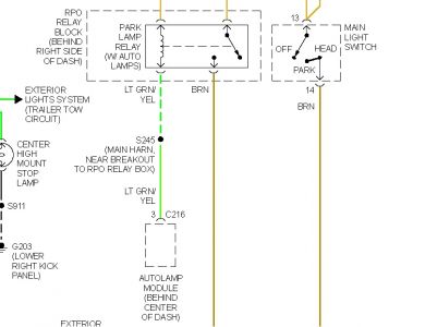

My 1999 f-150 xl base model, no power windows, locks etc. Every time I turn my lights on and off, my parking lights will stay on till I disconnect the battery. Then they will be off. Till next time I turn them on again. I do not have Auto Headlights or alarm system.
What could be the problem? where do I start looking?
May 31, 2017 at 8:46 AM (Merged)
JDL
  • 16,098 POSTS
My info shows two ways for those lamps to get voltage, lamp relay or headlamp switch. You could pull the lamp relay, see if the problem goes away, just for testing. It is the lamp module that grounds the relay.
https://images.2carpros.com/forum/automotive_pictures/170934_ford_f150_lamps_1.jpg
CARDUDE13
I TOOK OUT RELAY 201 AND IT FIXED THE PROBLEM. I SWAPPED THE RELAYS AROUND WITH NO IMPROVEMENT. BUT WHEN I DO NOT HAVE A RELAY IN SLOT 201 THE LIGHTS WORK PERFECTLY. I HOPE THIS HELPS OTHERS.
