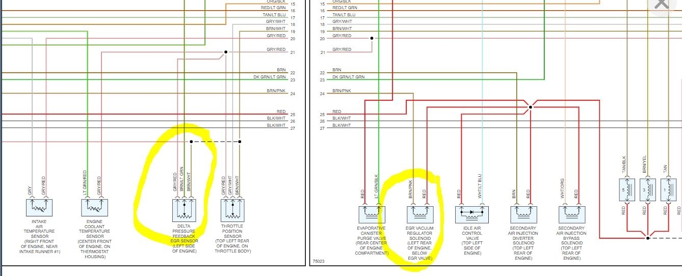

The EGR Vacuum Solenoid gets initially 14v on one pin and 0.08v on the other, after a few mins 14v on both pins. This is with the connector installed on the solenoid and engine running.

No, not the solenoid. We are working with the DPFE. That has the 5 volt signals you sent me.
The solenoid will have that until the PCM grounds the return side. Then the voltage will go to 0 and the solenoid will open.

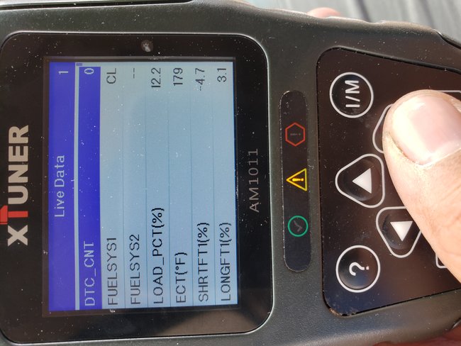

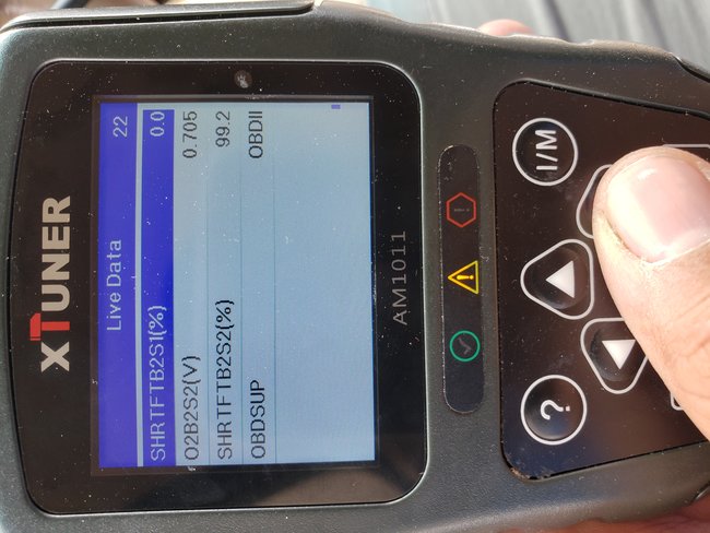

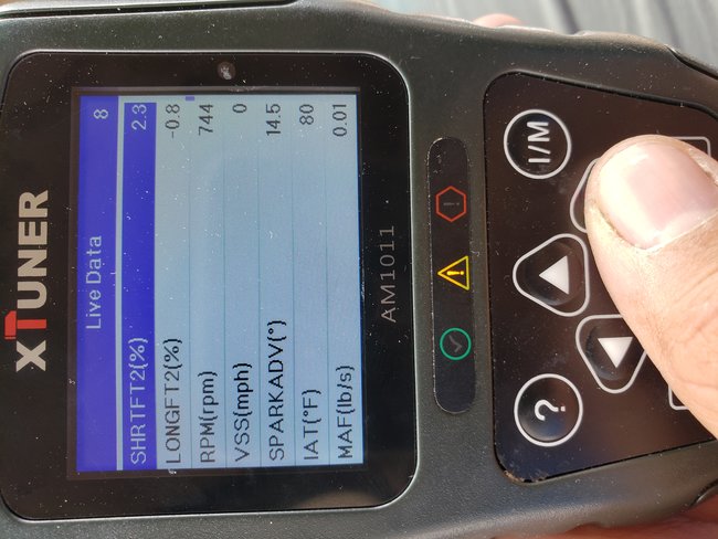

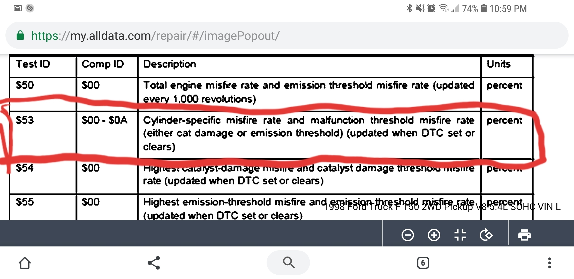

Okay, so my wife took the truck to the grocery store and around town today. It's still slightly rough but no trouble codes. JIS001, I think I posted my message at just the same time as you when you asked me for TID$53. I checked, I don't have TID$53 available, when I look at the menu Onboard Monitor Test. It does have TID$50.
Here are all the TIDs available and their corresponding data:
TID$50, TOTAL ENGINE MISFIRE RATE AND TYPE: MOD $10; Test 0; Min- ; Max A3D. STS: OK
TID $10, NOT10 FRONT SWITCH RATIO BANK2: ID 21; MOD $10; TEST 2D; Min-; MAX 30. STS: OK
TID $21, INITIAL TANK VACUUM READING (MAX LIMIT): ID 00; MOD $10; TEST EBF0; MIN EB00; MAX-; STS OK.
TID$22, LEAK CHECK VACUUM BLEEDUP: ID 00; MOD $10; TEST 16B; MIN -; MAX 500; STS OK.
TID$25, VAPOR GENERATION MAX PRESSURE RISE: ID 00; MOD $10; TEST 8000; MIN 300; MAX -; STS OK
TID$41 DATA, DELTA PRESSURE FOR UPSTREAM HOSE TEST: ID 11; MOD $10; TEST F; MIN FC80; MAX-; STS FAIL
TID$4A DATA, DELTA PRESSURE FOR LOW FLOW TEST: ID 30; MOD $10; TEST 4C5; MIN 300; MAX-; STS OK
EGR, COMMANDED EGR DUTYCYCLE FOR LOW FLOW TEST: ID 30; MOD $10; TEST 4778; MIN-; MAX 6666; STS OK
Of my I/M READINESS Codes here's what I have:
MIL- OFF
MIS- Ok
FUEL- ok
CCM- ok
CAT- INC
HCAT- N/A
EVAP- ok
Air- N/A
02S- ok
HTR- ok
EGR- ok

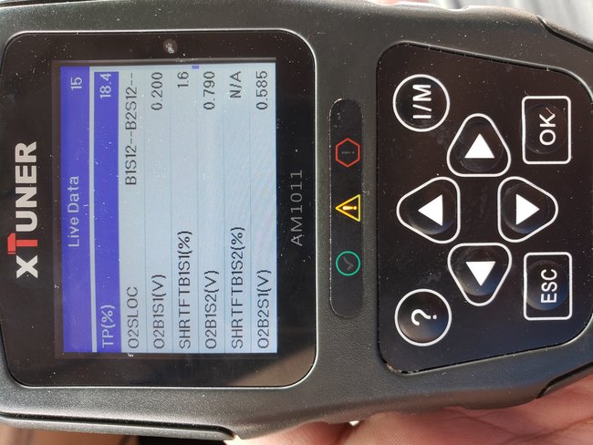

Live Data:
DTC_CNT 0
Fuel sys1 CL
Fuel sys2 --
Load_PCT(%) 13.3
ECT(degrees F) 338
SHRTFT1(%) 4.7
LONGFT1(%) 0.0
SHRTFT2(%) 2.3
LONGFT2(%) -1.6
RPM(rpm) 892
VSS(mph) 0
SPARKADV(degrees) 27.0
IAT(degrees F) 204
MAF (Ib/s) 0.00
TP(%) 18.4
O2SLOC B1S12-B2S12
O2B1S1(V) .790
SHRTFTB1S1(%) -1.6
O2B1S2(V) .015
SHRTFTB1S2(%) n/a
O2B2S1(V) .175
SHRTFTB2S1(%) 0.0
02B2S2(V) .550
SHRTFTB2S2(%) 99.2
Okay, I think that's everything I've got. Any recommendations on software to view this data on my computer? The scanner has a cord to connect to a computer, but doesn't offer any software-strange. What do you think?
Is my MAF always supposed to be 0 at idle?
Jan 11, 2021 at 2:14 AM (Merged)

No, you should have some reading. I am surprised you do do not have a mass air flow code? Inspect the pins at the connector and make sure it is plugged in and locked.

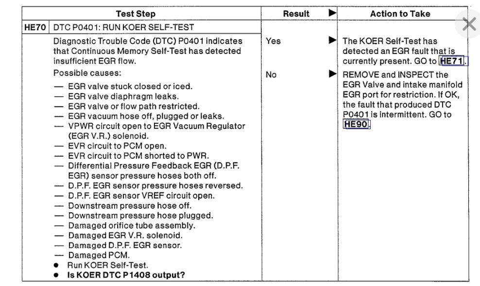

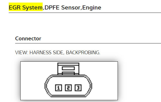

Which pin am I looking at for voltage change?
SCGRANTURISMO
  • 4,897 POSTS
Here is the DPFE Connector and the pin assignments.
Thanks,
Alex
2CarPros
WHITESHIRTSAMMY
  • 60 POSTS

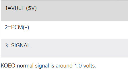

I have 1.1v on the brown/green wire with the key on engine off.
That is not something you can monitor with a voltmeter. You need to monitor it with a scan tool. A voltmeter is not fast enough.
WHITESHIRTSAMMY
  • 60 POSTS
Is there a way to remove the DPFE and the solenoid and test them individually? if i put a vacuum to the EGR, the vehicle almost stalls.
No, there is not.
You need a scan tool as I stated to monitor the voltages. It varies on catalytic converter activity as well as load factors.
WHITESHIRTSAMMY
  • 60 POSTS
Okay, let me work on it.
Sounds like a plan.
WHITESHIRTSAMMY
  • 60 POSTS

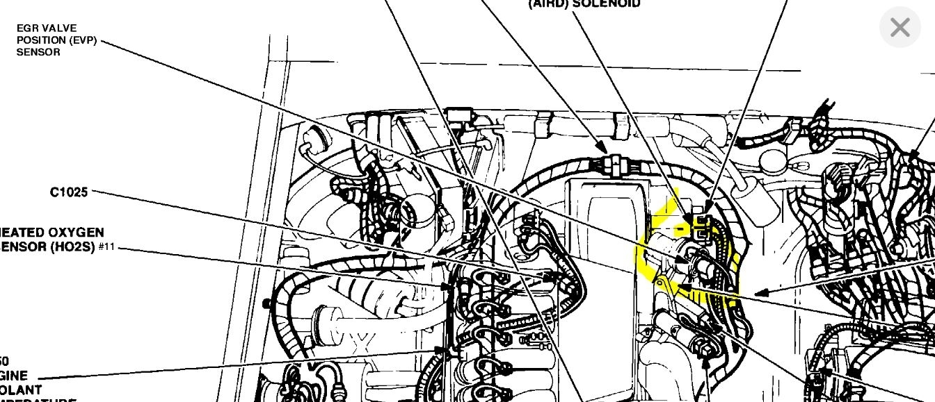

I do not have vacuum at the EGR solenoid.
You should have manifold vacuum at the solenoid. When the solenoid opens, it will send vacuum to the EGR. That is not the issue for the 401.
Check all your vacuum lines for cracks or breaks.

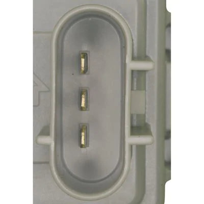

Okay, all new vacuum tubing in the truck. I cleared the code, drove the vehicle and now the code is P0402.
Jan 11, 2021 at 2:15 AM (Merged)
Did you replace the sensor?
WHITESHIRTSAMMY
  • 60 POSTS
No, same delta feedback pressure sensor as when I was getting P0401.
Replace the sensor. That was a very common failure for the 401 code.

I would get an OEM from Ford. I have had trouble with aftermarket sensors.
WHITESHIRTSAMMY
  • 60 POSTS
Okay, that fixed it.
