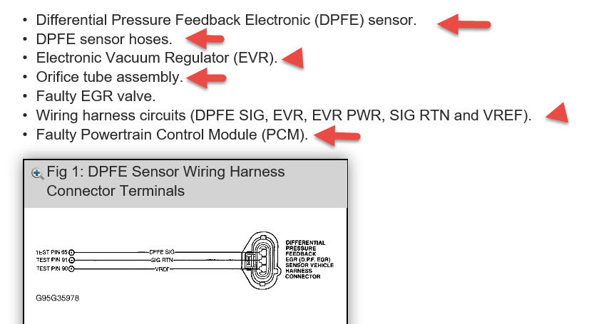

P0401 code EGR
25,000 MILES • 4.6L • V8 • 2WD • AUTOMATIC
JIMTAM
Have P0401 code EGR. I have changed the EGR valve, EGR solenoid and sensor. Still have the code.
Nov 13, 2016 at 3:24 AM
HMAC300
  • 48,601 POSTS
if you do not use a scanner to erase it it will still be there forever. check items in picture like a vacuum leak or orifice tube plugged. see picture.
