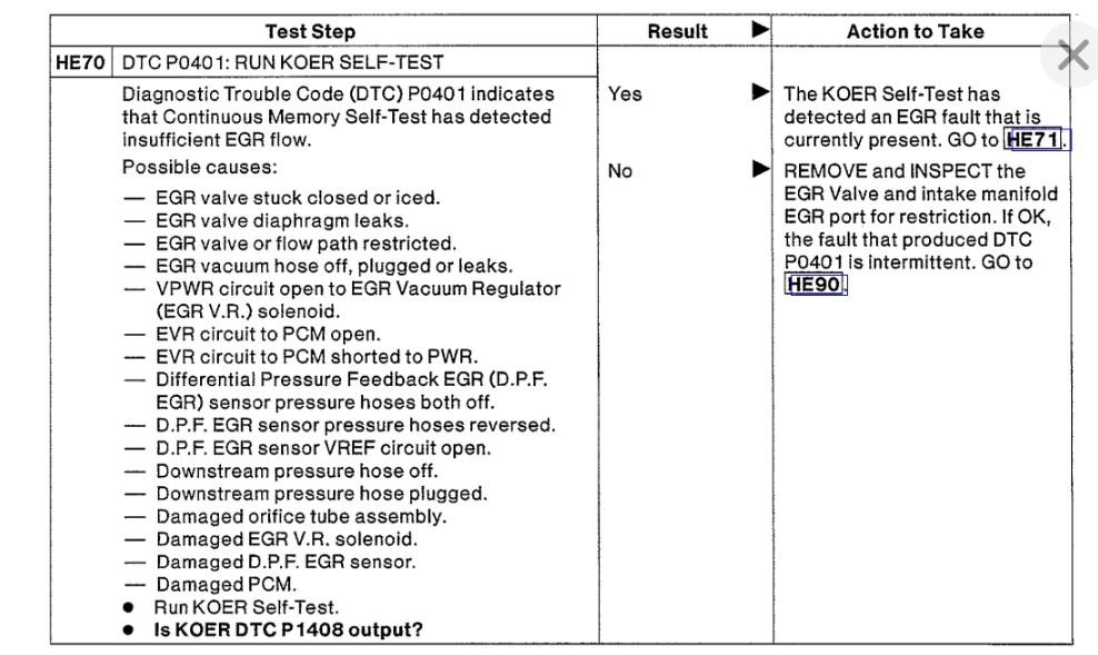

I have already replaced the egr valve and the dpfe sensor, but still can't keep the check eng light off. Code P0401 insufficientegr flow keeps coming back on, and it's getting next to impossible to get it to pass state emmissions. Truck runs great except for the damn light . Please tell me what I can do next. I have 3 months before inspection again. Thank you.

Code Definition
P0401 Exhaust Gas Recirculation Flow Insufficient Detected.

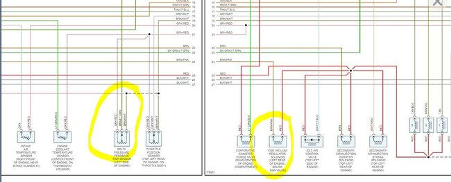

oh, wow. I cannot wait 50 key cycles. I replaced the EGR Vacuum Regular solenoid and DPFE sensor and I am still having this issue. Do you have the pin layout and voltages in/out to these sensors?

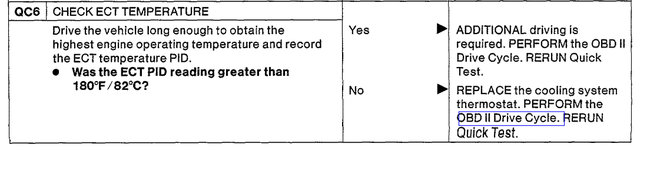

JIS001
  • 3,412 POSTS

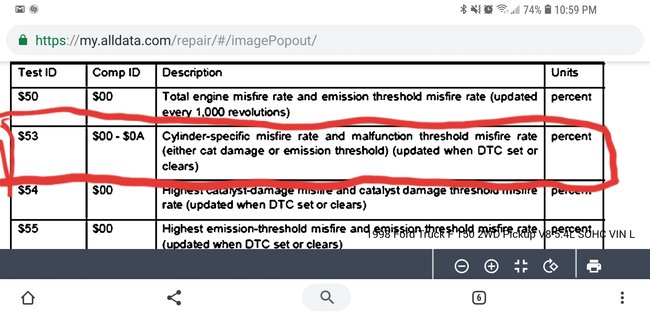

I would also look at Mode 6 data as well and look for test ID 53. See image below. If that information is available it will be a lot of help. When your in Test ID 53, take a pic of All the component ID'S and post them on here.
Before you do that, make sure you have a good battery because a week battery will cause the data to clear. If the battery is good drive the truck to make the condition you are describing appear. Do that for a couple of miles. Once you get home, let it idle and then scan it for codes and look for mode 6 on your scanner and test I'd and take pictures of all the component ids. Let us know please.

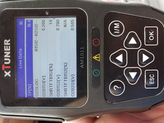

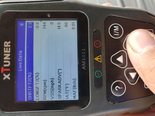

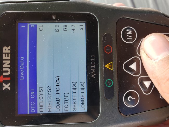

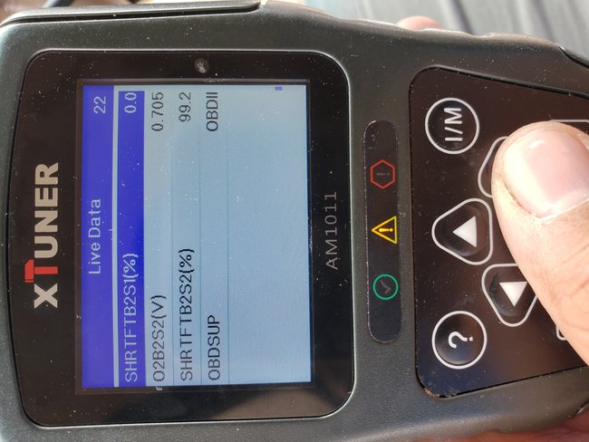

KEEGNATION
  • 14 POSTS
Hi Alex,
Okay, I think you are onto something. I took three readings, 1) one cold just for reference, 2) one warmed but idling and 3) one while the car was driving 60mph.
Okay, so these readings are at warmed and idling (2).
Shrtft1 -. 8
Longft1 4.7
Shrtft2 - 2.3
Longft2 . 8
There are 3 photos of the other data, just for reference.
Jan 11, 2021 at 2:14 AM (Merged)

KEEGNATION
  • 14 POSTS
Here's 1 of 3

I manually cleared the code, drove the vehicle, the code is back.
The DPFE and the EGR is brand new.
I unplugged the connector from the DPFE, while the vehicle was on and checked the voltages: First pin 5v, middle pin 0.082v, the last pin 5v.

KEEGNATION
  • 14 POSTS
2 of 3
The voltages are correct.
You need a advanced scan tool to monitor the signal village while the engine is running.

KEEGNATION
  • 14 POSTS
3 of 3
