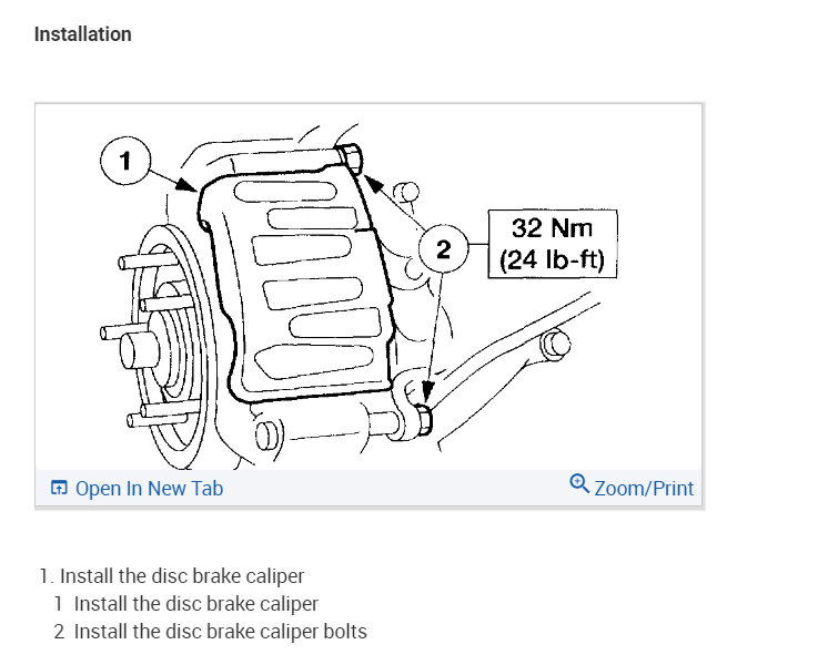

I have a 2003 Explorere, 2wd and need the torque setting for the front caliper bolts.

Yep here is the caliper bolt torque specs
24 ft pounds.
Check out the images (Below). Please let us know if you need anything else to get the problem fixed.
