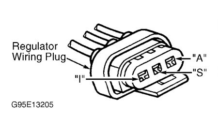

DAVE H
  • 13,384 POSTS
"S" & "I" CIRCUIT TEST Unplug regulator 3-wire harness connector. Connect jumper wire from harness "A" terminal to regulator "A" terminal. See Fig. 1 and Fig. 2 . Connect another jumper wire from regulator "F" terminal screw to generator housing. With engine idling, connect voltmeter negative lead to battery ground terminal. Connect voltmeter positive lead first to "S" terminal and then to "I" terminal of regulator harness connector. See Fig. 2 . Voltage at "S" terminal should be about 7 volts and about 14 volts at "I" terminal. If "S" terminal and "I" voltages are okay, replace voltage regulator. Repeat LOAD TEST. If "S" and "I" circuit voltages are not as specified, go to next step. If voltage is present at "S" terminal, but not 6-8 volts, replace generator. If no voltage is present at "S" terminal, disconnect one-wire connector ("S" terminal) on back of generator. Check voltage at single "S" terminal. If about 7 volts are present, repair "S" circuit wiring. If no voltage is present at single "S" terminal, replace generator. If no voltage is present at "I" terminal, repair indicator light wiring circuit. Restore wiring connections and repeat LOAD TEST. Fig. 2: Identifying Regulator Harness Connector Terminals
https://images.2carpros.com/forum/automotive_pictures/266999_plug_2.jpg

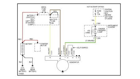

LUCKEYTANGO
2002 Ford Explorer XLT 79,000 miles.My battery light was on this morning and I drove around 5 miles and all my electrical started failing. I drove as far as I could and it finally went totally dead and unable to restart. We replaced the altenator and battery and everything "seems" fine except the battery light won't go off. No codes showed up using a scanner. I have only driven 4-5 miles at a time with no problems and I'm afraid of a repeat if I go much further.The battery was only 2 years old and was not tested but was fully replaced under warranty.Did not have the altenator tested before replacing either.Also,is there a chance I damaged anything else? (fuel pump etc...) Do you know where my fuel filter is located?Two lube shops could not find it. Great forum, Thanks.
Mar 27, 2019 at 11:34 AM (Merged)
MIKEYBDMAN
  • 623 POSTS
[quote:a326fc225f="luckeytango"]2002 Ford Explorer XLT 79,000 miles.My battery light was on this morning and I drove around 5 miles and all my electrical started failing. I drove as far as I could and it finally went totally dead and unable to restart. We replaced the altenator and battery and everything "seems" fine except the battery light won't go off. No codes showed up using a scanner. I have only driven 4-5 miles at a time with no problems and I'm afraid of a repeat if I go much further.The battery was only 2 years old and was not tested but was fully replaced under warranty.Did not have the altenator tested before replacing either.Also,is there a chance I damaged anything else? (fuel pump etc...) Do you know where my fuel filter is located?Two lube shops could not find it. Great forum, Thanks.[/quote:a326fc225f]
First off, with the battery light, I think you did everything correct. It sounds like the altenator you installed is not turning off the battery light. According to the diagram, power is supplied to the charge light from the hot bus thru the ignition switch. It gets its ground thru the Altenator. When the altenator produces power, the internal logic removes the ground for the charge light indicating the system is charging normally. I would have the altenator and battery tested at your local parts store, and if they check normal, replace the altenaor with your warrenty.
On a side note, I woudl check all of the connections including the grounds for your battery, and engine ground for corrosion and tightness. Some times when things are not grounded properly, weird symptoms do occur.

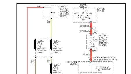

35577
Electrical problem
2000 Ford Explorer 6 cyl Two Wheel Drive Automatic
has new alt. new battery why is light still on
Dec 21, 2019 at 5:04 AM (Merged)
  • 75,992 POSTS
Check fuse no.15 7.5amp and alternator system fuse 30amp. and double check all connections-also see below
https://images.2carpros.com/forum/automotive_pictures/12900_alty_17.jpg

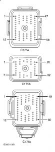

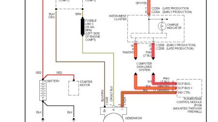

SCOTTY326
I replaced battery and belt and alternater [2] and checked wire from alt. and all fuses light stays on. Alt. is putting out 14.5 volts. How do I get light out?
  • 75,992 POSTS
Could be a problem with the powertrain control module field generation circuitry-see below
https://images.2carpros.com/forum/automotive_pictures/12900_alty1_2.jpg
https://images.2carpros.com/forum/automotive_pictures/12900_alty2_6.jpg
