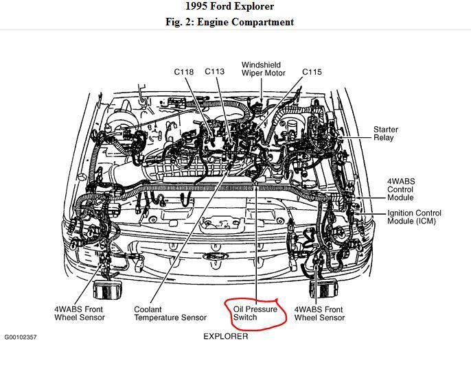

Where is the oil sending unit located on a 1995 ford explorer xlt 4.0 liter v6

It is located next to the power steering pump on the block, see pic for general view.
