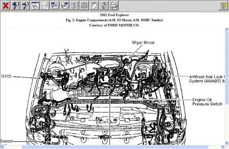

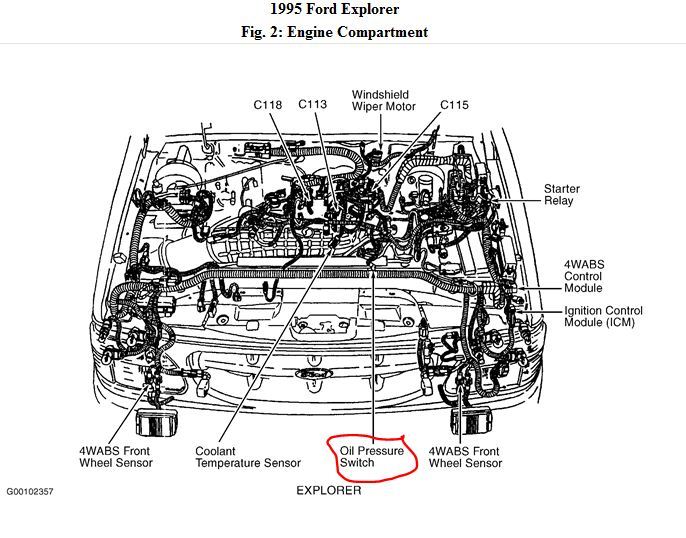

Oil gauge is acting funny, it will be fine and then sometimes it just goes to nothing but the motor sounds and runs fine.
Jan 25, 2010 at 8:13 AM
BLUELIGHTNIN6
  • 16,542 POSTS
The oil pressure switch at left side of engine block. Check out the diagrams (Below). Please let us know if you need anything else to get the problem fixed.
Jan 25, 2010 at 8:14 AM

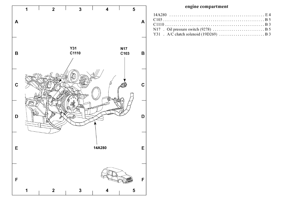

I am looking for a detail diagram as to where I can locate the oil pressure switch, can you help me with this. it is a 6 cylinder motor. I bought the part because I am get erratic readings on the gauge now I have no idea as to where it goes, is it next to the oil filter and if so, where?

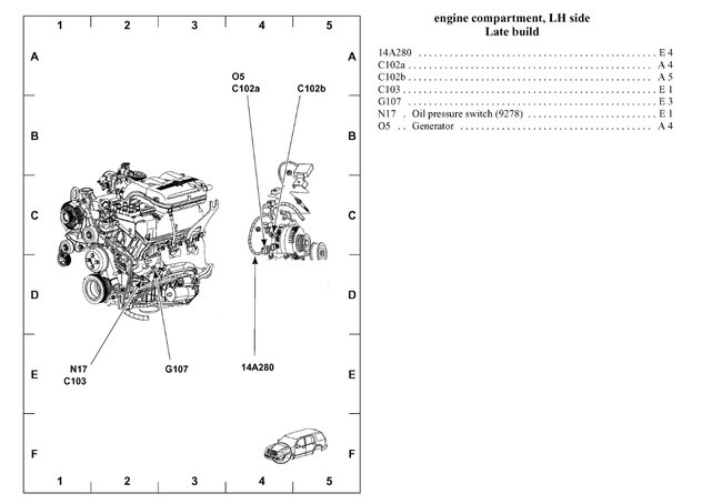

is that a 4.0?
Mar 7, 2019 at 7:23 AM (Merged)
LINDA_COLE03
I do believe it is a 4.0 engine
FIXITMR
  • 9,989 POSTS
ok all i can find right now is this. it's right by/behind power steering pump. hope it helps

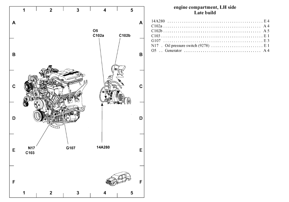

FIXITMR
  • 9,989 POSTS
found another.

DOCFIXIT
  • 18,828 POSTS
Next to power steering pump in block

if you see blank image(thumb)click anyway it should pop. my internet glitched on me.

JDL
  • 16,098 POSTS
It should be next to the power steering pump.

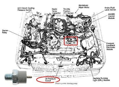

  • 75,988 POSTS
The engine oil pressure switch is located on the engine next to the power steering pump-see below

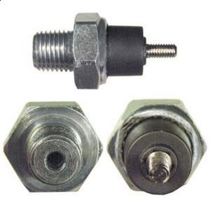

LOVESCARS
  • 359 POSTS
usually on the block semi close to where the oil filter is located it will look partially like a spark plug with a wire on top. If may also be leaking motor oil if no good.

[quote:2502234ef1="Jacobandnickolas"]It should be near the oil filter. If you can't find it, let me know and I'll try to find a picture.
Joe[/quote:2502234ef1]
ok we found it and we bought a new one but they sold us the wrong one. we have no clue exactly what one we need...

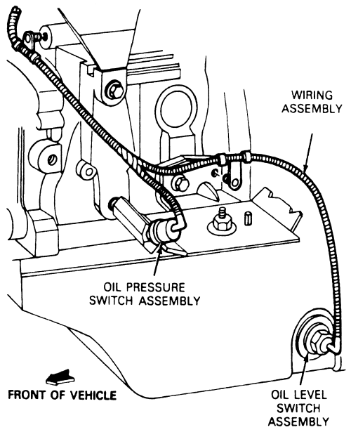

Where is the Oil Pressure Sensor Sending Unit located on 1996 Ford Explorer?
  • 110,251 POSTS
it's under the hood, lower engine area, above oil filter, mounted in lower driver side of engine block. Here is a picture of it. THe picture is for a car that has a gauge. If you only have a light, it looks very similar, but has some minor differences. Let me know if this helps.
