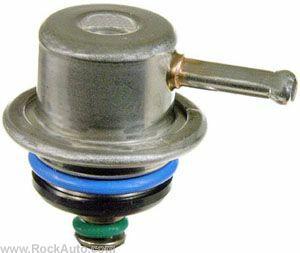

You are losing fuel pressure -check the injectors and fuel pressure regulator if its leaking
The fuel pressure should be key on engine off 30-65 psi
Its not the same thing
https://www.2carpros.com/forum/automotive_pictures/12900_fpd_2.gif
The fuel rail pulse damper located on the fuel rail reduces fuel system noise caused by the pulsing of the fuel injectors. The vacuum port located on the damper is connected to manifold vacuum to avoid fuel spillage in the event the pulse damper diaphragm were to rupture. (The pulse damper should not be confused with a fuel pressure regulator, it does not regulate fuel rail pressure.)
https://www.2carpros.com/forum/automotive_pictures/12900_fpr_4.gif
The fuel pressure regulator is attached to the fuel rail downstream of the fuel injectors. It regulates fuel pressure supplied to the fuel injectors. The regulator is a diaphragm-operated relief valve. One side of the diaphragm senses fuel pressure and the other side is connected to the intake manifold vacuum. Fuel pressure is established by a spring preload applied to the diaphragm. Balancing one side of the diaphragm with manifold vacuum maintains a constant fuel pressure drop across the fuel injectors. Fuel pressure is high when engine vacuum is low. Excess fuel is bypassed through the fuel pressure regulator and returned through the fuel return line to the fuel tank.

Where exactly is the fuel pressure regulator on that engine?
I assumed that I needed to remove intake manifold, but front stud broke. I'll finish that problem tomorrow with more daylight.
Thanks for help.

It will look like this on the fuel rail

Could the fuel pressure regulator be part of the fuel pump assembly inside gas tank?

https://www.2carpros.com/forum/automotive_pictures/12900_fuel_pressure_regulator_1.gif
