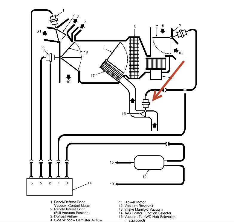

I had my ac work on. I did not have ac at all now I do but now I do not have heat all the parts are new and I still do not have heat in my car what can that be like I said all parts are new so I do not have alot of money to pay someone again to work on it I paid over 650.00 to get it working now that it works I have no heater it blows cold air what can that be I had it look at the ford dealer and they told me to pay 300.00 to get it working if I can do it myself I would if someone can help that would help me out alot. Thank you
Thursday, June 11th, 2020 AT 6:50 PM (Merged)
HMAC300
  • 48,601 POSTS
Check to see if your heater control valve is getting vacuum. It's pointed out in pic. If not check for a vacuum leak starting at engine. If it gets vacuum with heat on then the valve is bad and needs replacing.
