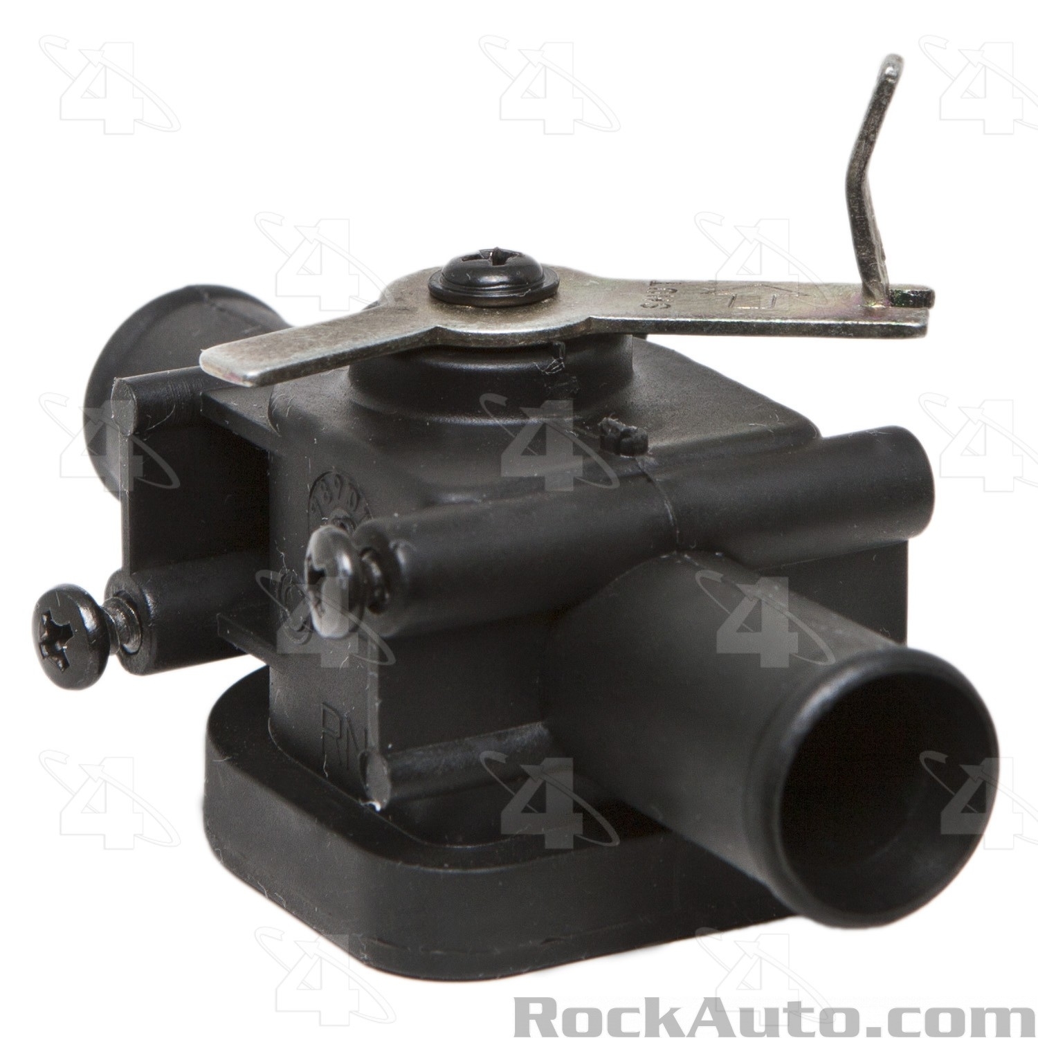

There is your heater valve. I posted a picture of it.

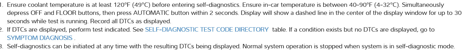

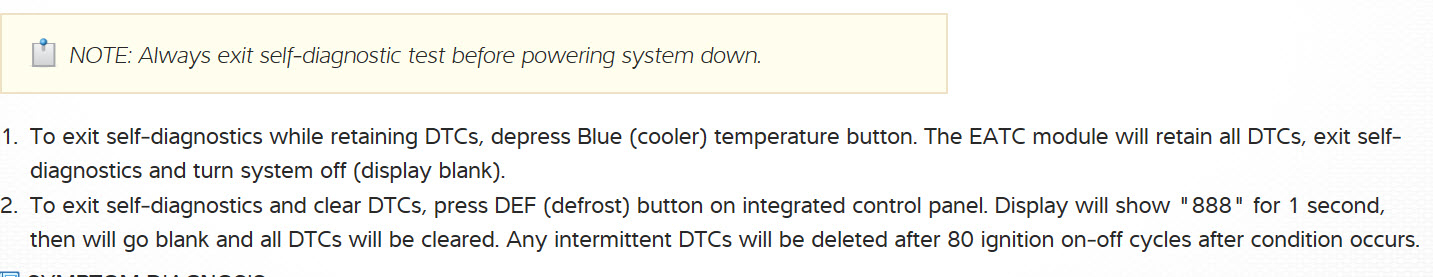

Guys, it automatic temperature it may be a sensor bad. See pictures on how to enter and exit self test for automatic temperature control then get back with codes if any. Also, check for vacuum leaks at vacuum motors.

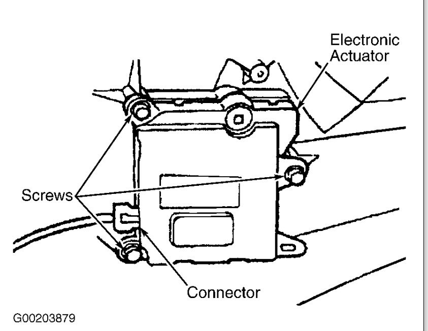

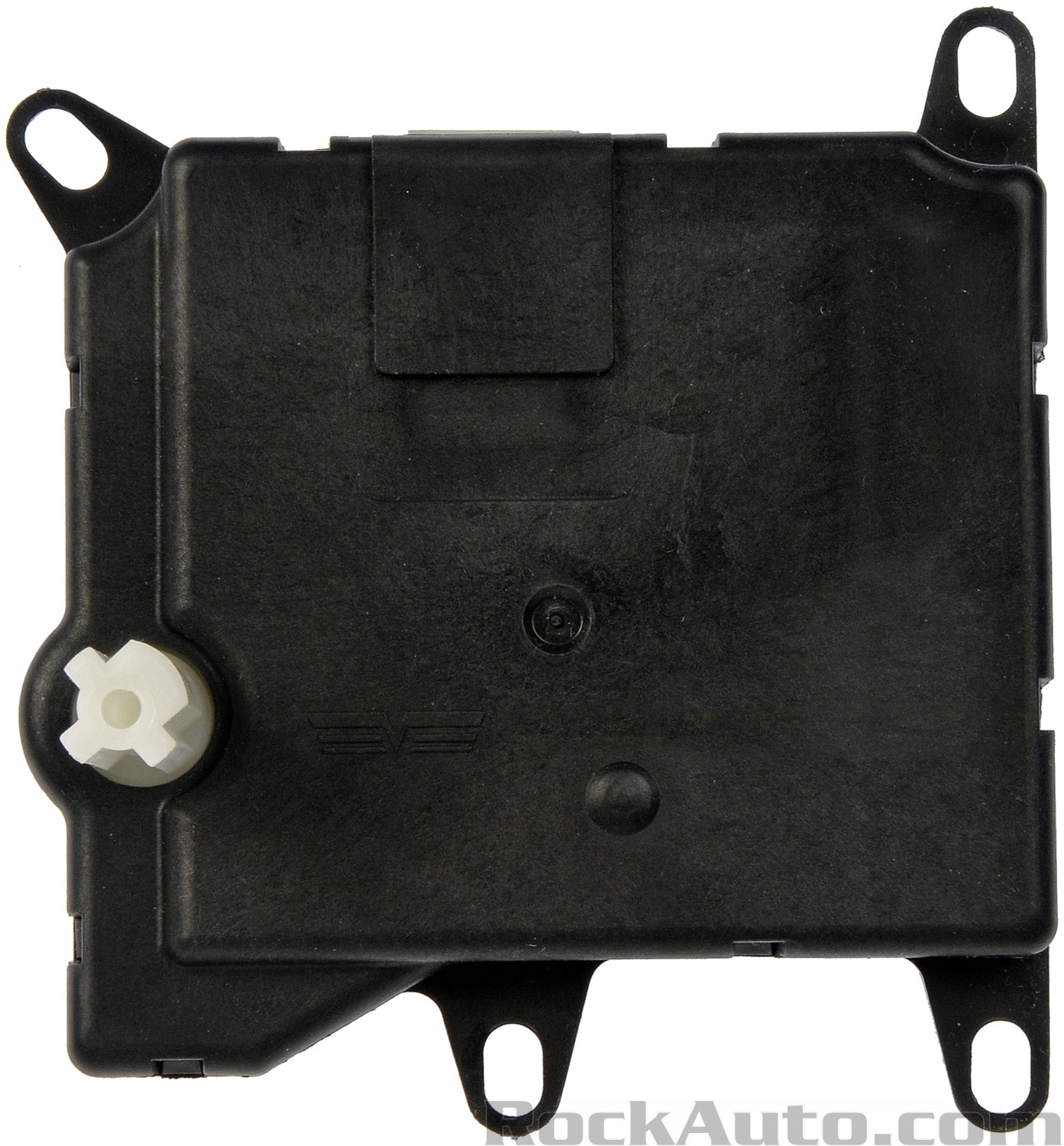

I posted a picture if the blend door actuator. It still has coolant going in and out of the heater core blend door actuator etc. Those are basic checks ether way it is automatic or manual controls.

You did the wrong actuator, the blend door moves air across heater and or a/c have a pro look at this.
