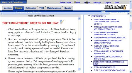

First, you don't have a heater control valve. In the vehicle is a blend door that determines if you get heat or AC. It is located near the heater core under the dash. This guide can help
and this video
https://youtu.be/SNRb6pSwYuU
However, I need you to check something. With the engine running, hot, and the heater on high, feel both heater core hoses. Both should be hot.
Let me know what you find.

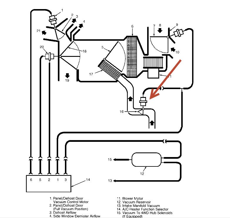

Is the fan working? Have you checked for vacuum leaks? THe vent doors that change the system from heat to AC are actuated by vacuum. Check for hoses that are disconnected or damaged under the dash. WIth the engine running, you may hear a hissing sound.

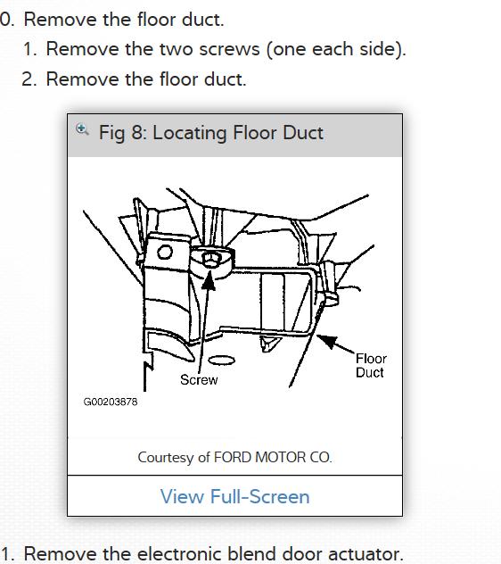

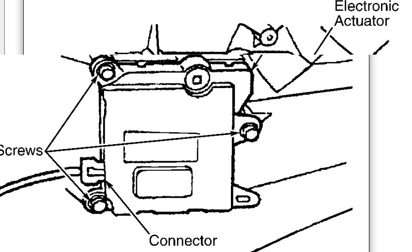

It is a blend door which is under the heater towards passenger side a few ducts have to be removed to get to it but pull your hvac fuse with key on first for 60 seconds then reinstall see if that cures it sometimes they reset. If you replace it and have rear air that duct has to be pulled back as well as other see pics

Could be a problem with vacuum and actuator to the air/blend/mode doors-

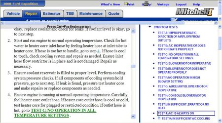

If there's a problem with the heater core it will affect the back one-
Check the radiator makes sure its filled with coolant-also see below its really hard to estimate the costs for such repairs it varies with locations-Good Luck
