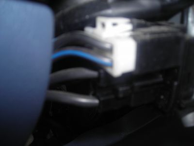

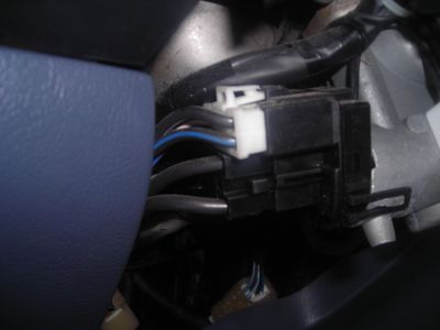

I got the steering colum off but i just do not know what wire it is? ill send you a picture of what i got off and the wires just to tell my which wire i need to test.
https://www.2carpros.com/forum/automotive_pictures/164730_DSCN0745_1.jpg
https://www.2carpros.com/forum/automotive_pictures/164730_DSCN0746_1.jpg
Monday, March 10th, 2008 AT 10:25 AM
MASTERTECHTIM
  • 4,749 POSTS
If there is a fat blue wire in there check that for 12v when the key is in run position. Im at work right now and is hard to get to computer, check all the wires at the switch(good picture) tell me what color wire has power all the time and which wires have power when the key is on. Ill be back soon.

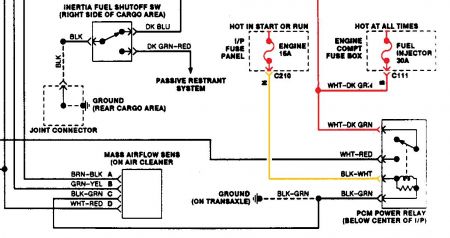

https://www.2carpros.com/forum/automotive_pictures/99387_93_esc_1.jpg

Bmr what feed that 15a ignition fuse, he said no power ther with key on, all I found was a blue wire from ignition switch feeding the fuse power but I dont see a blue wire in his picture from the ignition switch

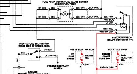

https://www.2carpros.com/forum/automotive_pictures/99387_93es_1.jpg
Monday, March 10th, 2008 AT 6:47 PM
BMRFIXIT
  • 19,053 POSTS
At the PCM relay we have
WHT-DK GRN > hot at all time
WHT -RED > ground PCM
BLK-WHT > hot with key on or and start
BLK-GRN > GROUND
Monday, March 10th, 2008 AT 6:55 PM

Check these wires bmr has illustrated. What are you missing? Tell me. Tell me. Tell me.
