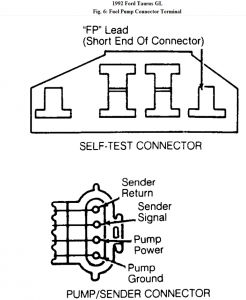

MERLIN2021
  • 17,250 POSTS
Have you tried the fuel pump test connector? Ground the fuel pump test connector and see if the pump runs, this tests the pump circuit... let me now, New relay may be the answer, or a bad Inertia cut off switch. I thought I read that you heard the pump run?
https://images.2carpros.com/forum/automotive_pictures/62217_FP_Connector_OBD_I_EEC_IV_2.jpg

PLEASUREMANN
  • 21 POSTS
Wow, I wouldn't know where that thing is. Is it nearby the relays? Also, what's the procedure to ground it?
Thank you so much for your help. And by the way, I jumped the inertia switch a few weeks ago, to no avail. I've just got both wires that went into it tied to each other and covered in electrical tape.

MERLIN2021
  • 17,250 POSTS
Test lead is on one of the inner fenders usually the left. Use a piece of wire and ground it to metal, turn the key on, and if the pump is OK it will run. Use a test light at the pump to see if you have power. Re install the inertia switch. I only use direct fit pumps, no splicing..
