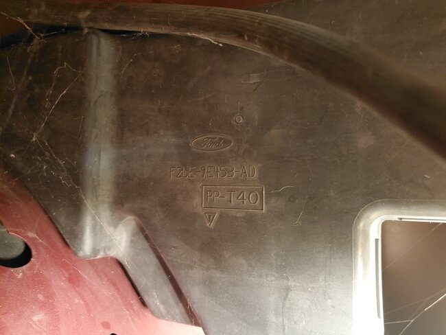

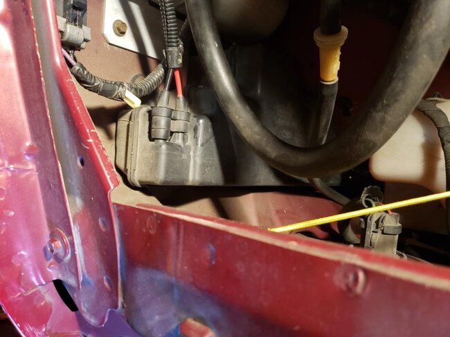

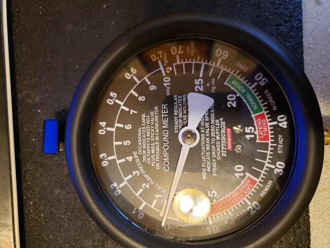

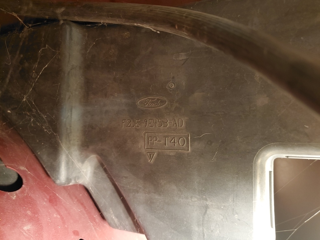

Hi Joe, yes, we must live near each other, I live near Wheeling Wv. Anyway, here's what I did today: I performed the test of taking the cap off the vacuum solenoid and started the engine put my finger over the tube that's under it. The engine almost stalled so I performed the test again and watched the EGR valve and it was going up when finger covering the tube and down when finger was removed from the tube as it should have. There is a vacuum reservoir located on the passenger inside fender (pic attached). I hooked up the vacuum gauge to the red vacuum line (pic attached) started the van and the needle went into the green section of the gauge. I then disconnected the vacuum gauge and hooked it up to the black vacuum line and the same results needle went into the green section of the gauge. At this point I'm thinking all the vacuum lines are good and it's an electrical problem. Is there any chance that the ECM/PCM computer might be bad or even the clock spring?
