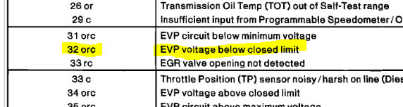

I have an airbag light that's flashing three times then pauses then flashes two times pause then repeats again and again. Horn and cruise both are working. I know this is some kind of code but don't know what.
Oct 26, 2022 at 1:16 AM
  • 110,251 POSTS

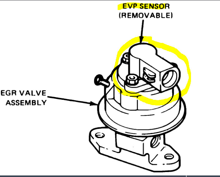

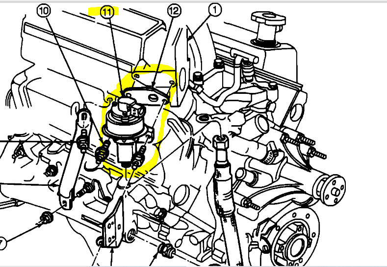

Based on your description, it sounds like a code 32. That code is related to the EVP sensor. The EVP sensor monitors the position of the EGR valve. In this case, it indicates the voltage is less than the fully closed position. So, there is a chance that the connector is loose, corroded, the wiring to it is damaged, or the sensor itself is bad. See pic 1 below for a description

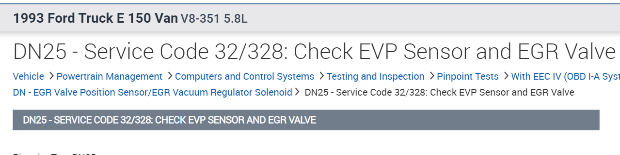

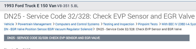

The EVP sensor is mounted at the top of the EGR valve. The EGR valve mounts on the passenger side of the engine's intake manifold. See pics 2 and 3.
Inspect the connector first and wiring first.
Let me know what you find. Also, let me know if there have been any drivability issues.

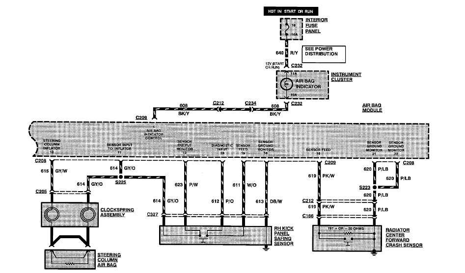

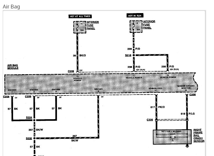

The idea that the airbag light is flashing indicates an issue within the SRS circuit. I attached the wiring schematics for the circuit below. I'm adding them in the event you need them.

JAMES JONES SR
  • 25 POSTS

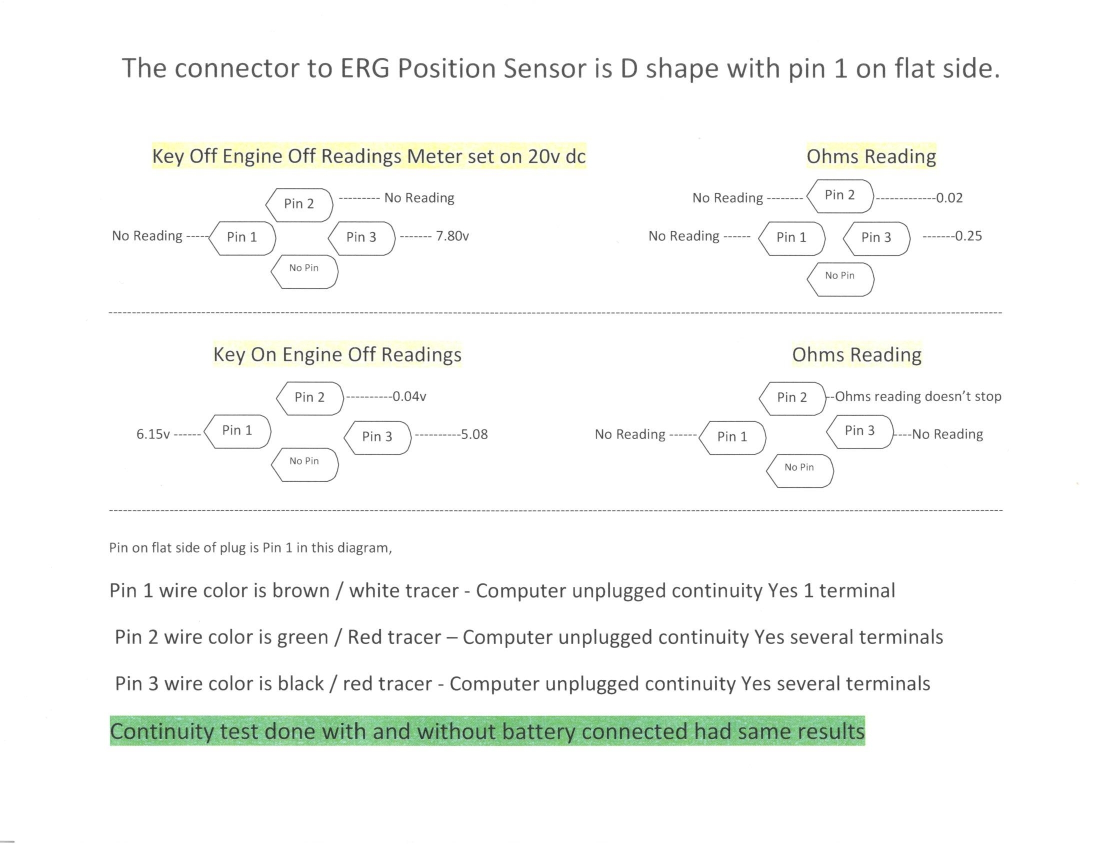

Joe, I attached a sheet to show you the results of the test I performed. If you need more info let me know.
Nov 5, 2022 at 4:01 AM
  • 110,251 POSTS
I went over what you found (by the way, nicely put together) and your voltages are good. When the EGR is fully closed, the voltage to the EVP should be between .24 and .67v and you are within that.
I have a feeling it is electrical, but have you removed and inspected the EGR to make sure it moves and isn't carboned shut? That would cause the code.

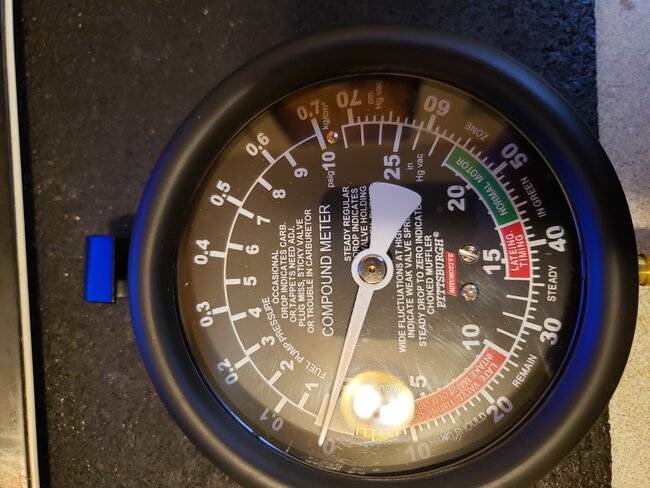

Hi Joe, here's what I tried today. I removed the EGR valve vacuum line and used a vacuum pump to add vacuum to the EGR valve. I used a mechanics mirror to view the valve under vacuum. The valve went up when the vacuum was applied and down when I released the vacuum. I then added vacuum to the vacuum line that goes the the EGR valve and the gauge would not show any vacuum at all. I then replaced the vacuum line onto the EGR valve found the vacuum line at the Vacuum regulator or modulator (both refer to the same valve) and applied vacuum to the green vacuum line connected to the EGR valve. The EGR valve again worked as is should have. I am wondering if the modulator/regulator valve could be bad. It has green and a black vacuum line connected to it as well as an electrical connection. I can't get the connector off to check for voltage or test the vacuum regulator/modulator itself. I will try again later and get back to you. If I can get the electrical connector off what kind of reading should I be looking for and should the battery be isolated or connected when testing? I am including a URL from ebay to show you what the part looks like. Just highlight the whole HTPP: URL only then right click then select open link in a new tab.
https://www.ebay.com/itm/154122841302?hash=item23e26fecd6:g:l-8AAOSwq3heqA4E&amdata=enc%3AAQAHAAAA8GJMZcHpN2HuCZTgRYA4RRSN9QOMoJLM7CNEj39MYqTivVzuUj%2BcPqPlPtYojSjS5KzgZASQeVNZrleFBWHQHaQZhnlIFzDHfCJ3%2B5IjW3mJZojy%2BhwNVufOQL0r%2Fjm3qn7gmGtUltmT9xrvp%2BHGu0nYCnESobtwYXZpVBWAnWacQwPkJs3HFNg%2B166aO7zdtEs283iSx1swcw3vxUwn1pyVNdwLkMGJh7f%2FCSWLqG7%2BzmlQC38Z%2BLshDET4rWmONgLAf4MB%2B%2FN3LjQ0TjzBmeNsM0RhFQNzXqZJpf8SrgrYlkPXFwZcQmxAvHJwVSYCKw%3D%3D%7Ctkp%3ABFBM3uam5Ilh
Nov 6, 2022 at 2:53 AM
  • 110,251 POSTS
Which port wouldn't hold a vacuum? It should at all of them.

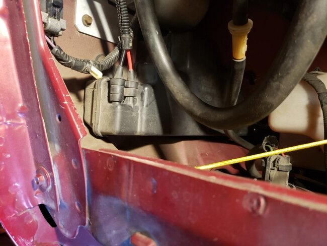

Neither port holds vacuum with a cheap harbor freight vacuum pump. Here's what I did today. I removed the solenoid from the vehicle, the electrical connection showed 9.5 volts with the key on engine off. Doing a bench test on the valve I removed the top cap added power from a 12v battery and the pin on top became magnetic when power was applied and non magnetic when power was disconnected no clicking heard. I also used a ohms meter to test the electrical arms where the plug connects to from under the cap. The ohm meter shows various ohm readings then goes to zero ohms. This component is cheap on rock auto so I ordered one. My concern is the electrical connection is only showing 9.5 volts when I think it should be 12 volts. I'm going to try some electrical contact cleaner later today or tomorrow to see if there is corrosion involved. Also using a A/C vacuum pump with power applied the vacuum tube connected to the bottom port the top port has vacuum. Reverse the vacuum hose and the tube collapses from vacuum with no vacuum sucking from the bottom port. Wit no power connected vacuum from the A/C pump collapses both top and bottom tubes when vacuum applied. All vacuum test were conducted with only one plastic vacuum tube connected. Sorry about the length but I wanted to convey everything I tried so far.
Nov 7, 2022 at 5:12 AM
  • 110,251 POSTS
Thank you for the update. If I understand, using the AC vacuum pump, the unit holds a vacuum. Is that correct?
As far as the voltage is concerned, 9.5v should not cause an issue. that is enough to actuate the circuit.

Hi Joe, sorry it took so long to get back to you, but I wanted to wait until I got the new one to compare some tests. The new one starts at 32.4 ohms and rapidly goes to zero with or without 12v power attached the old one starts at 20.3 and goes to zero. I installed the new one and it made no difference to the air bag light flashing and in fact I now have an engine light on.

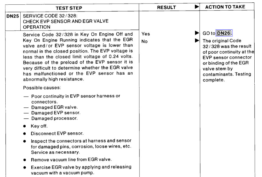

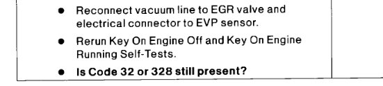

Code 32 is related to the EGR/Evap. Do me a favor. Take a look at the pics below, diagnostics, and let me know if you have done these tests and the results so I know if I need to continue with the different steps.
Nov 16, 2022 at 12:22 PM
JAMES JONES SR
  • 25 POSTS
Hi Joe, all electrical connections from the EGR position sensor and the solenoid valve to the ECM/PCM checked out for continuity. The EGR performs as supposed to when vacuum applied. What I haven't been able to do yet is to make sure the ERG valve is seating completely. I haven't figured out what I can slip into one of the openings that's thin enough to ensure it seating all the way. When I figure something out I'll send you another reply. Oh and if the EGR needs to be replaced it's going to the shop for that.
