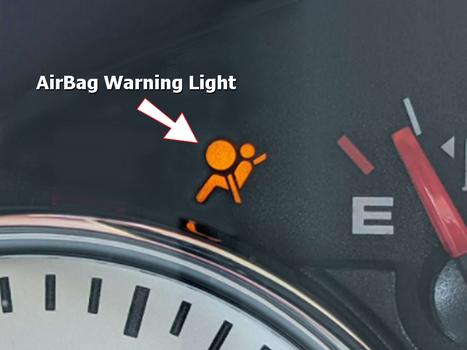

The Airbag Safety Warning Light is on because the self check portion of the airbag operating program has detected a problem and the system is now shut down including the front and side airbags. This light is located inside the instrument cluster to help alert the driver so repairs can be made to re-enable the systems operation. When the ignition system is initially switched on, this warning light will illuminate informing you the system is ready to be activated, once the car has started the light should go out letting you know the system is working correctly.
