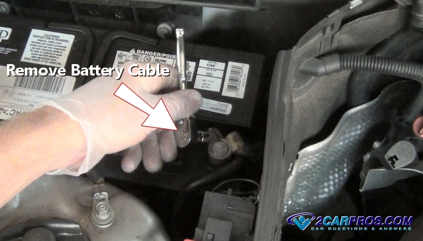

1. Remove the Negative Battery Cable: You must start the air bad clock spring removal by disconnecting the negative side of the battery. This will help prevent electrical short circuits while the job is being done. After the battery has been disconnected wait 5 minutes to make sure the airbag safety system has powered down.
remove negative battery cable

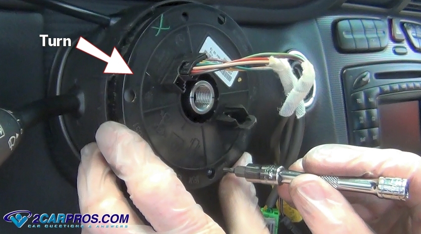

Locate the clock spring mounting screws which will be accessed through a series of small holes. The clock spring outer plate may need to be rotated slightly to access the screws. These screws are a number 15 Torx head.
Using a Torx head screwdriver or socket to remove the mounting screws by turning them counterclockwise. Use caution as not to drop the crews down inside of the steering column.
remove steering wheel clock spring mounting bolts
The top plate may need to be moved slightly in either direction to access all of the mounting screws.
turn steering wheel clock spring

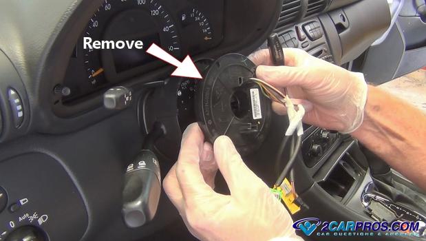

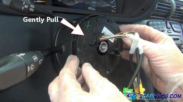

Once all mounting bolts have been removed gently grasp the clock spring and pull it from the column shaft. Some designs have a lower wiring harness that will need to be disconnected near the bottom of the column before removal. This particular unit just plugs into a lower connector.
gently pull steering wheel top plate

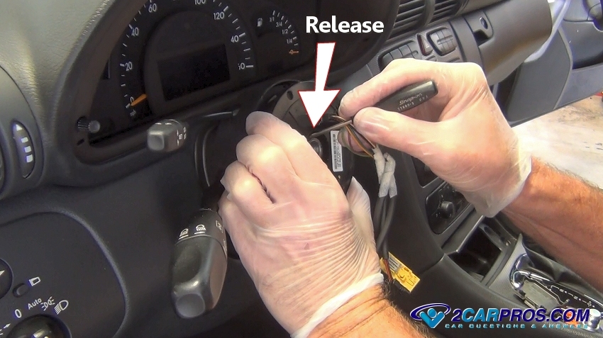

Using a small pick or screwdriver to release the plastic retainer clips while pulling the unit outward. This is required on some models.
release retainer steering wheel clock spring
Gently work the clock spring back and forth and outward from the steering column shaft and gently remove.

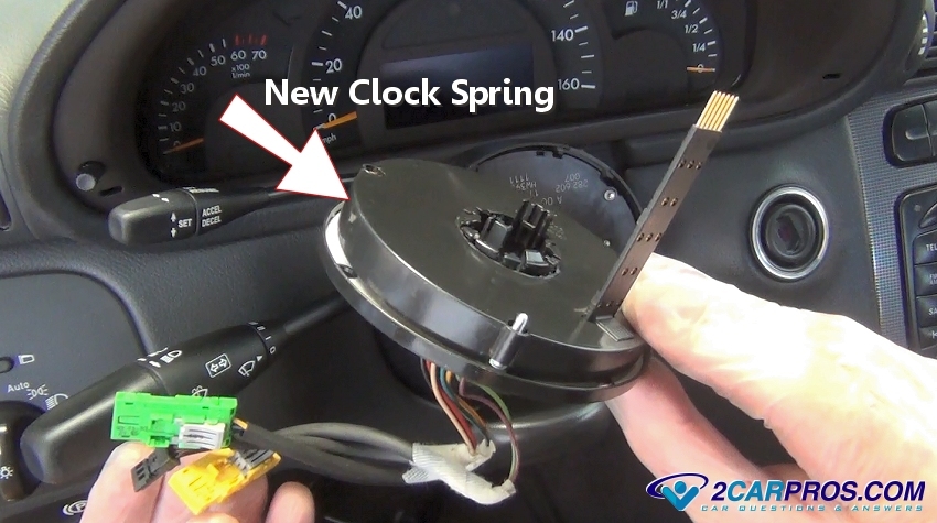

5. Install the New Air Bag Clock Spring: Here is the new steering wheel clock spring assembly that is ready to be installed.

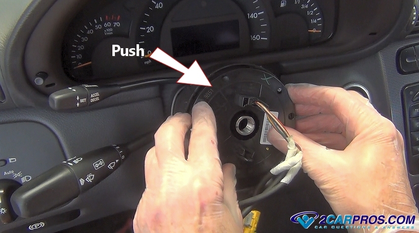

Continue by gently pushing the unit into its mounting plate and into the electrical connector below.
push steering wheel clock spring

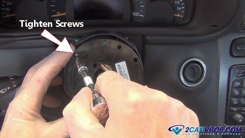

While inserting the mounting screws gently hand thread them to avoid cross threading. Install all of the screws before tightening them completely.
thread steering wheel clock spring screws
In a cross pattern evenly tighten the mounting screws but do not over tighten because they are in plastic and can strip out.
tighten steering wheel clock spring mounting screws
