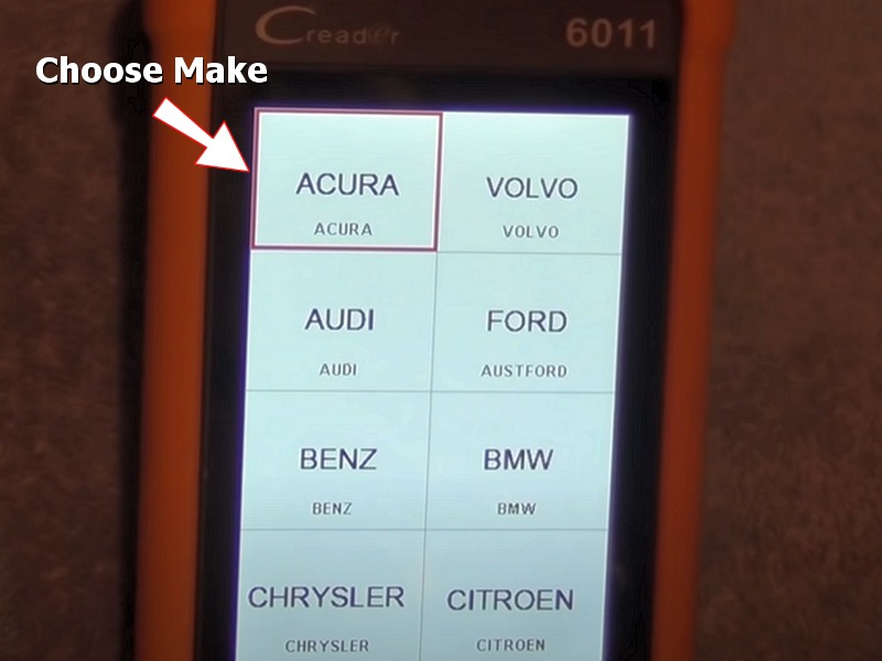

3. Select the manufacture type and prompt the scanner to begin the scan. The code reader (scanner) will then access the airbag control module to retrieve the fault codes.
air bag scan choose make
