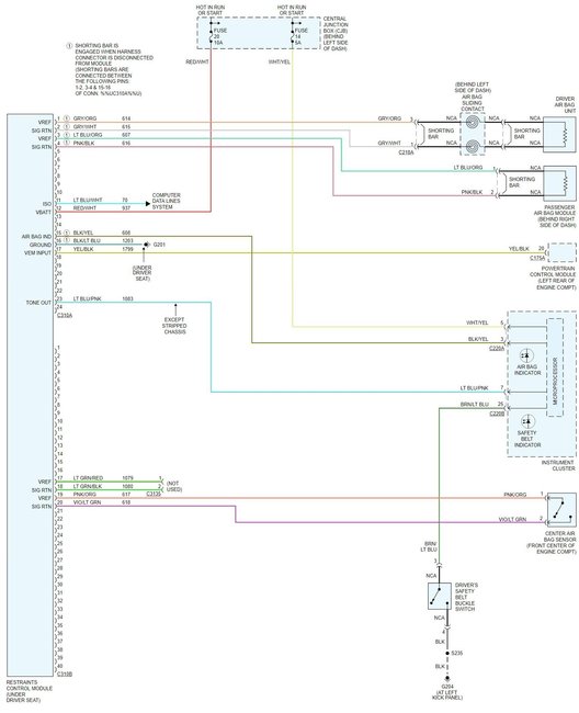

VANMAN3
  • 12 POSTS
B1883
B1892
B1933
B1932
B1869
B2792
B1342
B1226
These are codes left after fuel sensor replacement.
Jul 28, 2020 at 10:32 AM (Merged)
STEVE W.
  • 15,202 POSTS
Well that's an impressive list. Has this van been in an accident that set off the air bags? Pretty much all of those codes are air bag and seat belt pre-tensioner codes. However code B1342 may hold the answer to those as it comes up as a faulty Restraint Control Module and if it is faulty it could set those codes because it doesn't see the inputs from the various systems connected to it.
The Restraint Module is mounted under the drivers seat. They can get wet and crud can get into the housing rather easily. Replacing them isn't difficult. You disconnect the battery, wait about 10 minutes and then you can unplug the module. Plug in the replacement and re-connect the battery.

STEVE W.
  • 15,202 POSTS
That would explain some of it as an impact may have triggered some of the parts. However there is no impact detected code. The brake light is likely that level sensor as it turns that light on to warn you of low fluid level, they have always been touchy simply by the design they used.
As for the others they could all be caused by a bad RCM under the seat. Especially as you have two codes showing for items your van doesn't have. I would check that both of the fuses (14 and 20) are good and then check the ground for the module, it's under the seat near the module. If those are OK you would next need a dealer level scan tool that can talk to the RCM and let you unplug the air bags and test those circuits.
These are the definitions of the codes.
B1883 - Passenger seat belt pre-tensioner shorted to ground
B1892 - Air Bag Warning Indicator Lamp Circuit Short To Ground
B1933 - Air Bag Passenger Squib Circuit Open Fault
B1932 - Air Bag Driver Squib Circuit Open Fault
B1869 - Air Bag Warning Indicator Lamp Circuit open
B2792 - Short Circuit Between Tripping Loops
B1342 - Faulty Restraint Control Module
and
B1226 - Brake Warning Switch Fluid Level Shorted
