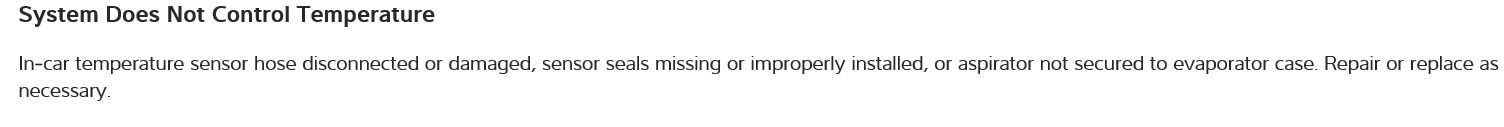

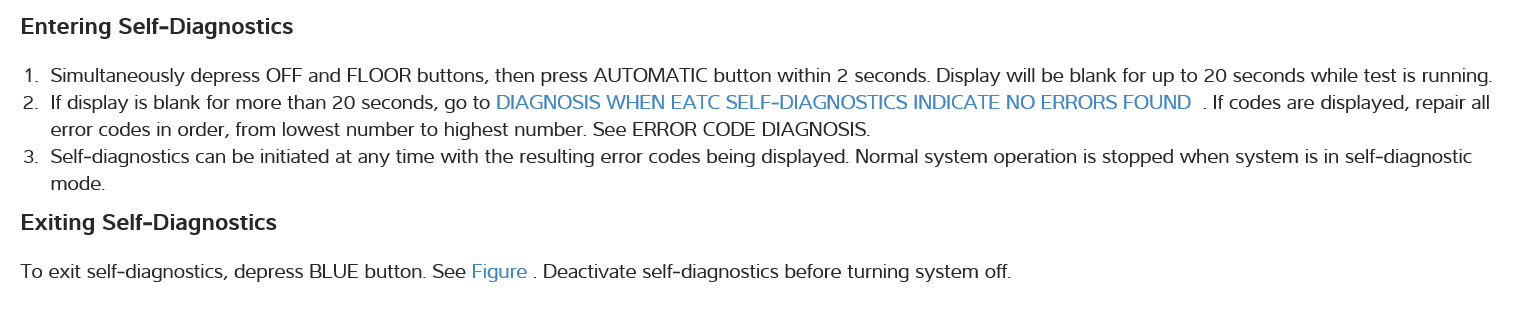

You have to do the self diagnostics on this see the picture for details and if you get a code get back to us. If code is 888 then that means nothing is wrong with system. I have included a possible problem for yours though. You have to have key on to do self diagnostics. It will have codes 1-5

I followed instructions. Within 20 seconds the "888" came up. It sounded like it was testing the doors.

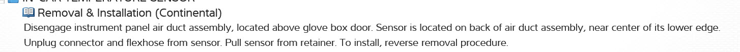

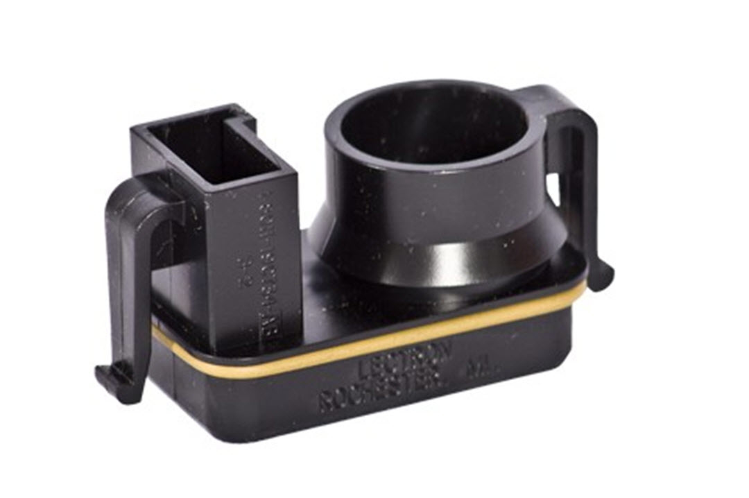

It tests most of the controls so there is nothing wrong with that, check sensor that I also had there. Picture shows instructions on how to remove it but you will have to do the same thing to check it. It will look like what is in picture. If that does not take care of it then you will have to have a professional look at it as it may be something else.
