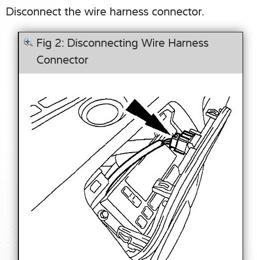

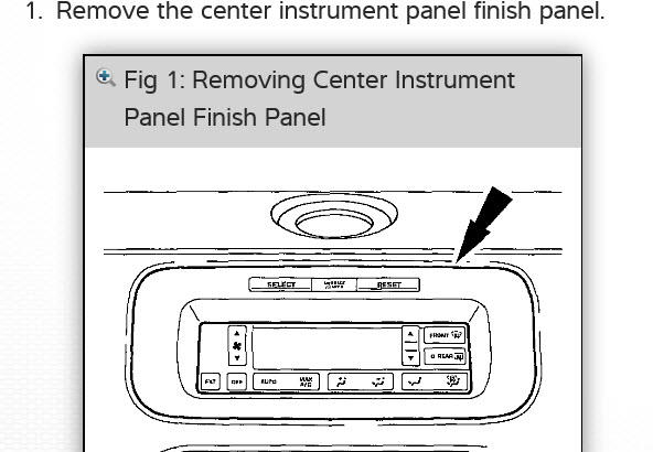

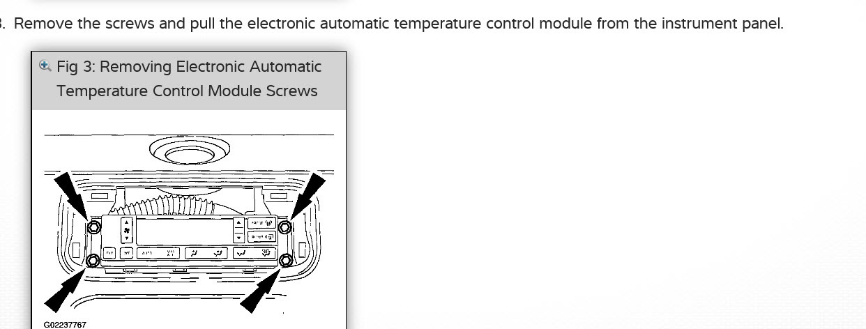

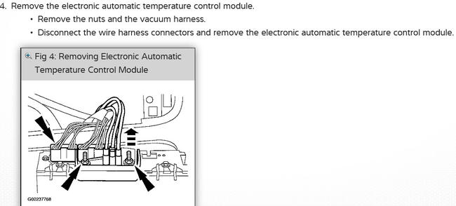

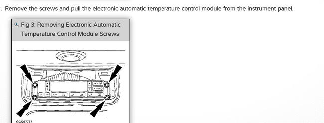

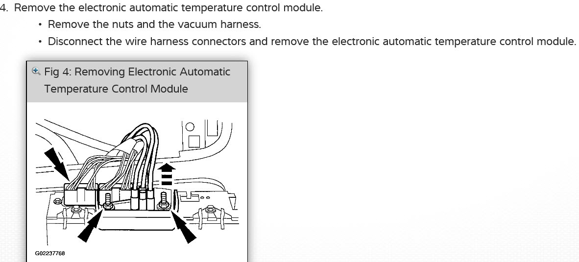

I have an extra climate control unit to put in the car, but I need to know how to remove the old one without damaging anything
Oct 4, 2015 at 4:03 AM
HMAC300
  • 48,601 POSTS
you should have it scanned for codes as that may not be the problem. once it's replaced it won't work anyhow as it has to be programmed to your car.

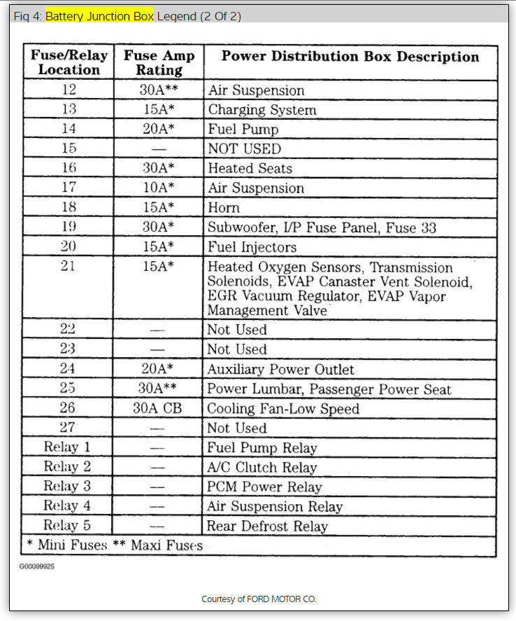

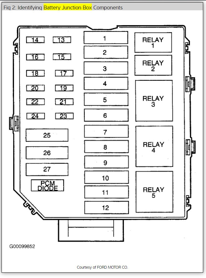

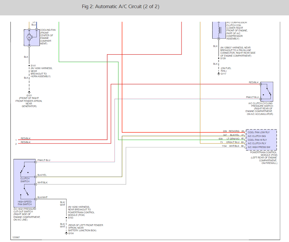

Same thing happened to my car. AC compressor clutch shorted and heated up blowing fuse to ac system controller. Replace ac compressor and ac controller fuse.

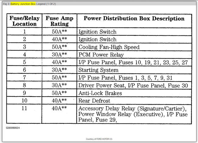

Put a new A/C compressor in my car. Now the control panel for the AC/heat does not come on at all.
Aug 26, 2019 at 11:24 AM (Merged)
  • 55,688 POSTS

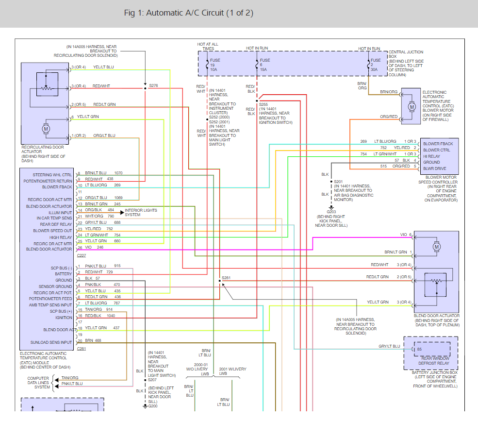

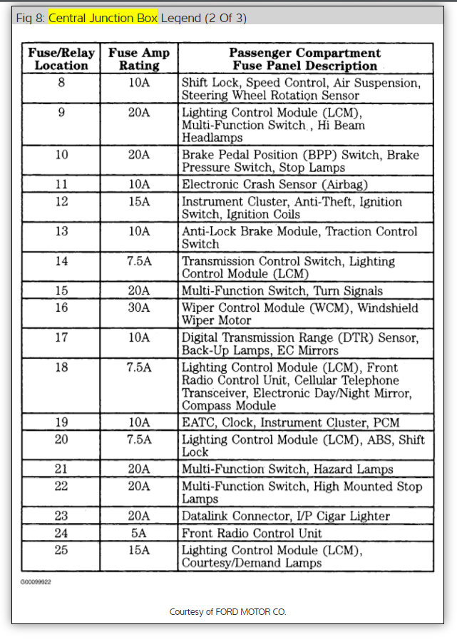

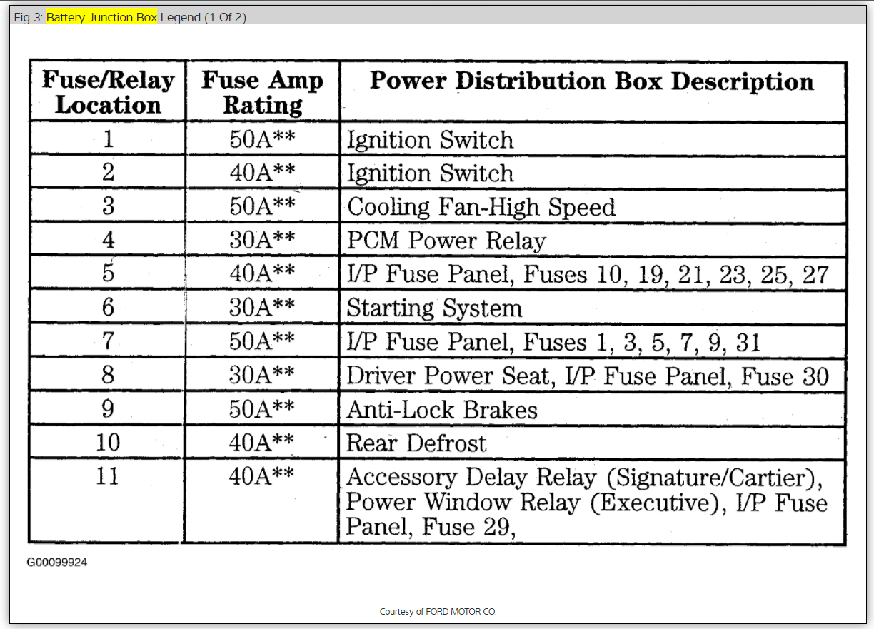

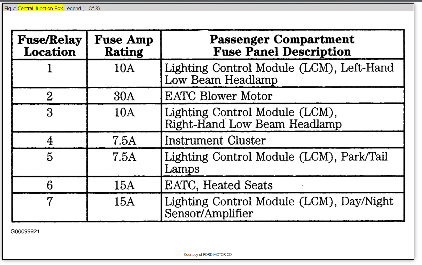

It sounds like you have a fuse that is out. Here is a guide to help you check the fuses for the system and a diagram (below)
and
It could be the control head, check for power and ground.

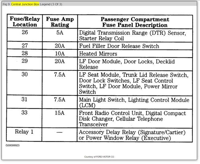

okay 1st off i had circuit city install a amp and subs to my factory changer and they messed something up bad!! they ran a wire to my under dash fuse box not sure which one but i think it was the wiper one. Now my wipers only work on high and my climate control wont work at all not even turn on .. well i un hooked all they did and when i took the wire out the fuse box the climate control came back on and worked for about 2 days and now it wont do anything at all ... i checked all the fuses and nothing was wrong i replaced the blower relay and nothing and today and yesterday i noticed when i have had the car on for awhile the screen on the climate control comes on but it wont work its like its frozen??? please help me figure this out no heat in the winter sucks bad! now ive seen that after the mayhem of this bad hookup job the filler door for gas wont open with the switch, the windshield wipers only work on high, the climate control dont work, the windows wont go up sometimes for a few mins, id say the screwed me!! HELP
MERLIN2021
  • 17,250 POSTS

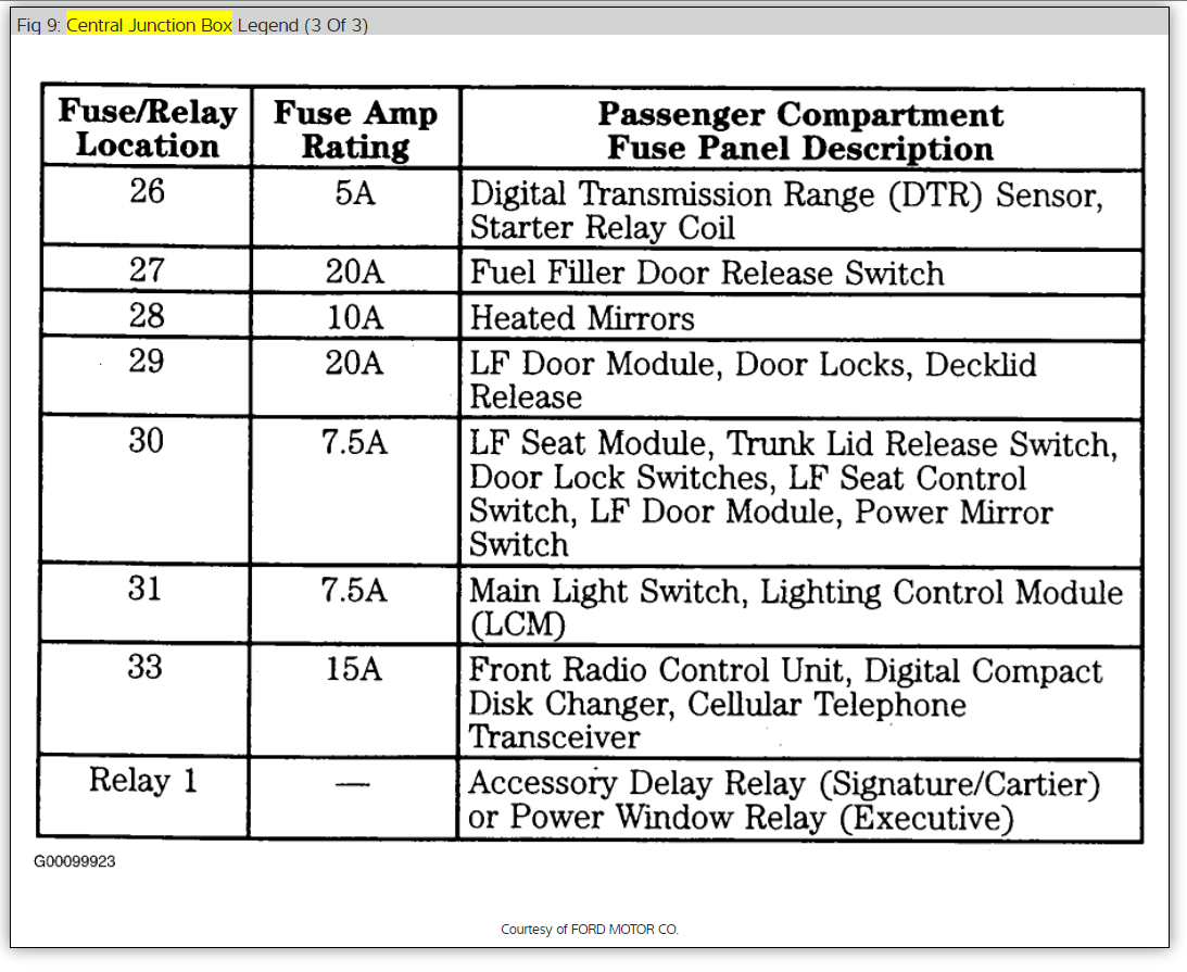

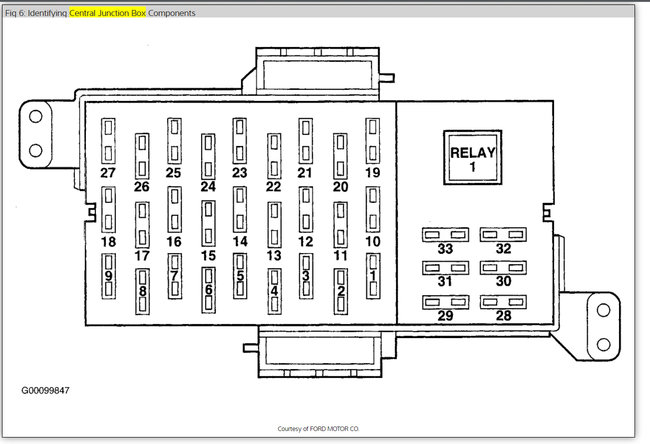

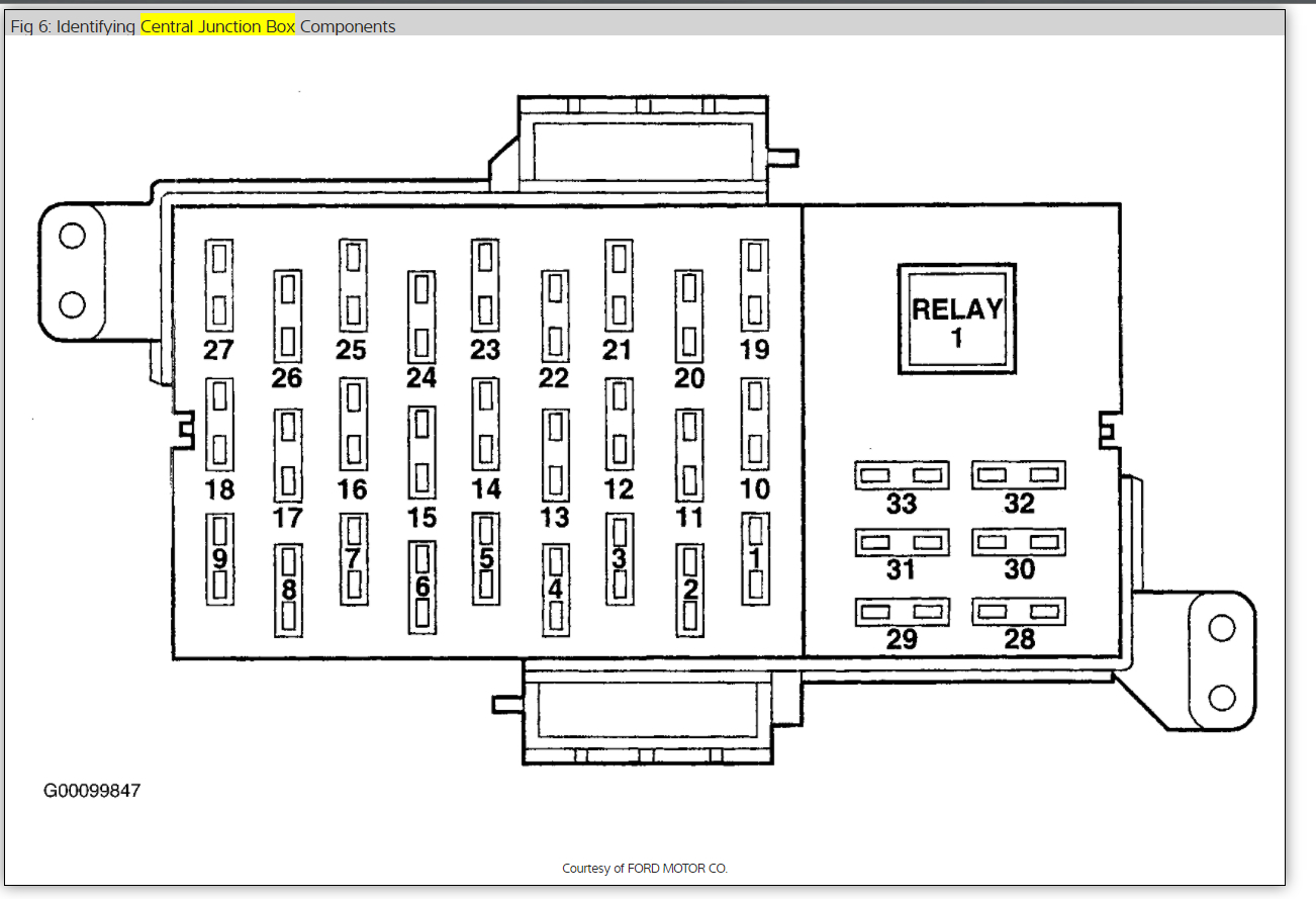

With the wipers and the EATC out, you'll need this car put on a scanner that can two way communicate with the modules, "B" codes will be present, in the mean time check fuses 1 and 6 inside the car. And if you can figure out what they tapped into to power it, post the info. Check accessory fuses 1 and 2 under the hood in the battery junction box.
https://images.2carpros.com/forum/automotive_pictures/62217_tc_1.jpg
If there is any life in the EATC Try this and post any codes displayed. Run the self diagnostic test on it by turning the key to on, then press off and floor at the same time, then within 2 secs, press auto, If there is a problem a trouble code will appear on the display...To exit self test, press the BLUE, cooler button this also retains error codes, To erase code and exit, press defrost, choose one of these before you power down the system... Test with engine at 120 degrees or more, and cabin between 40-90 degrees.Post any codes recorded here and I let you know what's defective...

I have a 2000 Lincoln town car and my #6 fuse keeps popping.what all can I look at as a possible cause?any help would be greatly appreciated!!!! Thank you.

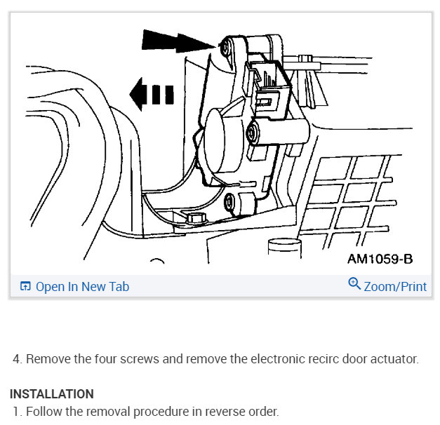

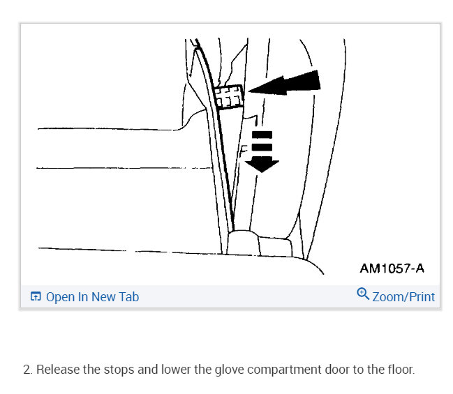

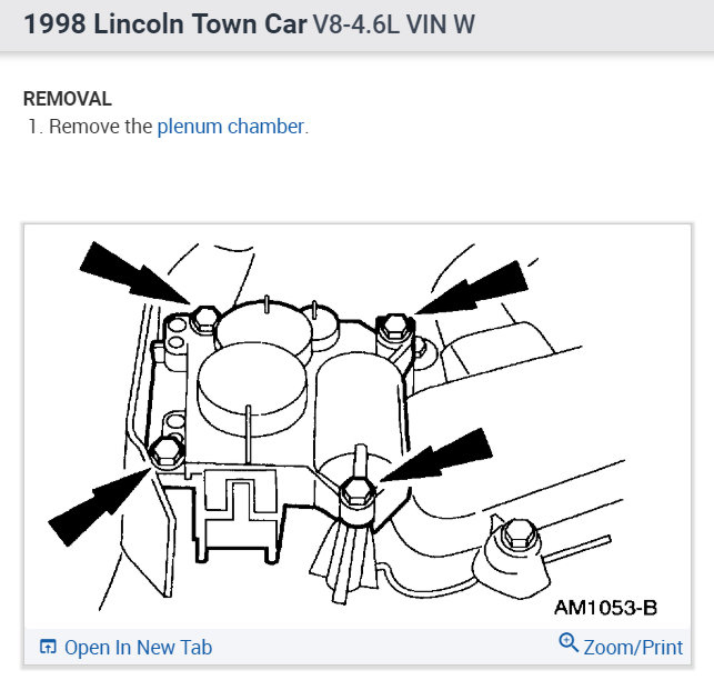

HOMER12
103,115 miles 4.6L engine.
System only puts out hot air, sounds like a door under the dash is opening and closing constantly it will stop when I set the temperature control to 75 degrees, but still only puts out hot air. When the car is turned off after warm up and re-started it puts out cold air for ten to fifteen seconds then max hot again no matter what the temperature setting is. Any ideas?
DKHOME

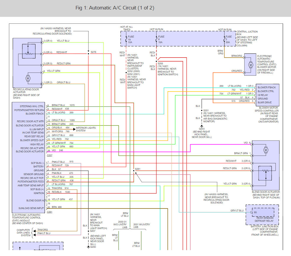

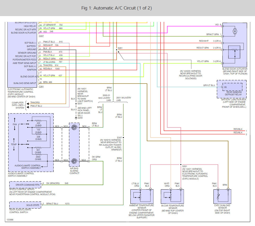

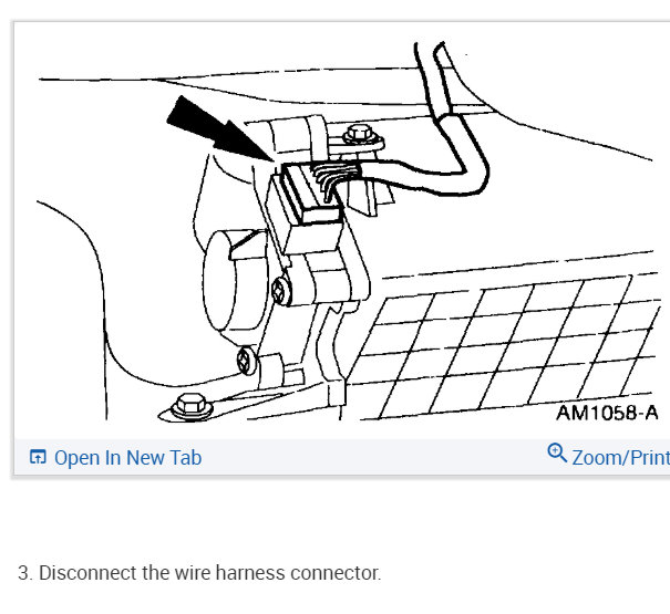

It sounds like your blend door actuator needs to be replaced. You can do it yourself but its a long and annoying job that requires removing the dash. The part cost between $65.00 to $80.00 depending on where you go. If you go to a shop expect to pay between $600.00 to $850.00. Sometimes you can get your hands in there to do it here is a guide to help walk you through and the location of the blend door actuators.
Check out the diagrams (Below). Please let us know if you need anything else to get the problem fixed. Cheers,

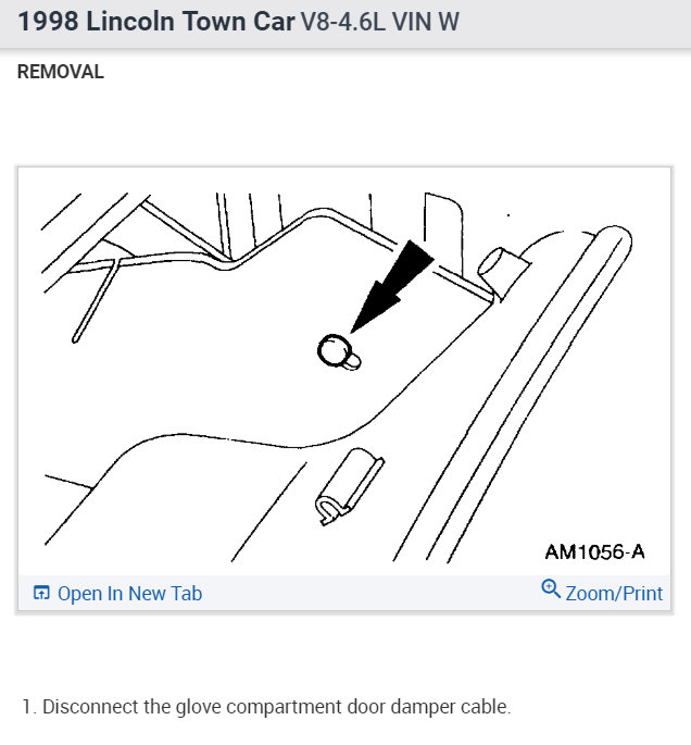

JIANGJIANG
I have heat and i have air conditioning with excellent control of temp, however, i have heated or cold air coming out of the dash vents only. There is no discharge from the floor or floor/defrost or defrost settings when these setting are used. Just air discharge from the vents on the dash. I get codes 024-025 indicating the blend door actuator, but i have excellent temp control, so i do not think bda is the problem. Is there another vac motor or electric actuator that is causing the problem? Where is it located and how do i repair it?
HOMER12
The problem was the electronic automatic temperature control module, in the center of the instrument panel.
HMAC300
  • 48,601 POSTS
check to make sure vacuum motor at floor duct gets vacuum if it does replace the motor. we don't have a pic. if it'snot getting vacuum it may be the control head which the vacuum part may be sold seperately

QLGREENSR
I have a 2000 Town Car. When set at 60 it blows real hot and fast, but when i set it to the temperature outside it blows soft. could that be the actuator or the temperature sensor?
AFTERBURNER1
1998 Lincoln TC. 4.6 liter 85,000 miles.
The receptical on blend door cracked and allowed the motor to rotate without moving the blend door.

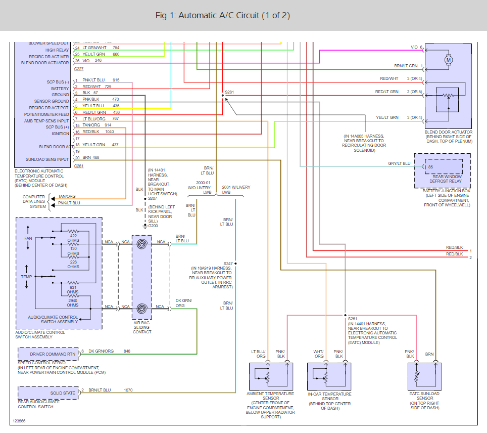

Have made repair to this recepticle, but have not connected the drive motor, because it turns 360 degrees and the blend door can only turn 90 degees at the maximum. The blend motor drive is extemely powerful and turning 360 is what cracked the blend door recepticle.
Question: how is the rotation of the blend door actuator (motor) controlled so that it cuts out prior to starting a 360 rotation?
AFTERBURNER1
Found answer to my question. The drive module for the blend door behind the glove box (no need to remove dashboard) has an internal variable resistor that signals its location to the automatic climate control module. (ATC) From resistance changes the ATC determines the drive location.
