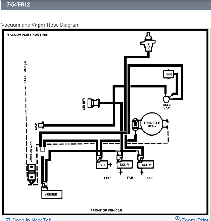

Replaced all vacuum lines save 1. The yellow line runs to the back of the engine and when I was replacing, it was not plugged into anything so I couldn’t find anything to attach the hose to.
The motor was redone before I purchased it so I'm not sure if they removed something that should have remained.

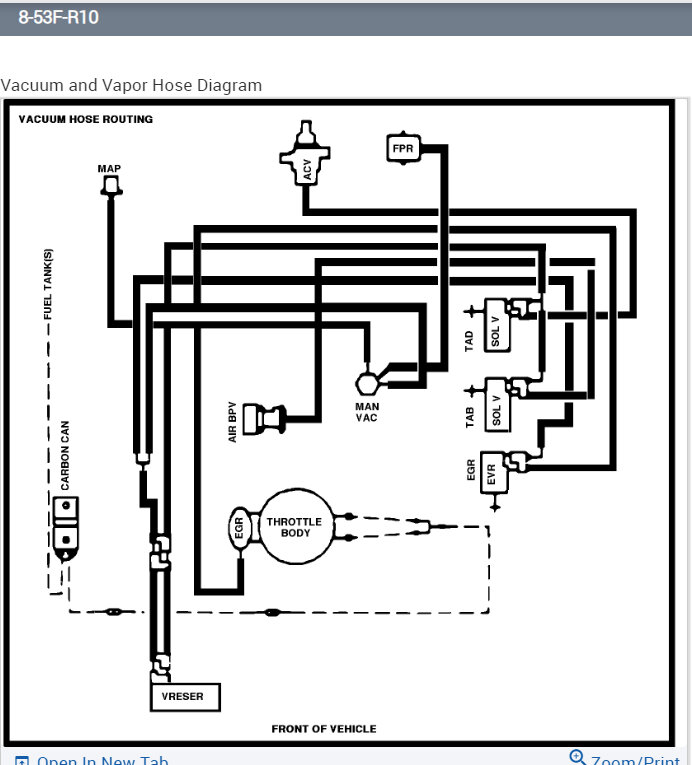

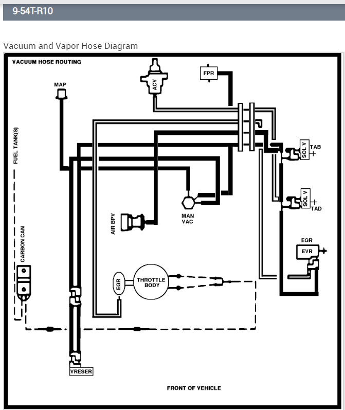

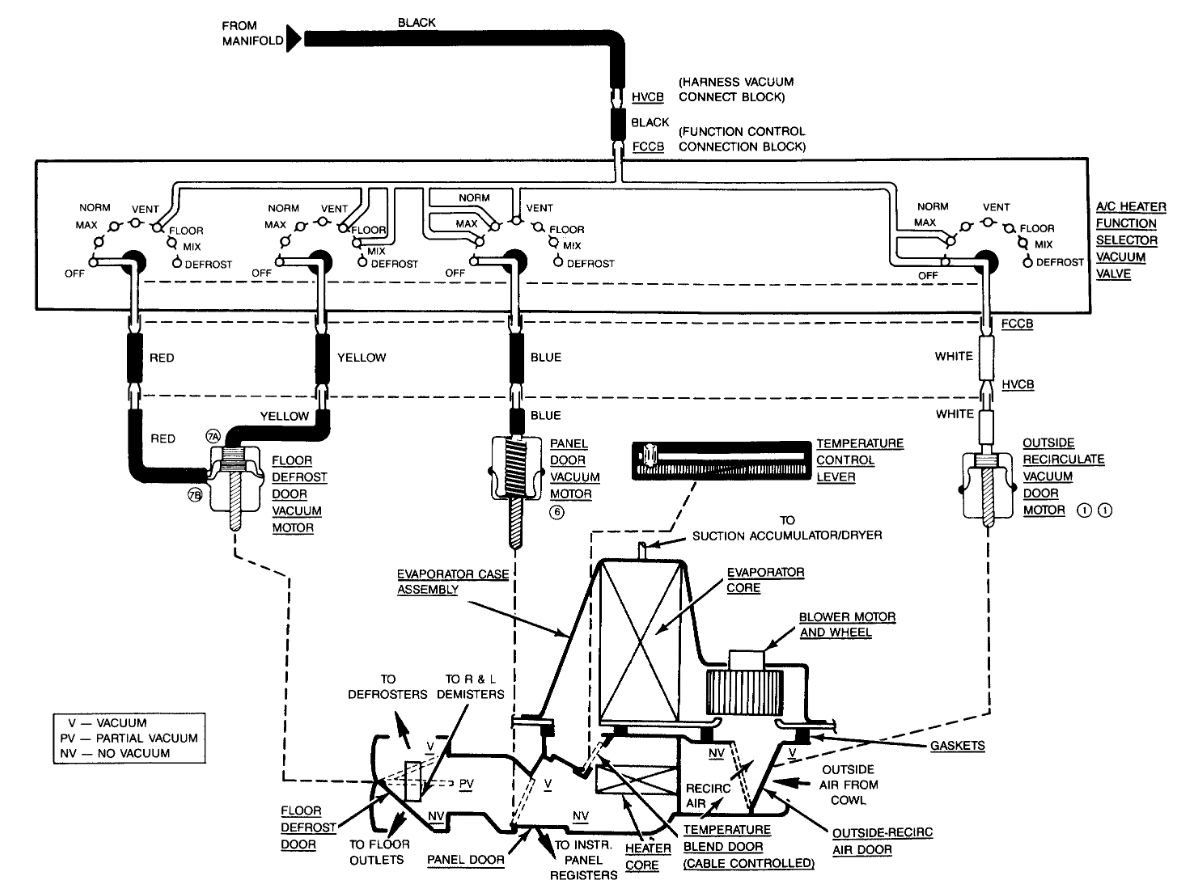

On the older vehicles they use engine vacuum to move the heater actuator doors in the dash, so for example, I have an older Ford I kept and it has a small round vacuum tank, its plastic but it has vacuum lines running to it from the intake manifold so that the heater doors can be actuated when the vehicle is off. Do you have any vacuum lines that are not attached to anything and are open to the atmosphere? The high idle is what points to a vacuum leak. Or you may have an idle control valve that is sticking or not functioning correctly. Below are the vacuum line routing diagrams just in case you need them, the 1st one is for the heater system, the other 3 are the different setups possibly for this vehicle.
