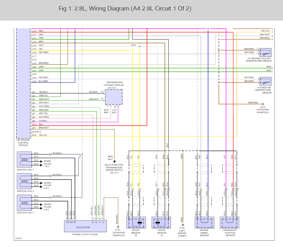

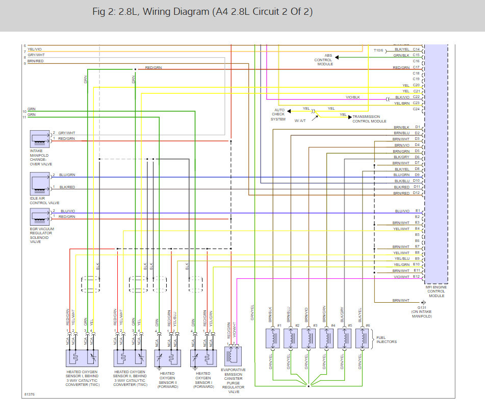

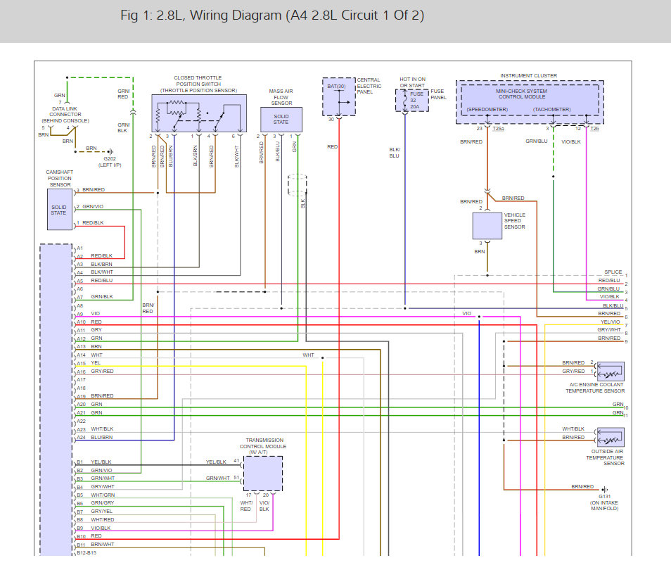

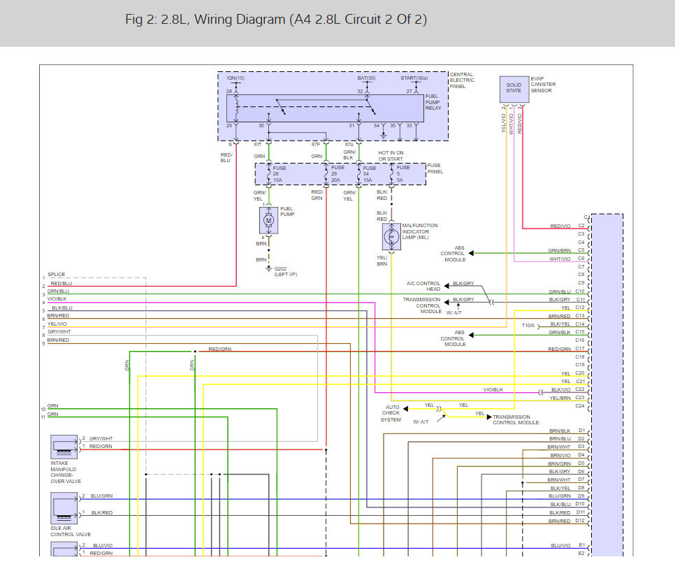

The closest wiring info I could find for your vehicle, is for the 2.8L AFC
engine. Here is a PDF that includes ECM & Instrument cluster.
You will need to take some time and go through the pages to find all the
fuses that apply to the ECM & Instrument cluster, check those fuses and
replace those that are bad.
If all the fuses are OK, check the ignition switch.
I'm not sure how much different the wiring is on your right hand drive vehicle
and idealy you would want to source the correct one.
Fuse S5 (fuse 5) supplies power to the instrument cluster warning light. The
fuse gets power from the ignition switch.
The ignition switch has big red wires. They should have power all the time.
Ignition 15 circuit is the black wire (sw on page No. 1/10).

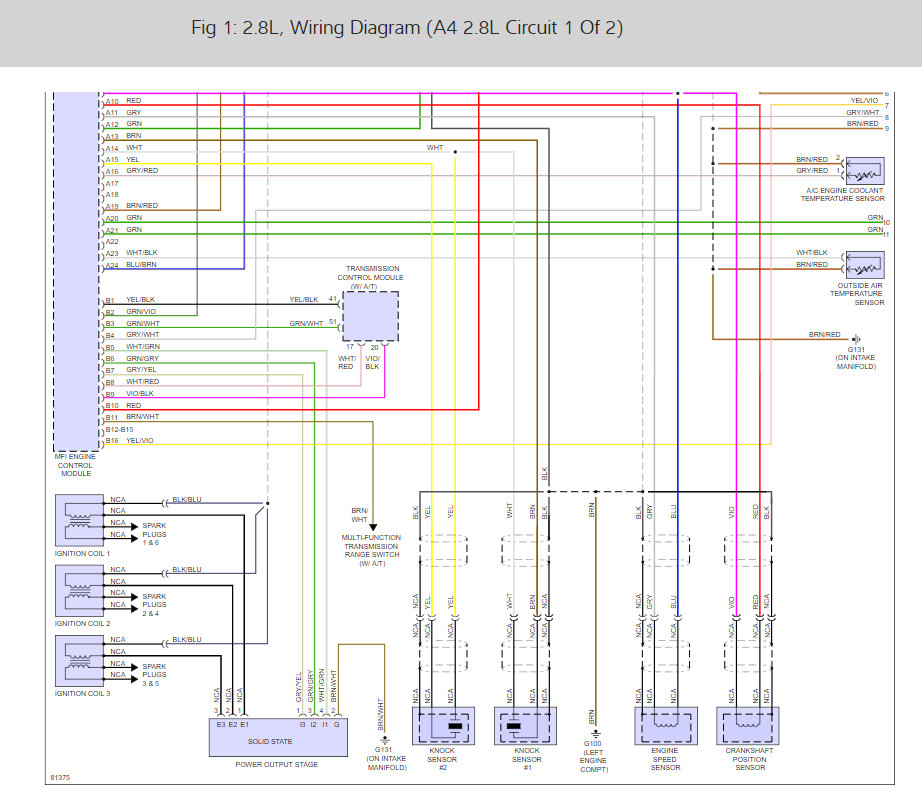

Here is a guide to help you check the wiring and the engine and fuel injector wiring diagrams below.
