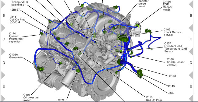

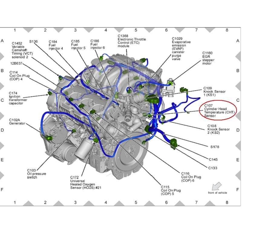

This vehicle has a cylinder head temperature sensor (CHT). The CHT is on the rear of the cylinder head. See the attached pic.
If there is a coolant temperature sensor that is different, it will be located near the thermostat housing.

Good evening,
I attached the location for you. It is by where the upper hose attaches to the thermostat housing.

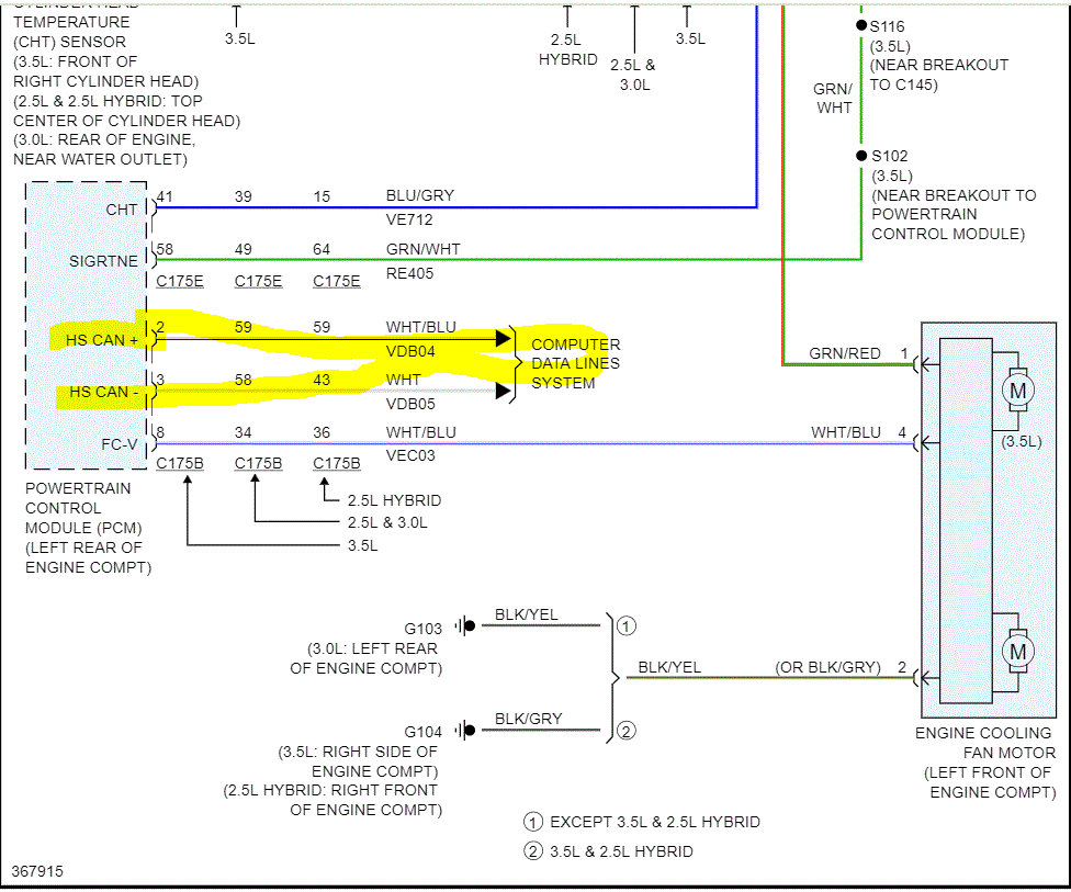

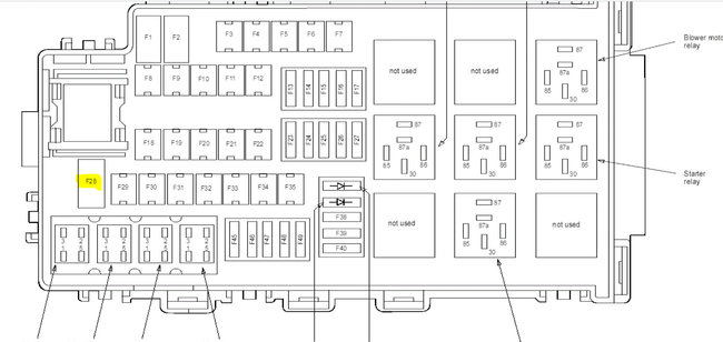

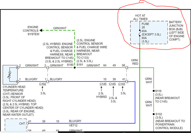

The first thing I suggest is to check fuse 28 in the engine compartment fuse box. If you look at pic 1, I attached a pic of its location. In addition to just checking the fuse, confirm there is power to it. Here is a link that explains how that is done:
If the fuse checks good, I recommend having the CAN bus system scanned on the vehicle. CAN stands for computer area network. This network is how all the different modules and computer speak together. If you look at pic 3 below, you will see that I highlighted specific CAN wiring that is for the cooling system. Pic 3 shows the fuse and portion of the wiring diagram.
Here is a video of how to scan the CAN bus system and why it is becoming more necessary to do that a traditional OBD2 scan:
https://youtu.be/InIlnsjOVFA
Now, if the CHT sensor is bad, it can be the cause of the fan not to run. Also, the fan motors could be bad. It should turn on when you turn the A/C on, so check that as well. Or, it could be a break down in communication in the CAN bus network.
Lets start with the fuse first. Check that and see if it turns on with the /AC running. Also, remove the fan fuse and see if you can turn the cooling fan by hand and if it turns smoothly or seems to drag or feel rough. Here is a link explaining what to check on the fan. The link describes two different types of fans. The second type (electric) is what you have.
The bottom line is if the fuse is good and the fan turns freely, you really need to have the CAN bus system scanned for codes and error notices. That is going to get to the bottom of the problem.
