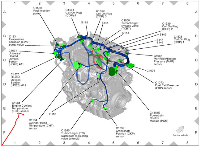

Here is the location of the engine temperature sensor and all the other sensors with a guide to help see whats going on if the sensor does not fix it.
https://www.2carpros.com/articles/engine-overheating-or-running-hot
Check out the diagrams (Below). Please let us know what happens. (ECT is the sensor you are looking for.)

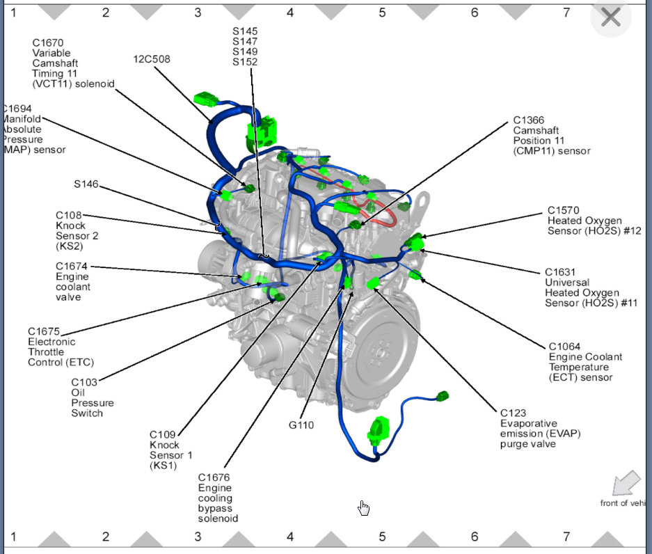

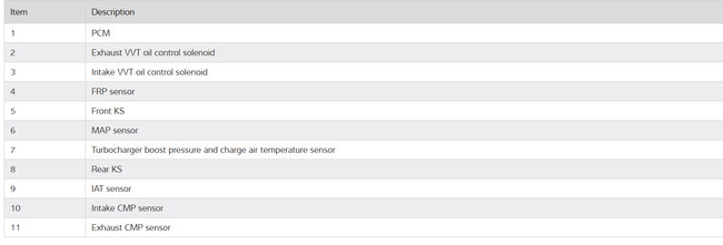

BMDOUBLE
  • 1,139 POSTS

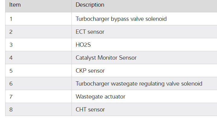

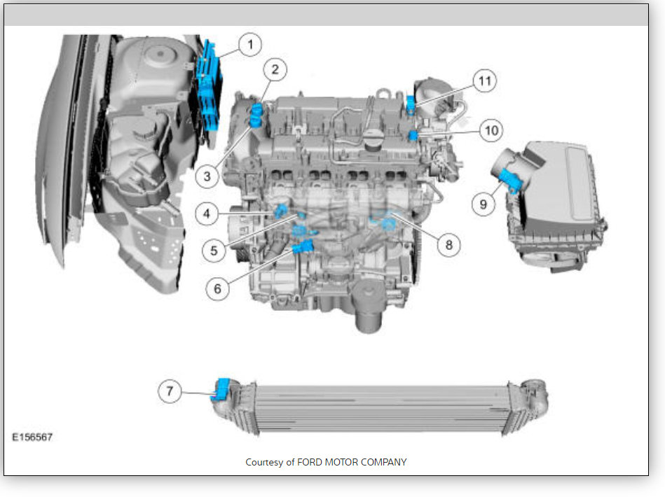

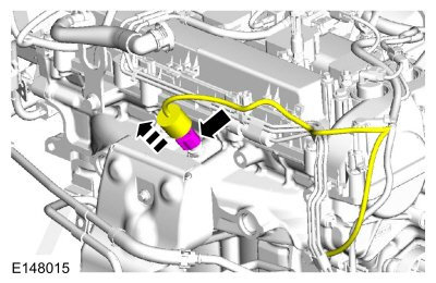

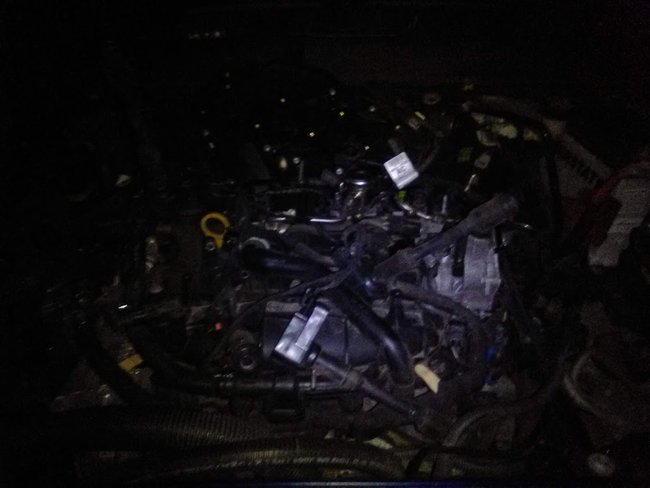

There are two different places it can be depending on the engine which I have supplied both. Check out the images (Below). Please let us know if you need anything else to get the problem fixed.

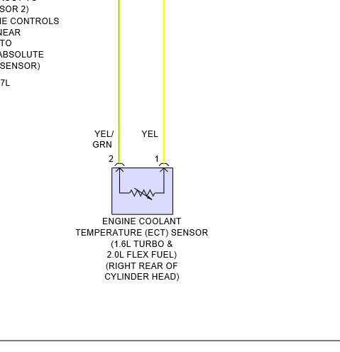

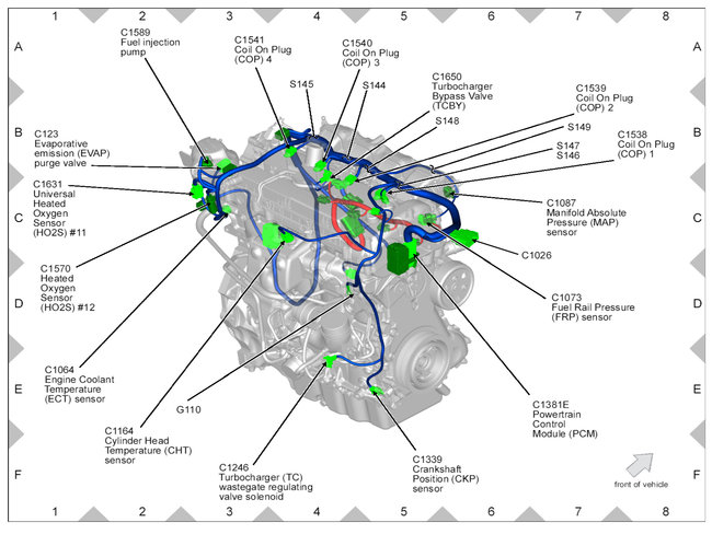

BMDOUBLE
  • 1,139 POSTS

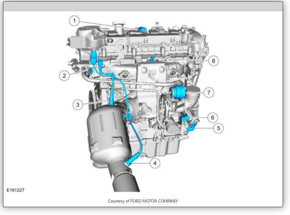

The 2.5 is not a turbo, so here is a picture of the 2.0 turbo cht location. The 1.6L and 2.0L are turbo models.

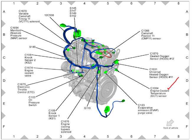

JOHN ANDERSON2
My apologies, i am getting to old for this. The mechanic I had said it was a 2.5 it is the 1.6.I have been working on this for 5 days now waiting from my local contacts to help with no luck. Sorry about the quality but here are some photos I just took.
Aug 29, 2020 at 6:00 AM (Merged)
BMDOUBLE
  • 1,139 POSTS
Okay, no problem, here is the 1.6 location.

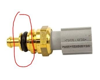

ECONNER123
  • 5 POSTS
Coolant is leaking into sensor creating a miss. read have replaced it twice. was wonder if there is suppose to be a seal in the coolant sensor port?
  • 110,248 POSTS
Is coolant leaking past the threads? If so, there is no seal. Try using Teflon tape on the threads and then properly tighten.
Let me know if that helps.
ECONNER123
  • 5 POSTS
It doesn't have threads.
  • 110,248 POSTS
Can you upload a pic of the part? I'm seeing one that threads into the engine in my manuals. How does this one attach?
  • 110,248 POSTS

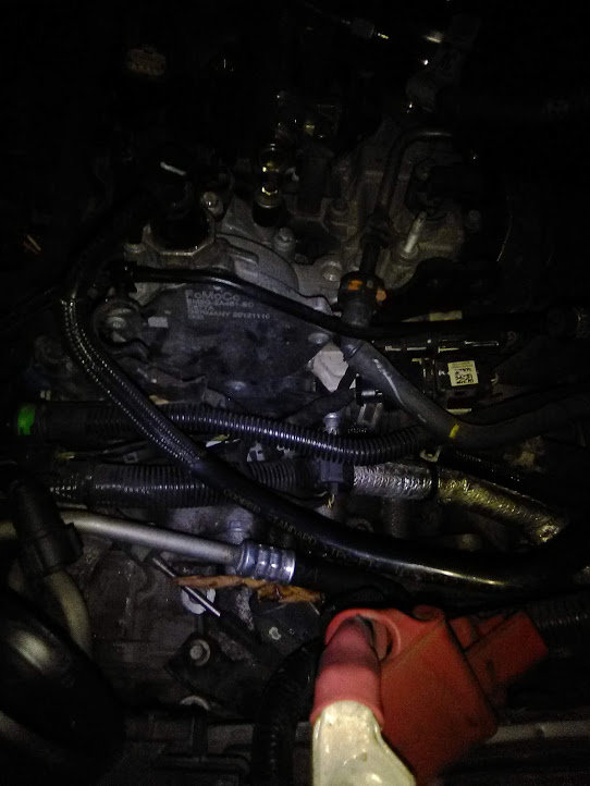

Okay, I found it. It is the one held in with a clip. First, pull the connector off and see if it is wet inside. These commonly go bad an leak through the sensor into the connector and then out. Also, there is an o-ring on the sensor. If it isn't leaking through the sensor, remove the old one, make sure where it goes into the engine is clean, and lubricate the o-ring prior to install. I usually use something like vasoline. If you don't lubricate the o-ring, there is a good chance it will be kicked and leak.
Make sure the sensor is fully pushed in and that the clip is properly seated.
I attached a pic of the sensor and circled the o-ring that I mentioned. However, remember that the o-ring may not be the problem but instead, it is leaking through the sensor, into the electrical connector, and then out.
Let me know if this helps.

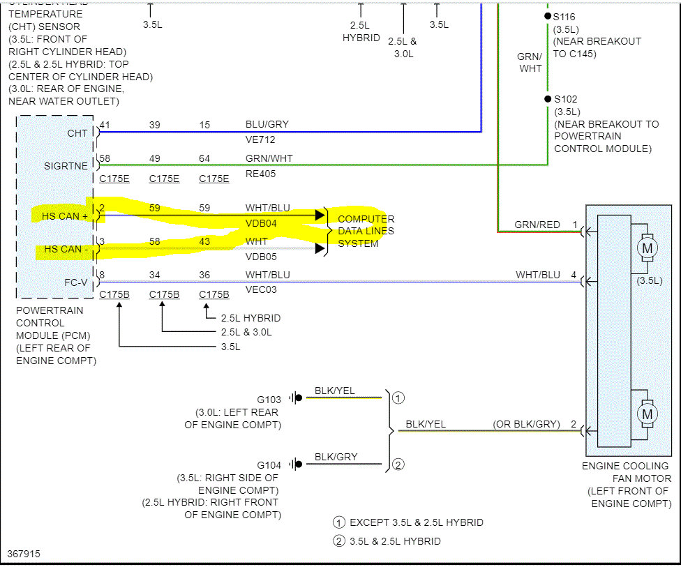

SHANNONKAY

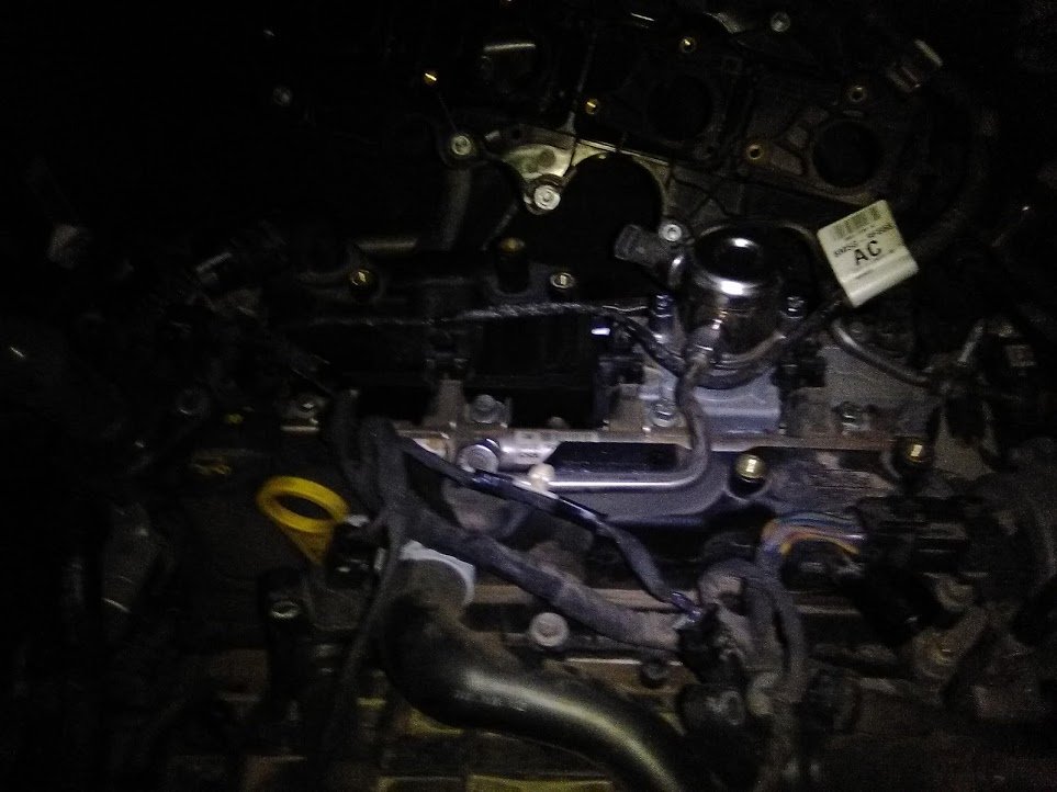

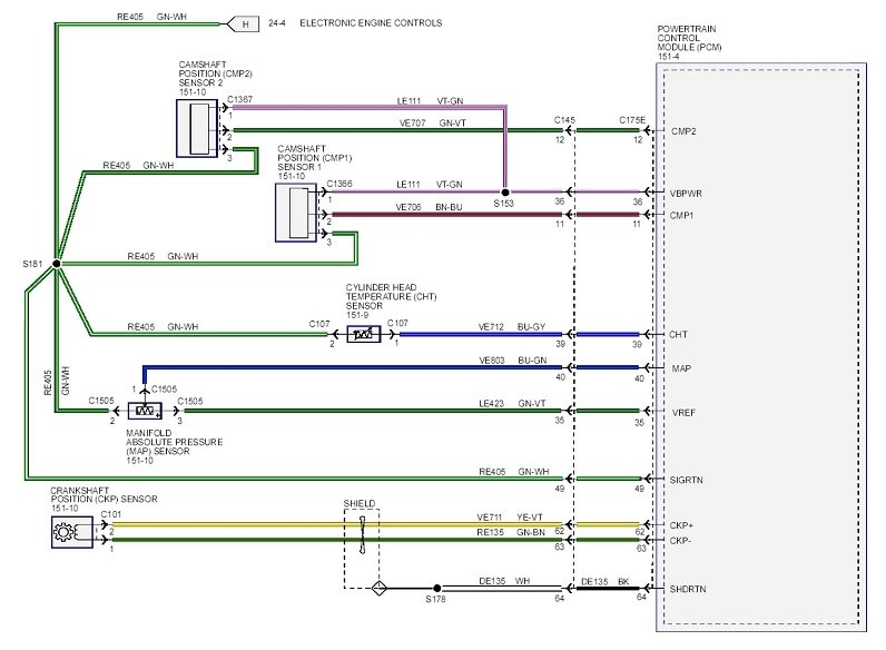

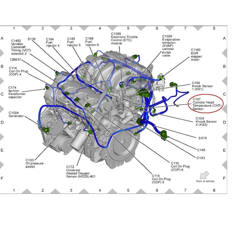

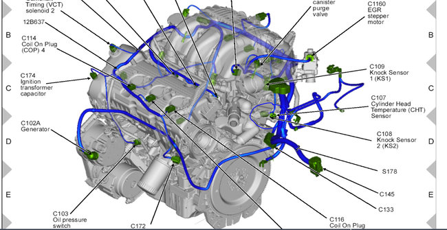

I am having trouble locating the coolant temperature sensor in my car. can you help me? I have searched on the internet and can't seem to find my type of vehicle. Thanks in advance.
  • 110,248 POSTS
This vehicle has a cylinder head temperature sensor (CHT). The CHT is on the rear of the cylinder head. See the attached pic.
If there is a coolant temperature sensor that is different, it will be located near the thermostat housing.

CARADIODOC
  • 34,414 POSTS
There is no normal coolant temperature sensor as we normally think of them. Your engine uses a cylinder head temperature sensor.

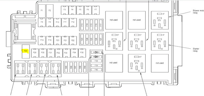

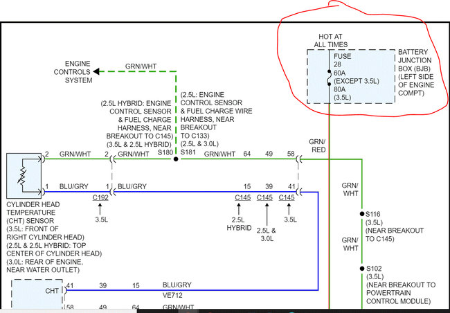

The car overheats while the car is stopped, the fan does not kick on and check engine light comes on periodically. We purchase the coolant temperature sensor so figured if they carried it for the year make and model that our car had it.
  • 110,248 POSTS
The first thing I suggest is to check fuse 28 in the engine compartment fuse box. If you look at pic 1, I attached a pic of its location. In addition to just checking the fuse, confirm there is power to it. Here is a link that explains how that is done:
If the fuse checks good, I recommend having the CAN bus system scanned on the vehicle. CAN stands for computer area network. This network is how all the different modules and computer speak together. If you look at pic 3 below, you will see that I highlighted specific CAN wiring that is for the cooling system. Pic 3 shows the fuse and portion of the wiring diagram.
Here is a video of how to scan the CAN bus system and why it is becoming more necessary to do that a traditional OBD2 scan:
https://youtu.be/InIlnsjOVFA
Now, if the CHT sensor is bad, it can be the cause of the fan not to run. Also, the fan motors could be bad. It should turn on when you turn the A/C on, so check that as well. Or, it could be a break down in communication in the CAN bus network.
Lets start with the fuse first. Check that and see if it turns on with the /AC running. Also, remove the fan fuse and see if you can turn the cooling fan by hand and if it turns smoothly or seems to drag or feel rough. Here is a link explaining what to check on the fan. The link describes two different types of fans. The second type (electric) is what you have.
The bottom line is if the fuse is good and the fan turns freely, you really need to have the CAN bus system scanned for codes and error notices. That is going to get to the bottom of the problem.

If I could throw in a suggestion, with the key on, remove the connector for the coolant switch and see if the fan kicks on. If it does not, then go to the fan and test for power at the fan with a test light or voltmeter.
Just a quick test for the circuit.

They confused the issue by calling it a "cylinder head temperature sensor".
What are you trying to solve? Temperature sensors have an extremely low failure rate because there is just one component inside them.
