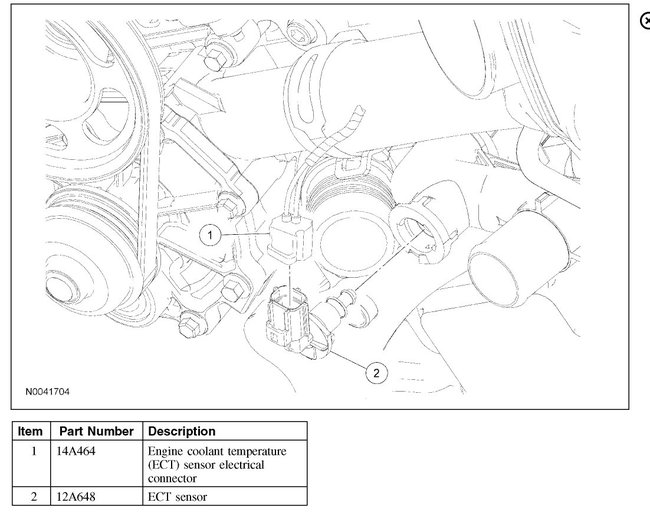

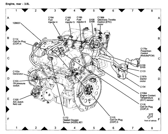

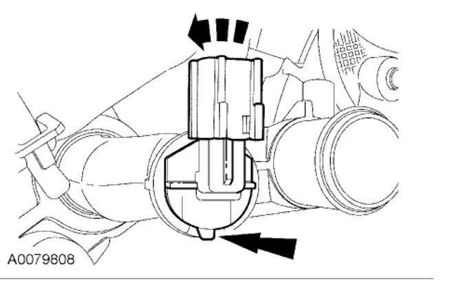

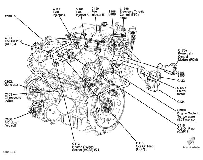

Need to know where temperature sensor is located v6 duratech?
Jul 12, 2017 at 1:34 AM
  • 55,548 POSTS

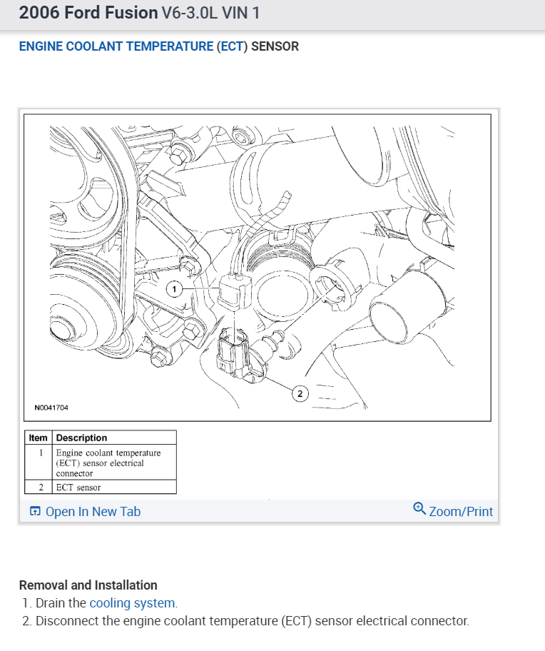

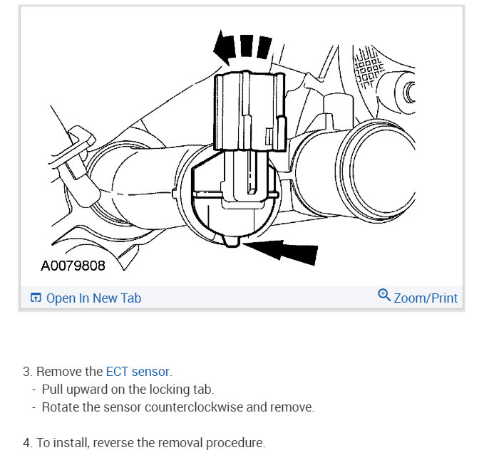

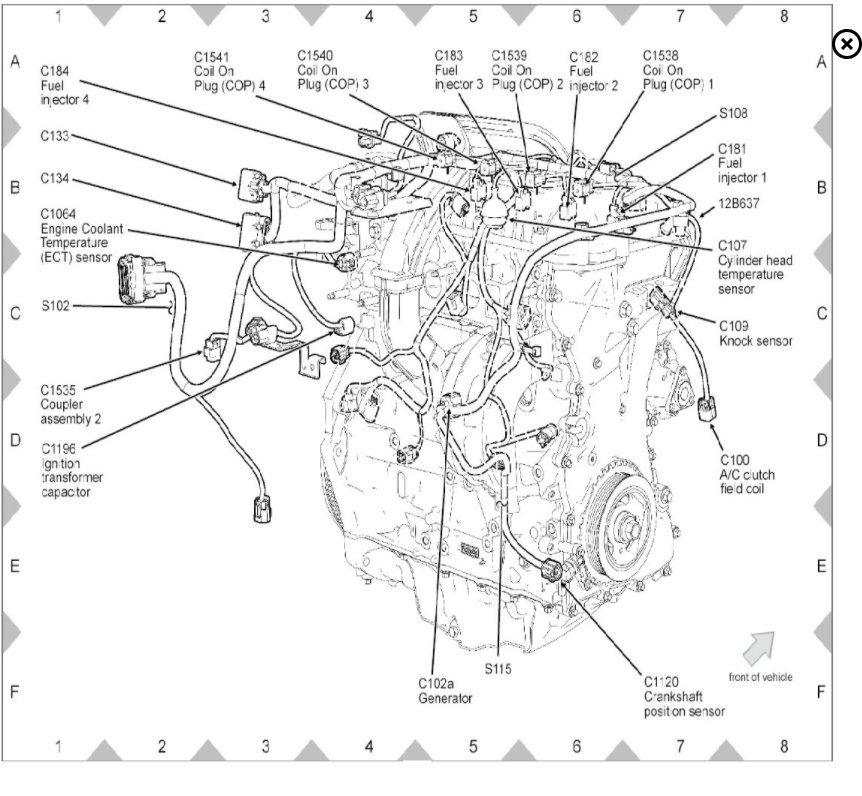

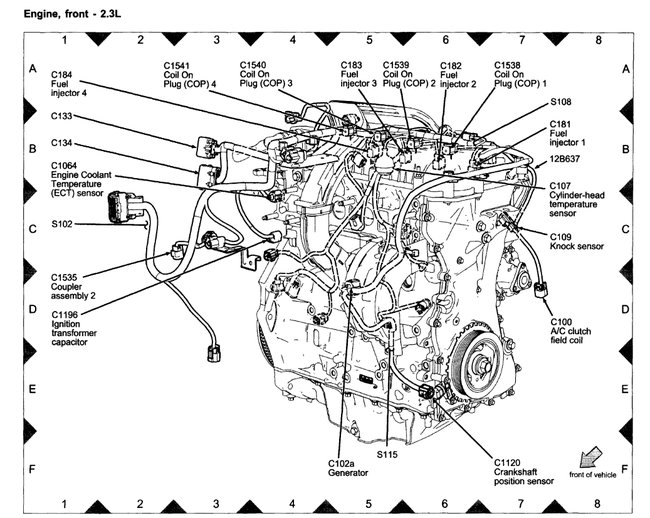

The sensor is located near the front of the engine on a coolant hose fitting. Here is a diagrams for both engines, (below) and a guide that will walk you through the steps of changing the coolant temperature sensor.
https://www.2carpros.com/articles/coolant-temperature-sensor-cts-replacement
Jul 12, 2017 at 9:05 AM
DOCFIXIT
  • 18,828 POSTS
It is located on rear of engine on the thermostat housing. Follow top radiator hose to thermostat housing to find the sensor.

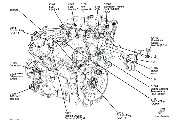

where is the engine/coolant temperature sensor located?
Jul 12, 2017 at 2:10 PM (Merged)
HMAC300
  • 48,601 POSTS
It is located near the thermostat housing at the upper radiator hose near the engine.
Here is a diagram below.
Please let us know happens so it will help others.

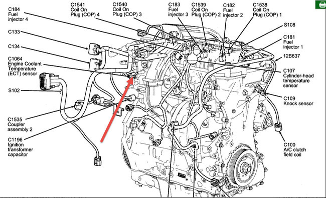

Where is the coolant temperature sensor located on my car?
HMAC300
  • 48,601 POSTS
see picture marked with an arrow.

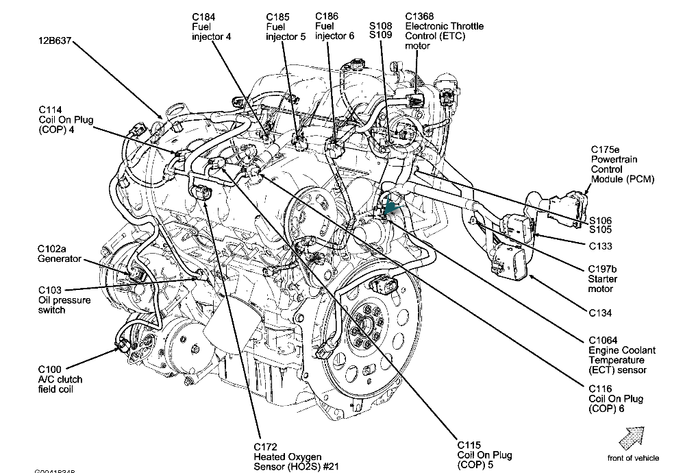

Where is the coolant temperature sensor located?
Dec 27, 2018 at 1:19 PM (Merged)
MHPAUTOS
  • 31,937 POSTS
Here is a guide to help walk you through the steps of the repair with instructions and locations for both engine in the diagrams below.
