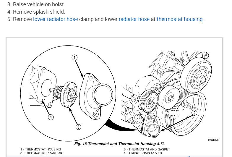

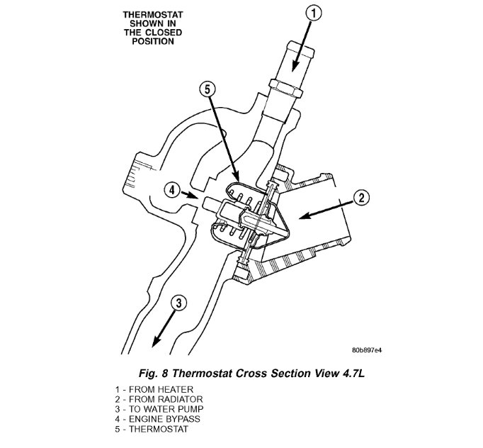

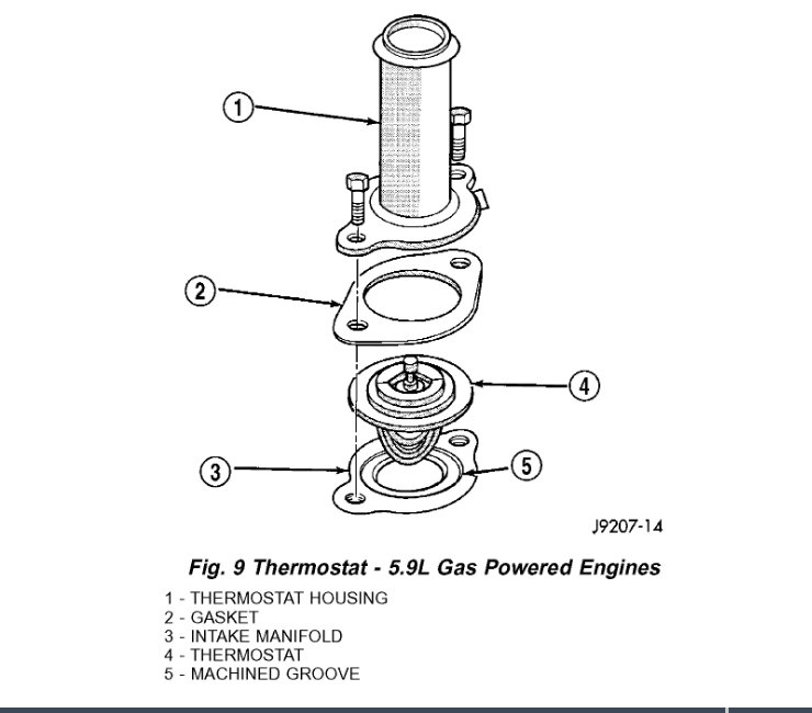

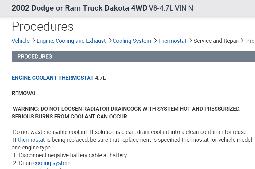

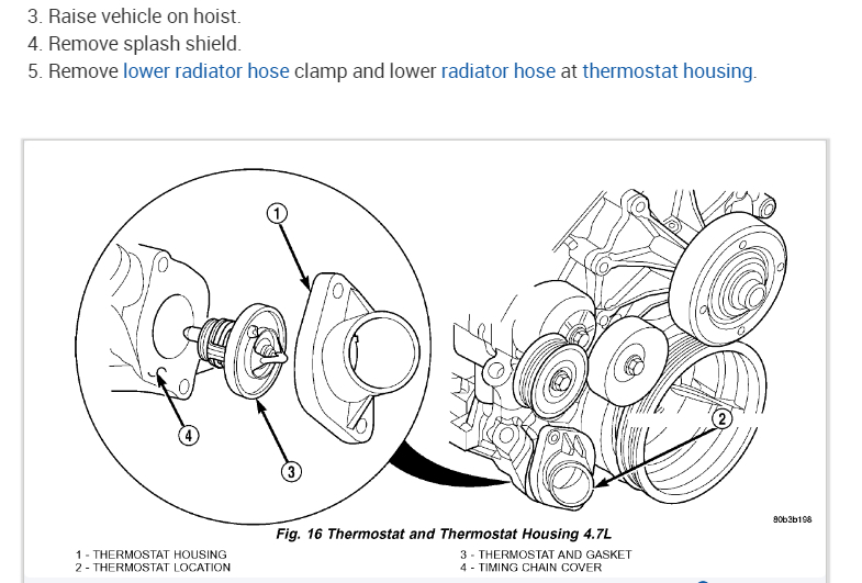

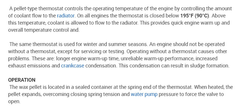

This sounds like your vehicle's thermostat might be starting to stick. The thermostat is what allows the coolant to flow. When it's closed, the coolant doesn't flow, when it's open, it does. The problem is when the thermostat gets stuck closed. The coolant doesn't flow and your vehicle's engine overheats. In the diagrams down below I have included a description, Original Equipment Manufacturer (OEM) part number, specs, and the instructions for the removal and installation of your vehicle's thermostat. Please go through these guides and get back to us with what you are able to find out.
