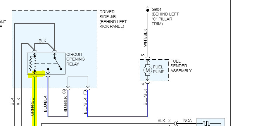

If the pump runs with direct power, then we need to start at the beginning. So, I need a couple of things checked.

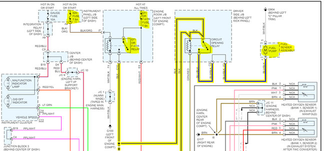

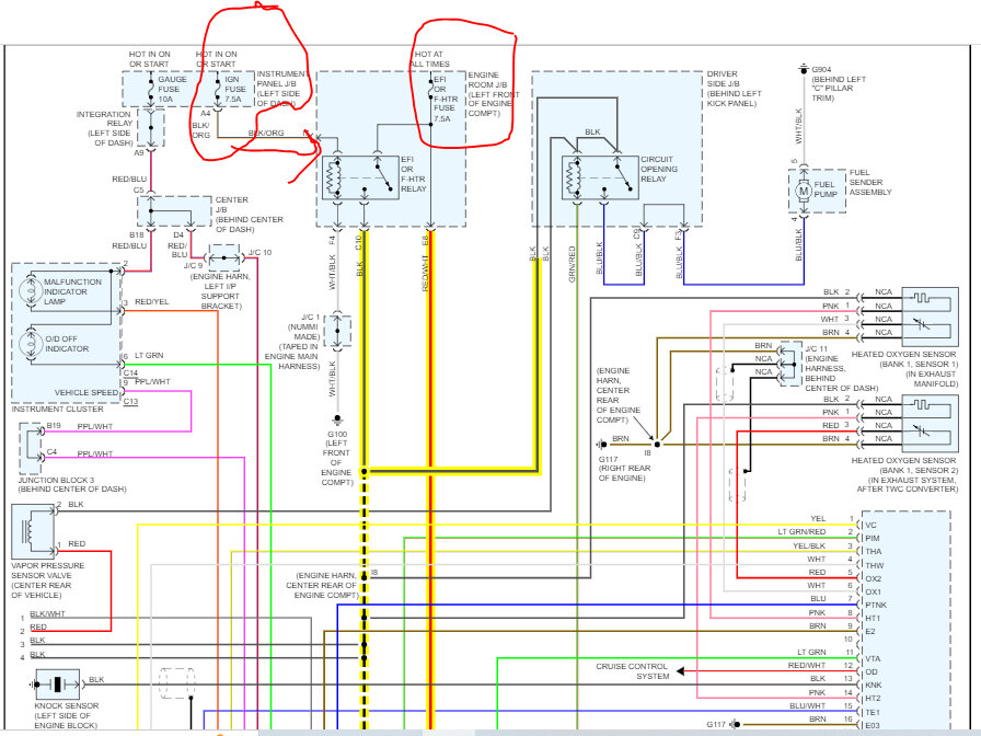

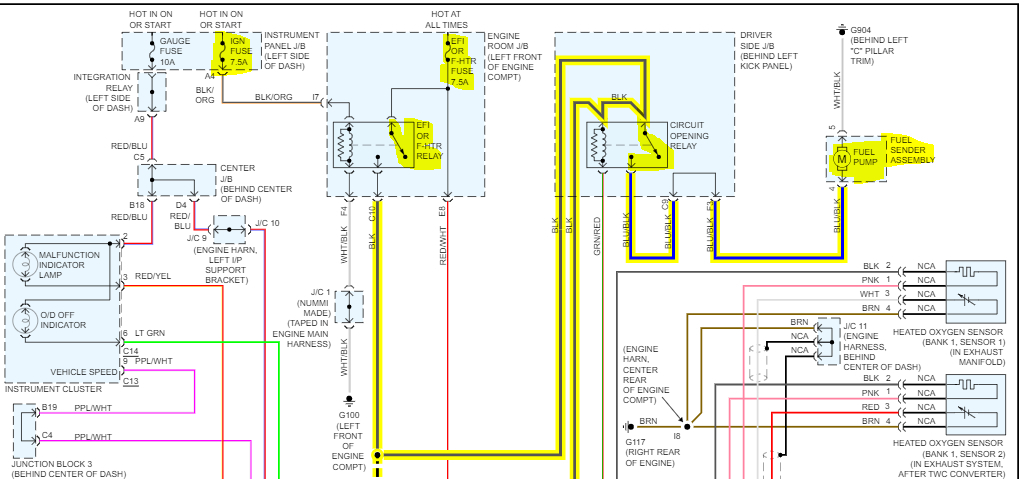

If you look below, I attached the wiring schematic for the fuel pump. Note I highlighted two fuses. I need you to check them first. The ignition fuse will only have power with the key in the run or start position. The EFI fuse will have power at all times.
When checking the fuses, first confirm it hasn't failed. If it appears good, then I need you to check if there is power to and from it. You can do this with a simple test lamp.
Here is a link that explains how it's done:
If both fuses are good and have power, then I need you to remove the circuit open relay. With the key off, one of the pins where the relay belongs will have power. Confirm that this is the case. If it is, remember the pin location which would leave 3 other connector pins.
Turn the key on to the run position. Of the three pins that had no power before, one more should have power. Confirm that for me.

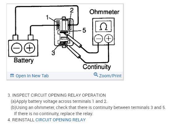

Let me know what you find so I know how to further direct you. Also, here is a link that explains how to test a relay. You may find it of interest because it breaks down what I'm explaining to do.
Let me know what you find or if you have other questions before, during, or after testing.
Take care and I hope you had a great Christmas.

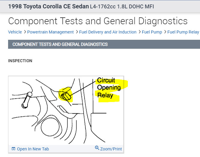

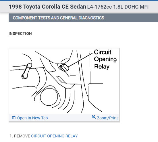

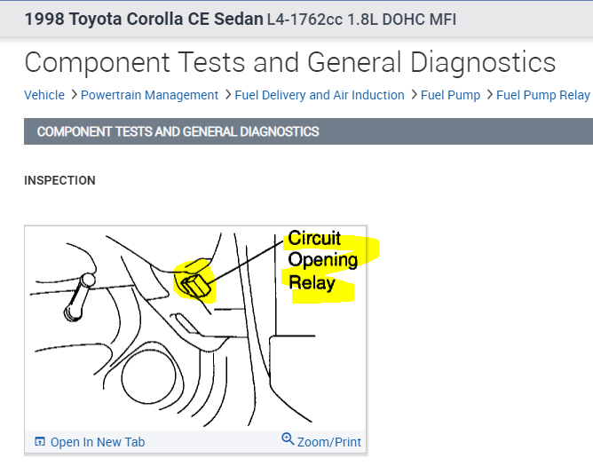

According to my manual, it is for both left and right-hand drive vehicles. The only difference is they are on opposite sides.
The relay should be a 4-pin relay. See pic above.
I attached the location which is shown on the left side of the vehicle. It should be in the same position on the right side of your vehicle.

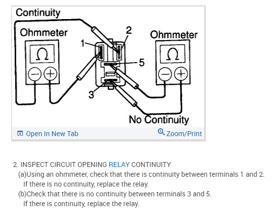

Also, I attached the diagnostics for the relay itself. Test it to see if it is good.
If you want to confirm the relay is the correct one, remove the EFI fuse under the hood. That will stop the power supply which is the one that has power at all times.
Let me know what you find.

Okay, if the relay has power and you tried a different one, then power should be sent out. If that is the case, then you either have a broken wire or no ground path for the primary side of the relay.
If you review the link above, it explains how to test a relay. In addition, it explains how the circuit works. You have power so we need to confirm the primary ground is available when the key is turned on.
If you look at the pic below, I highlighted the green wire with a red tracer. That wire provides the ground for the primary side of the relay via the ECM. The easiest thing to do is this. Take a test light and connect the alligator clip to the battery-positive terminal. Place the other end in the ground circuit. When you turn the key on, the test lamp should turn on if a ground path is provided.
If you have a ground and the relay is good and making connections at all the pins, the wire between the relay (power) to the pump is open.

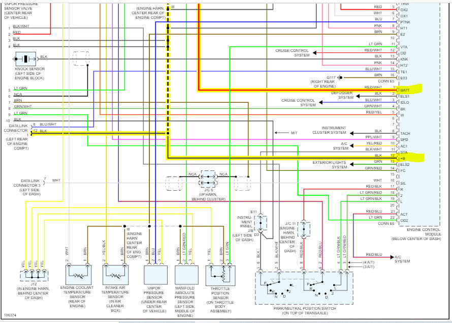

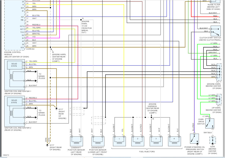

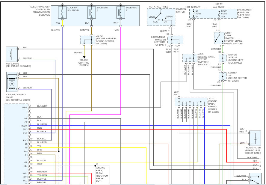

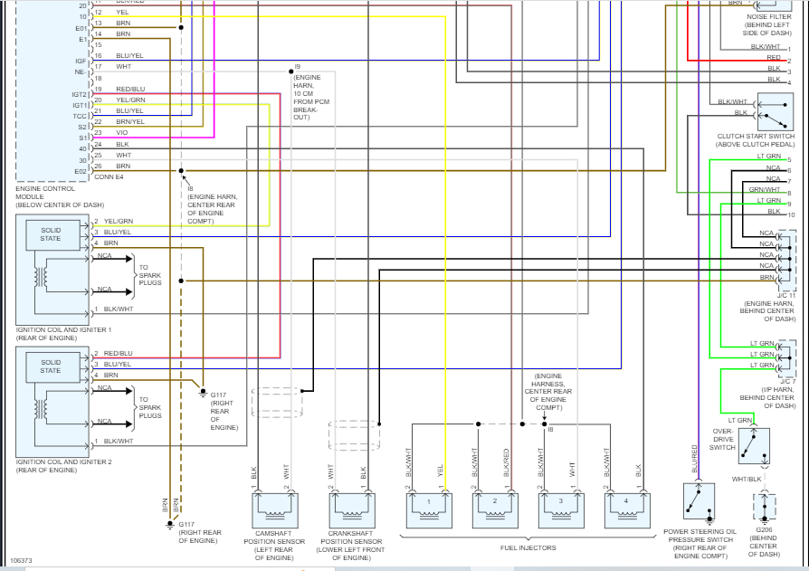

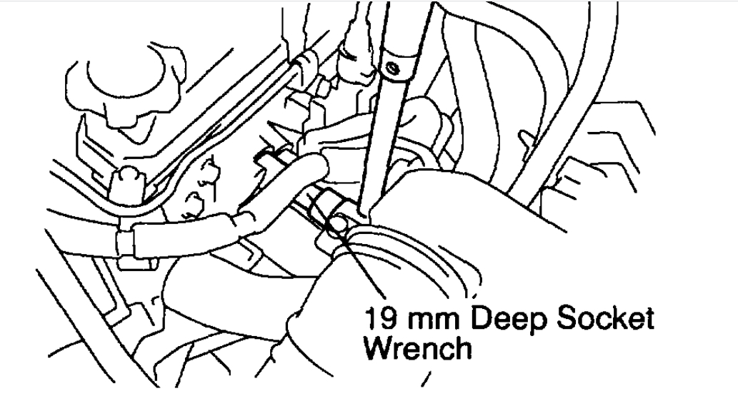

I know the engine coolant temp sensor is on the side of the engine behind the pump. Take a look at the pic below. Is that the location? If so, that is the engine coolant temperature sensor for the computer. It needs to be functional. See pic 1.
The remaining pics are for the entire powertrain management circuits. I highlighted wires to the ECM from power. Note, the ignition fuse needs to be good to actuate the EFI relay.
Let me know if this helps.

We found it on Saturday afternoon! Faulted ground for the fuel injectors. Thank you very much for the help. If possible, we want to request assistance in the immediate future, especially with the diagrams. They are so invaluable. How can we make a contribution to the site? Once again, thanks!
