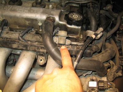

Fuel pressure is 50 at cranking, then it levels off at 40... how about the fuel damper?? is right on the fuel rail before the injectors... could this be the problem? look at picture.. any suggestions?? thanks

  • 75,992 POSTS
If the engine can start check the pressure with and w/o the fuel pressure regulator. Also inspect the vacuum hose for vacuum and if gas is present in the vacuum hose FPR defective.

It would be hard to remove the fuel pressure regulator because is with the fuel pump, and I'm getting 50lbs pressure, so is with in specs. What I decided to do is to remove the fuel pressure resonator the one on the picture and cap the hole with a cork and tie wrap. Crancked the engine and Wooam, the car started. Total cost of my troubleshooting.
