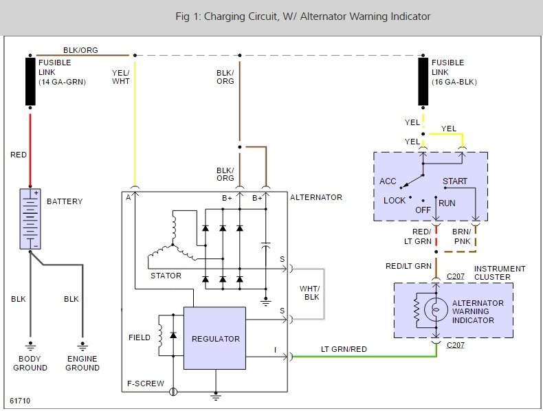

Positive post touched hood and killed the engine. Now it will not start. I do not hear the fuel pump kick in when I turn key. Any help appreciated.

Check them fuses first.
I am banking on it being a fusible link.

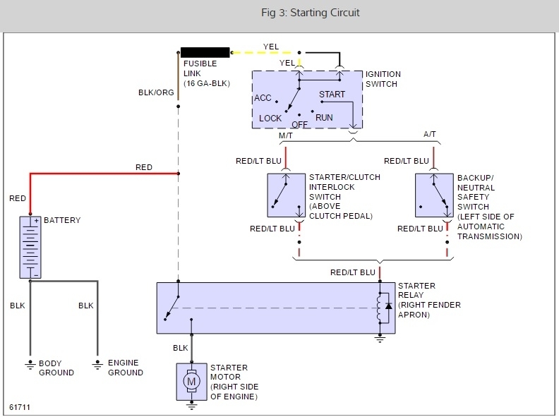

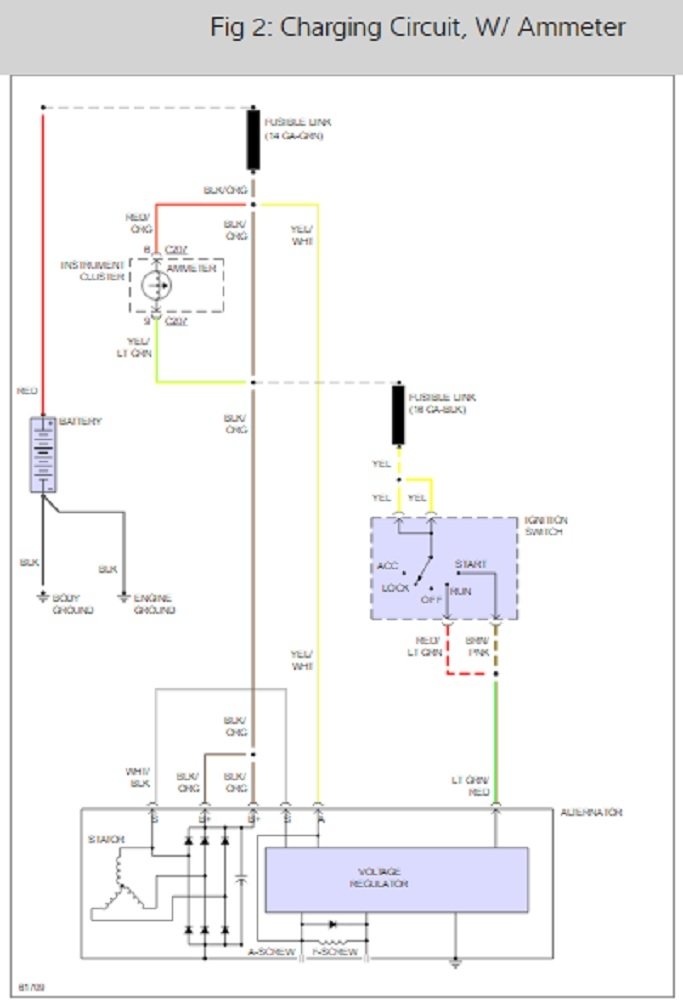

Got you two diagrams from "Prodemand" to use
Actually there are three.
Read the tops of them and rule out the one that does not apply to you set-up
The fusible links are black.
They have information about their size/ load capacity beside them.
Do not "rig" something in place of them.
They are the last defense in keeping your wire harnesses from, at worse, flaming up!
I have seen a few vehicles burn to the ground due to what seemed to be a just a few wires smoking to begin with.
Replace fuses/ fusible links with the proper equivalent part.
Always replace a fusible link with another fusible link of the same amps.
Nothing like watching your vehicle burn to the ground cause you cheated. If it is in the garage, you might be looking for another place to live.
