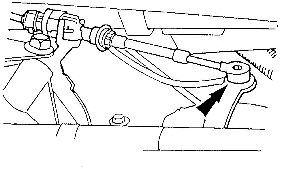

My truck goes into reverse fine but no drive gear and O/D light wont come on.

I will assume that the transmission fluid is clean and full. If it hasn't been checked, start with that.
The first thing we need to confirm is that the shift cable is properly adjusted and not preventing the vehicle from shifting into drive.
Here are directions for how to adjust the cable. I am adding this because I need you to confirm that it is all together and moving correctly. There is a mount on the side of the transmission that secures the cable harness. If it came apart, you may only be able to get reverse. The attached pictures correlate with the directions.
Take a look through this and let me know what you find.

1. Place the gearshift lever in the (D) position and hang a 3.6 kg (8 lbs.) weight on the gearshift lever.
2. Raise and support the vehicle.
pic 1

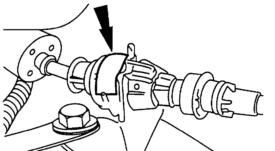

3. Disconnect the transmission shift cable from the manual control lever.
pic 2

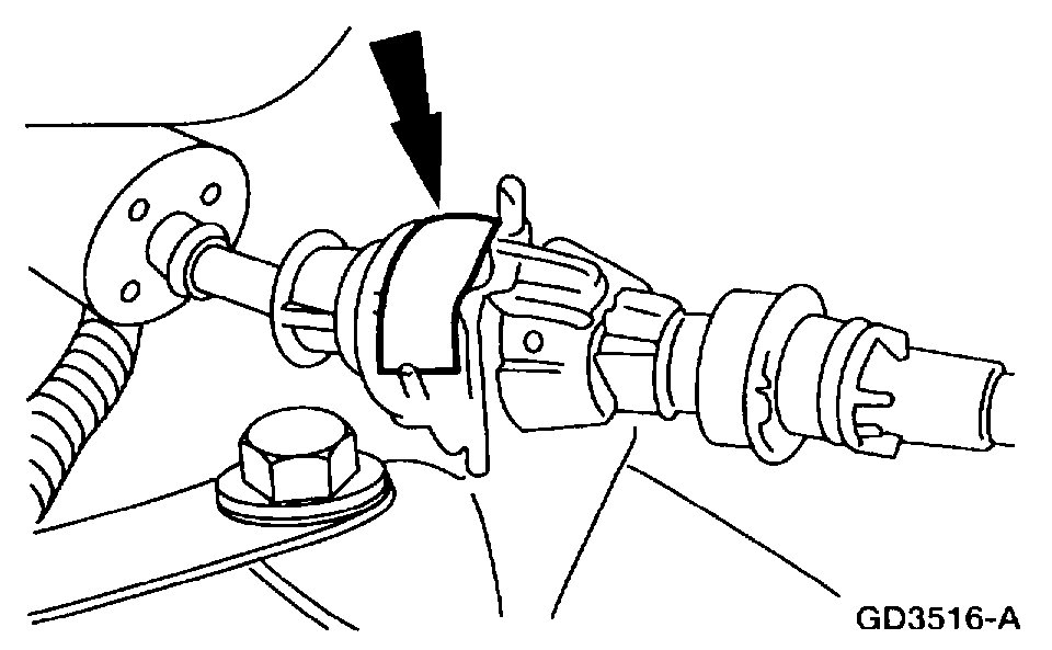

4. Pull out the transmission shift cable adjustment lock tab on the shift cable body.
pic 3

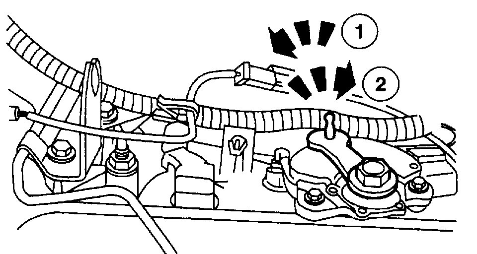

5. Place the manual control lever in the (D) Position.
1 Place the manual control lever in the first gear position. Rotate the manual control lever forward until travel stops.
2 Move the manual control lever back two detents to the (D) position.
pic 4

Next, this vehicle has what is called a digital range sensor. When you shift into drive or any gear other than reverse, is the gear indicator showing the correct gear?
