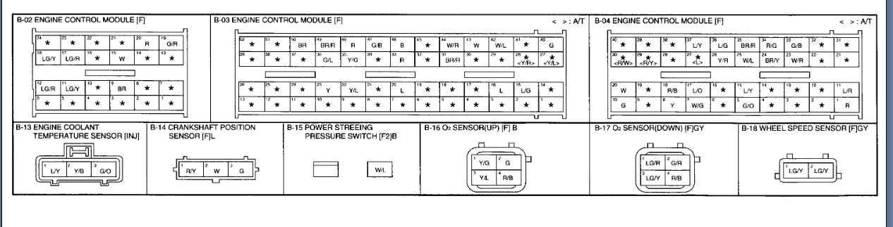

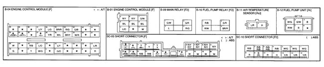

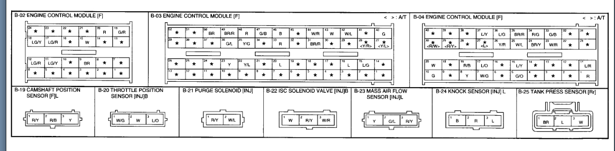

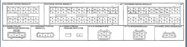

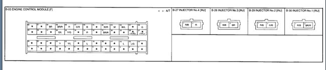

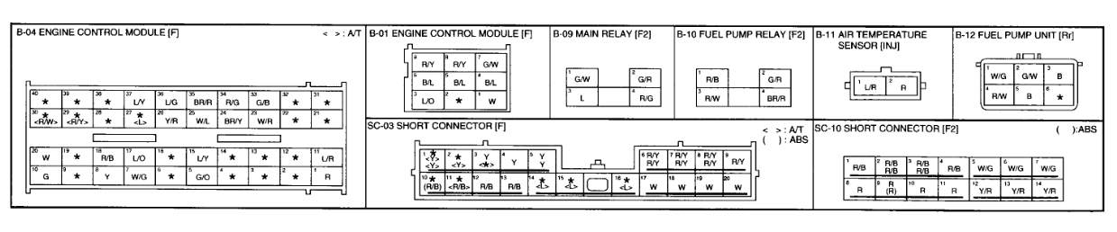

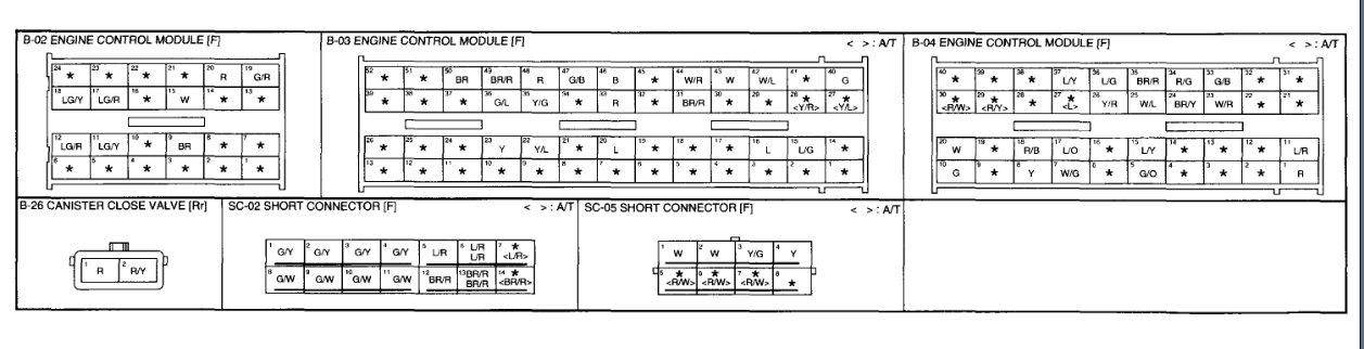

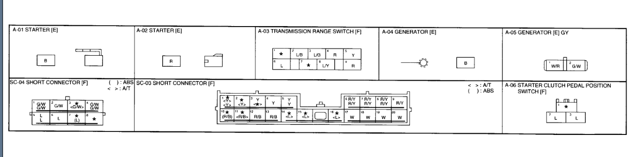

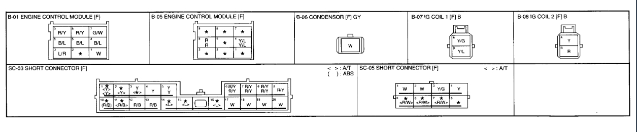

SCGRANTURISMO
  • 4,897 POSTS
Please double check to make sure that all electrical connectors are plugged in. Specifically check the crankshaft and camshaft position sensor electrical connectors. In the diagrams down below I have included a list of all the engine management connectors for your vehicle. Please go through the guide and get back to us with what you are able to find out. We can go from there.
Thanks,
Alex
2CarPros
