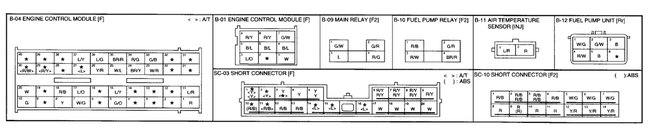

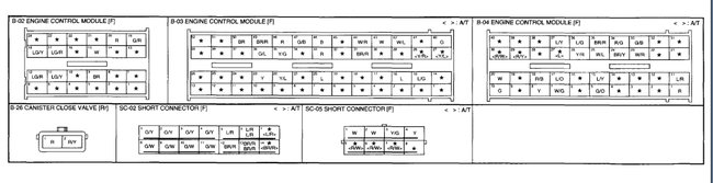

When the ignition key is turned on, the check engine light does not appear, the engine cranks but does not start.
Aug 1, 2020 at 4:54 PM
PACIFICISLANDER
  • 239 POSTS
This sounds like a fuel pump or the crankshaft angle sensor has gone out. When you turn the key to the on position without cranking the engine over can you hear the fuel pump run in the tank for 5 seconds?
Aug 1, 2020 at 5:48 PM

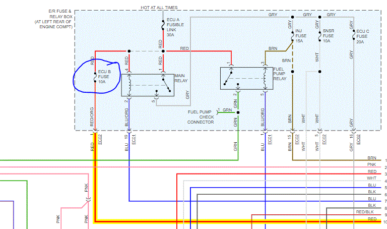

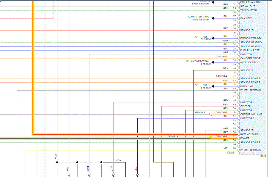

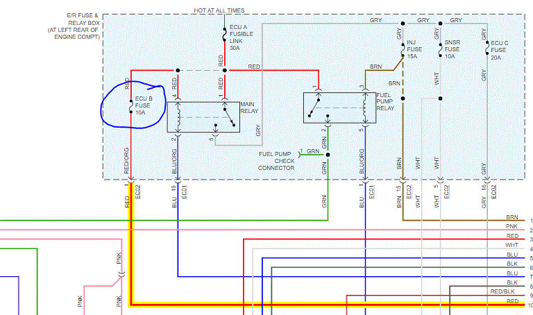

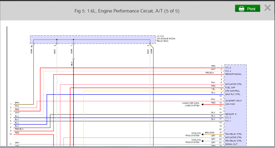

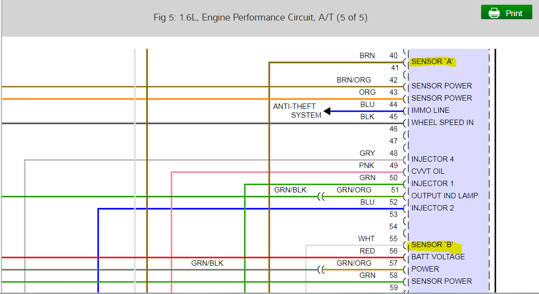

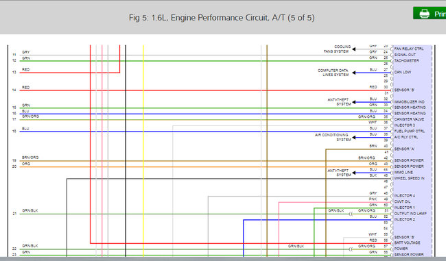

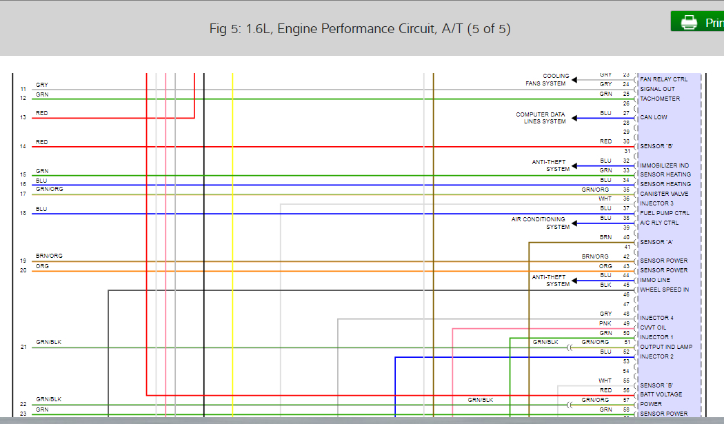

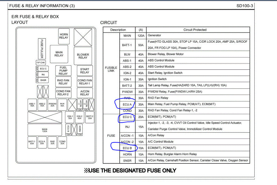

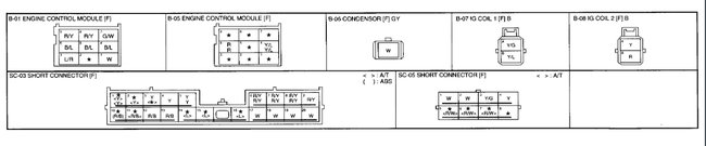

Good morning,
The guide is a good start but if the check engine light does not come on, it could either be the ECM or a blown fuse.
I attached the diagram of the powers to the ECM. I also attached the fuse box diagram and the fuses to test for power.
Aug 2, 2020 at 1:14 AM
FREDO SARMIENTO HABON
Thank you very much for the responses. Would like to ask again.. car cranks and starts normally only when the positive battery is disconnected and reconnected and the CEL appears and goes off at once when car had started. God bless!
Aug 4, 2020 at 4:43 PM
Okay, first, never remove the positive cable. The negative cable is always the first one off and the last one on. The arc from the positive can damage modules from a voltage surge.
In your case, you may have an ECM issue and this could have contributed to that failure.
I need the code when the light comes on. That will give me a direction of the area of failure.
I would also check for fuel pressure and spark when it does not start.
Can you hear the fuel pump run when it does not start?

TYLER SCHAFER
it was the crank shaft sensor btw thank for your help. I love this site.

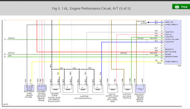

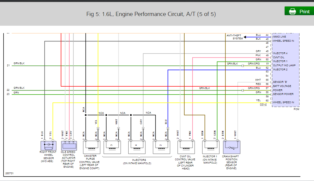

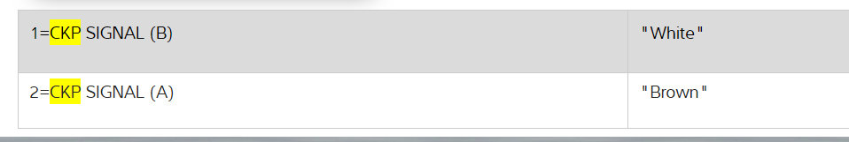

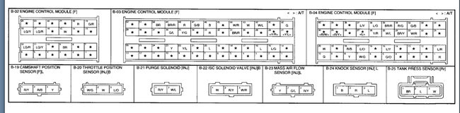

This could be a problem with your vehicle's Crankshaft Position sensor (CKP). Your vehicle's CKP is responsible for keeping track of the number one cylinder. More specifically when the number one piston is at Top Dead Center (TDC) of the compression stroke. It does this by reading a toothed wheel that is attached to the crankshaft. It has a missing tooth that passes by the sensor when number one piston is at TDC. By keeping track of number one piston it can also keep track of where the rest of the engine is at in it's four stroke cycle. The Power-train Control Module (PCM) a.k.a."computer" uses this information to send sparks to the spark plugs and when to open fuel injectors. If there is no signal from the CKP the engine will have no spark or fuel injector duty cycle and it will not start. I have included a few links down below for you to go to:
https://www.2carpros.com/articles/how-a-crank-shaft-angle-sensor-works
I have also included a CKP location picture in the diagrams down below. Please go through these guides and get back to us with what you find out.

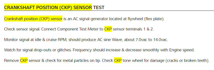

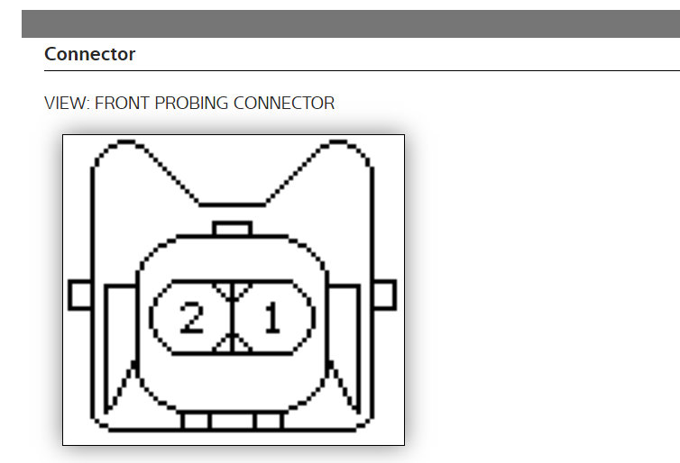

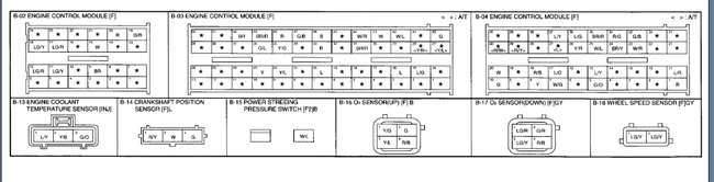

Okay, lets make sure that the signal is getting to the PCM. This is going to require you to use a multi-meter. If you are not familiar with how to use one I have included a link below.
Okay, can you please double check the connector for the CKP sensor. Make sure that it not damaged, clean, and making good connections to the pins when connected. Next we are going to have check to make sure that the signal is getting to the PCM. A couple of things that will make this a lot easier to do is a couple of safety pins, and a couple of long jumper wires with alligator clips attached to both ends.
Pierce both the wires coming from the CKP connector a couple of inches from the connector with a safety pin. I pin, one wire. Clip a jumper wire to each of the safety pins securely. Attach the other ends of the jumper wires to a lead from the multi-meter. red test lead should hook up to brown wire, black to white wire. Turn your multi-meter to AC Voltage. Have an assistant crank the vehicle. Watch the multi-meter. You should get a reading from 7 volts - 14 volts.
I have included some information for you in the diagrams below as well. Please get back to us with what you find out please.

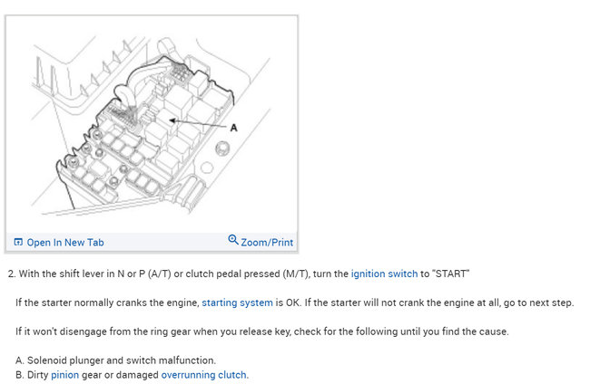

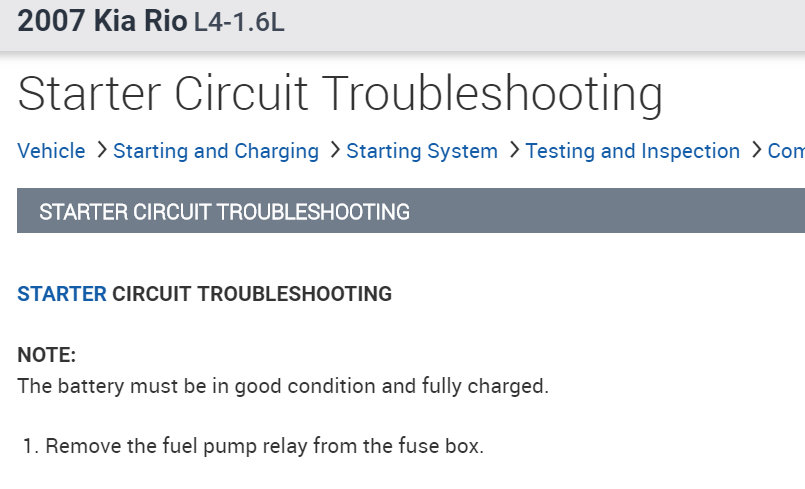

SCGRANTURISMO
  • 4,897 POSTS

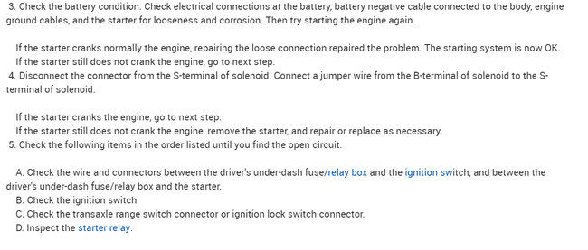

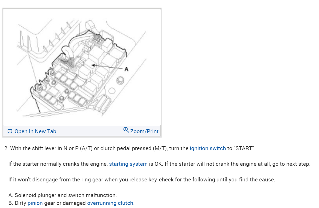

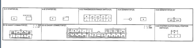

This could be a problem with your ignition system. I have included a few links below for you to go through. I have also included vehicle specific troubleshooting for the starting system as well in the diagrams below. Let us know what you find out.

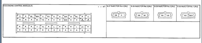

Are you getting a pulse to the fuel injectors? I'm assuming you've already checked the fuel pressure at the fuel rail.
Feb 1, 2021 at 3:49 AM (Merged)
GENO1966
No I have not checked fuel pressure but when you take the plugs out they are soaked and I can get #3 cylieder to fire. Do not understand what fuel pulse is?
JAMES W.
  • 2,394 POSTS
Pulse s the signal from the ECM that fires the injectors. You can check this with an ordinary incandescent test light between the 2 terminals of any injector connector while cranking. Are you sure your plugs aren't wet and fouled??

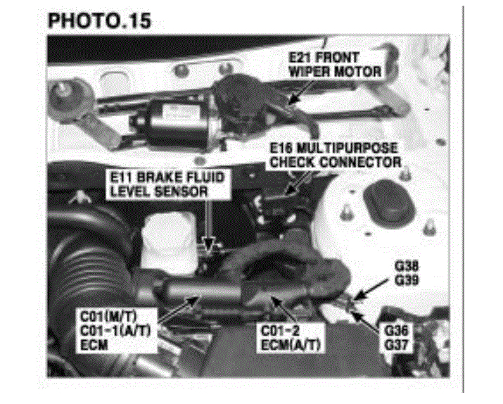

STEVE W.
  • 15,349 POSTS
That is because there are multiple items that could be unplugged and cause it to not run.
I would look around for a disconnected wire, the fastest one would be the coil wire in the center of the distributor cap.
The picture should be the same engine with a Mazda valve cover. The items I marked are easy to pull and would stop it from running. The two on the right are the coil and distributor feeds. Those will make it crank and not run. The others are ones that will let it run but run like junk.
If you could take some pictures and load them here it might be better and faster.
