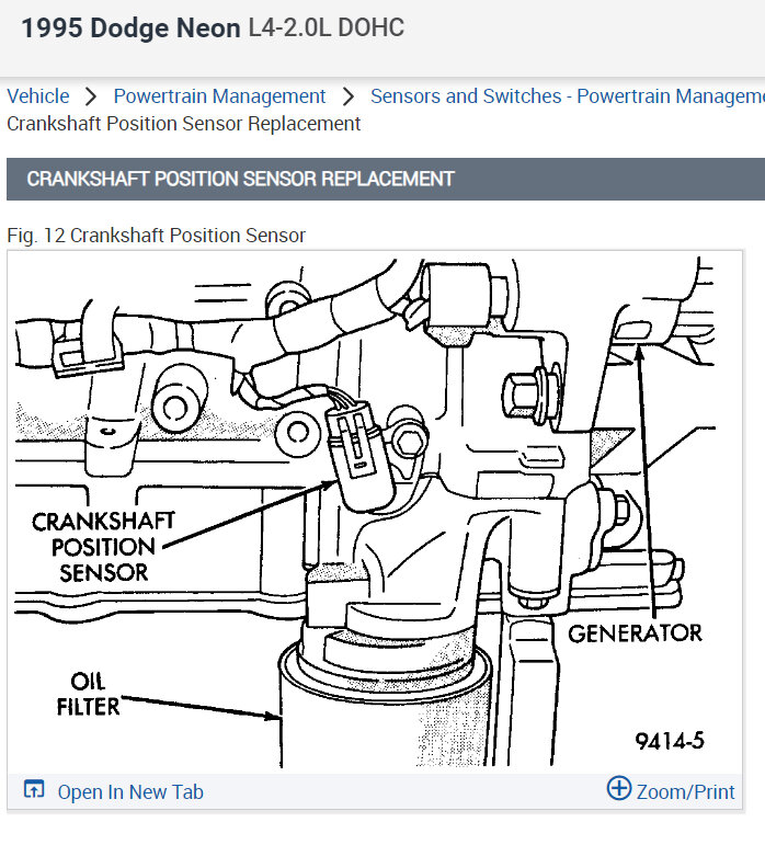

I have a 95 dodge neon 2.9 doc. The other day on the way to work it just stoped running. I was like I had just truned off the key. So I pulled over to the side of the road and tryed to start it back up and it would turn over but it would not start. I had to turn the key all the way off and then back on before it would start again. I went about 5 miles and it did the same thing. But this time every time it started it would go about 2 feet and then just shut off. And now I can not get it to start at all. I have replaced the fuel pump the fuel fillter and the fuel pump realy. I have checked the fuel pump fuse but still nothing. I have tested the fuel pump and it only works when you directly wire it to the battery. What could be the problem I am at a loss? Please help!

Was the car giving you any codes or did you have it fixed. What was the problem by the way?

Yep, we had this car in the shop the other day and had to replace the crankshaft angle sensor, here is the location so you can change it out to help fix the problem. Check out the images (below). Please let us know what happens.
