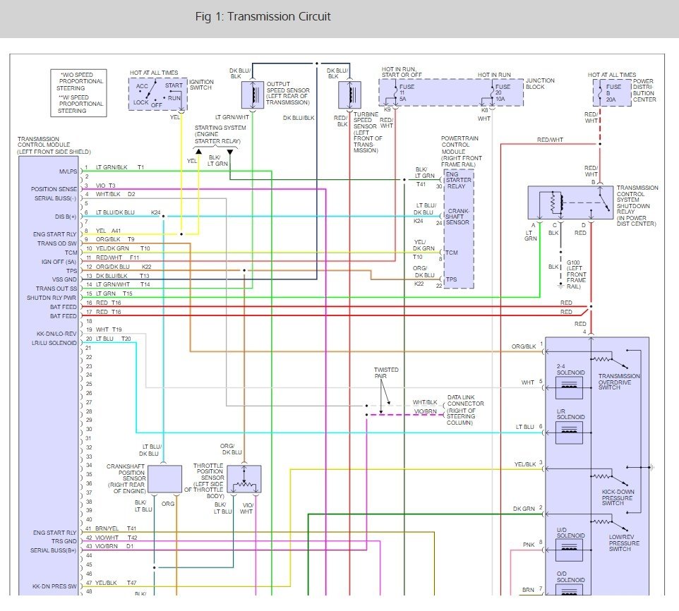

Seems I asked the wrong question, so my husband said, what happens is the car goes into overdrive and then stalls (drops down into 2 ND gear and want shift back up ), he drops it in neutral, coast to 45 mph, then restarts it up to pick backup speed, it also doesn't want to crank when he first starts it up, like it's not getting enough fuel, has to turn it over 4 or 5 times, before it cranks, if the fuel pump (which is in the trunk) isn't sealed down completely (I know it's hard to get it to go in place)could that cause it to not run correctly?And half dash lights have went out so don't know if it's showing a check engine light or any thing, Thanks

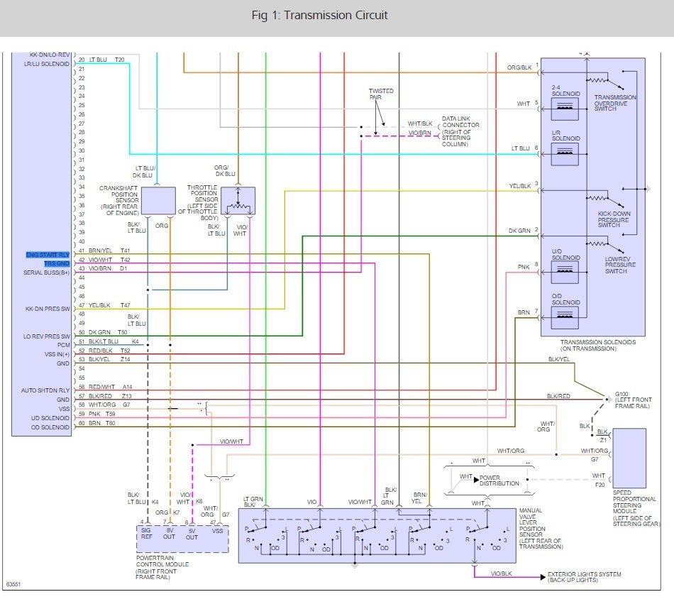

If I can offer my two cents. It sounds like it could be a overdrive transmission solenoid that has shorted causing the computer to shut down. The computer cools and then it starts working again.
Here is a wiring diagram so you can do some checking. Use a volt meter and check the resistance of all solenoids to see if one is shorted, here is a guide to help you too.
Please run some tests and get back to us so we can continue helping you.
