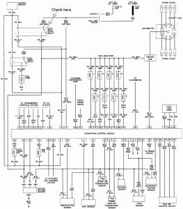

The coil on my 99 dakota is getting no power and I can't figure out why all my relays and fuses same like they are good but still I can get any power to my coil to get my truck to fire

Explain no kind of power to the coil. 12v or no spark out of the coil? And how do you know, have you tested it with a meter?

A Dodge Dakota SRT 1997 96,000 miles with no power leading into the coil where I should have 12 volts I get 0.005 on my multimeter

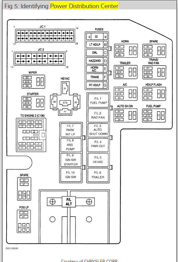

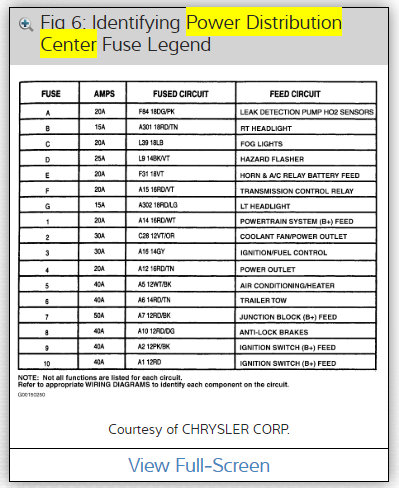

Power to your coil comes directly from your SBEC )single board engine controller). It could be an auto shutdown relay. Check the voltage on the dark blue wire of you alternator with the key on. Here is the location in the diagrams below. Let me know

I dont have dark blue wire going to my alternator I have dark green and dark green with black both showed zero
+3
Friday, May 19th, 2006 AT 11:45 AM
LOSONE
  • 1,616 POSTS
Sounds like the auto shut down relay isn't on. It is also turned on by the SBEC. Either it is bad or the SBEC. It is in the engine compartment and with a breather hose running to it. It also houses the voltage regulator and is a high failure item. Good luck
+1
Friday, May 19th, 2006 AT 5:40 PM
COLTY045
Are you talking about the auto shutdown relay I wished I replaced it earlier because that was the problem running great once again!
