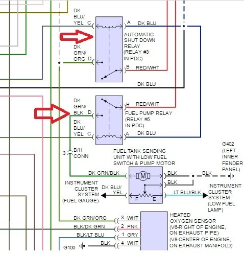

Ran when I parked it. Then it sat for two months now the thing will not start its got good spark but fuel pump and injectors not working. Fuel pump does not sound off when I turn it over. I did hot wire the fuel pump just to make sure it worked and it did but after cranking the engine over and over my spark plugs still bone dry any suggestions would be greatly appreciated.

Here's what I came up with:
Check Fuse D (30A) and Fuse C (40 A) in the power distribution center (PDC)
Also check these two relays in the "Prodemand" diagram I'm posting below.
Return with a grin!
The Medic

I had very similar issues; changed the crankshaft sensor and was good to go! Best luck to you
