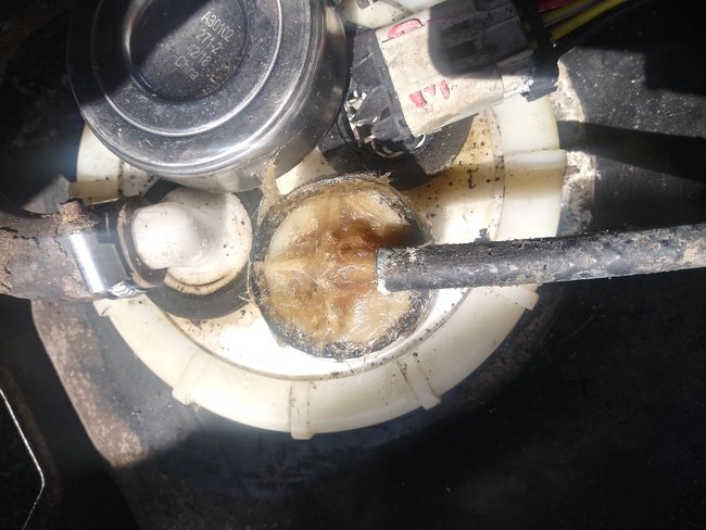

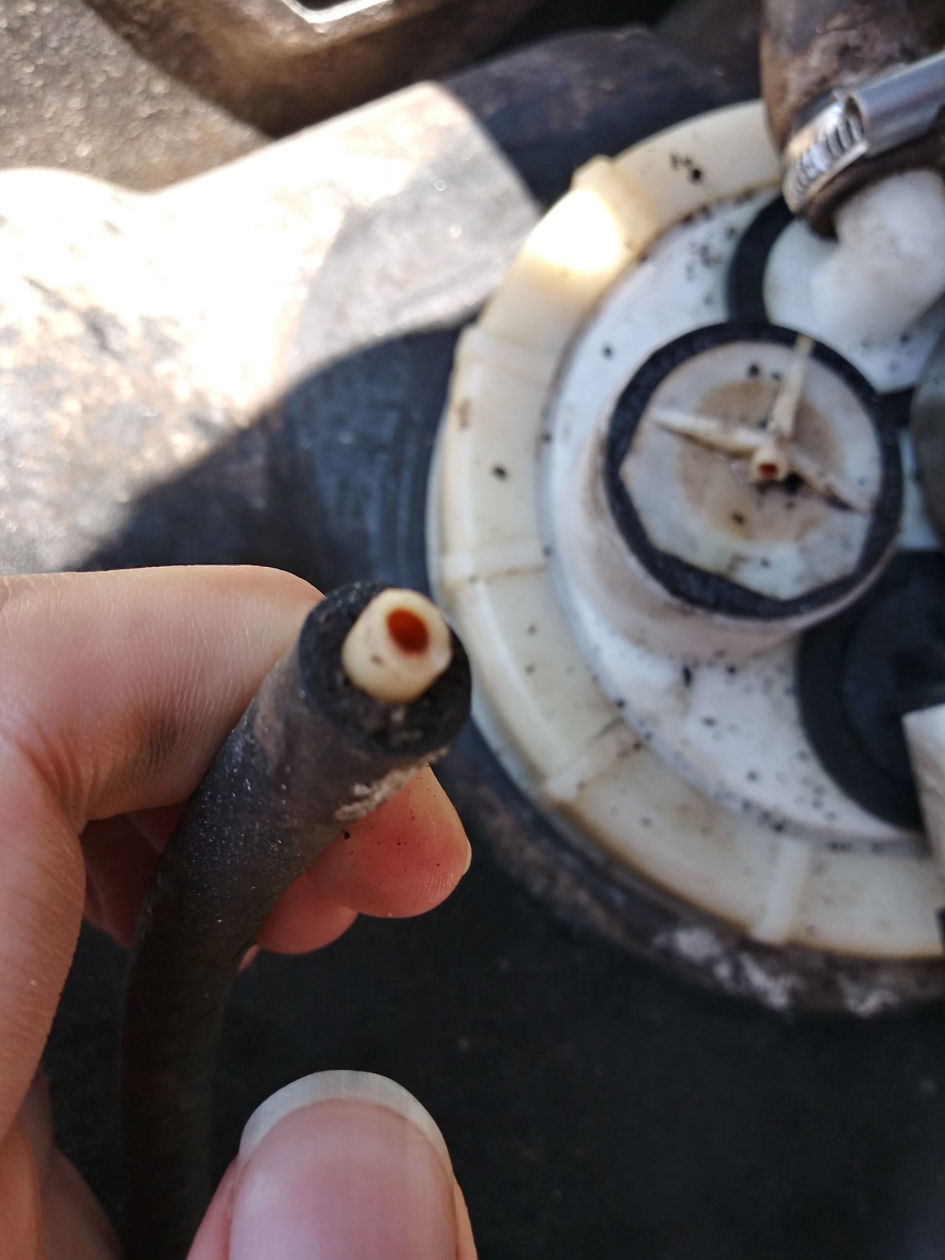

I recently replaced the fuel pump assembly and things were fine until horrible road conditions. Truck refused to start, no fuel pressure.
Anyway, the spout on the rollover valve had broken off in the pressure tube, too close to the valve to rig it. I'm trying to find a compatible substitute because nobody makes it and the local car cannibal lot has nothing.

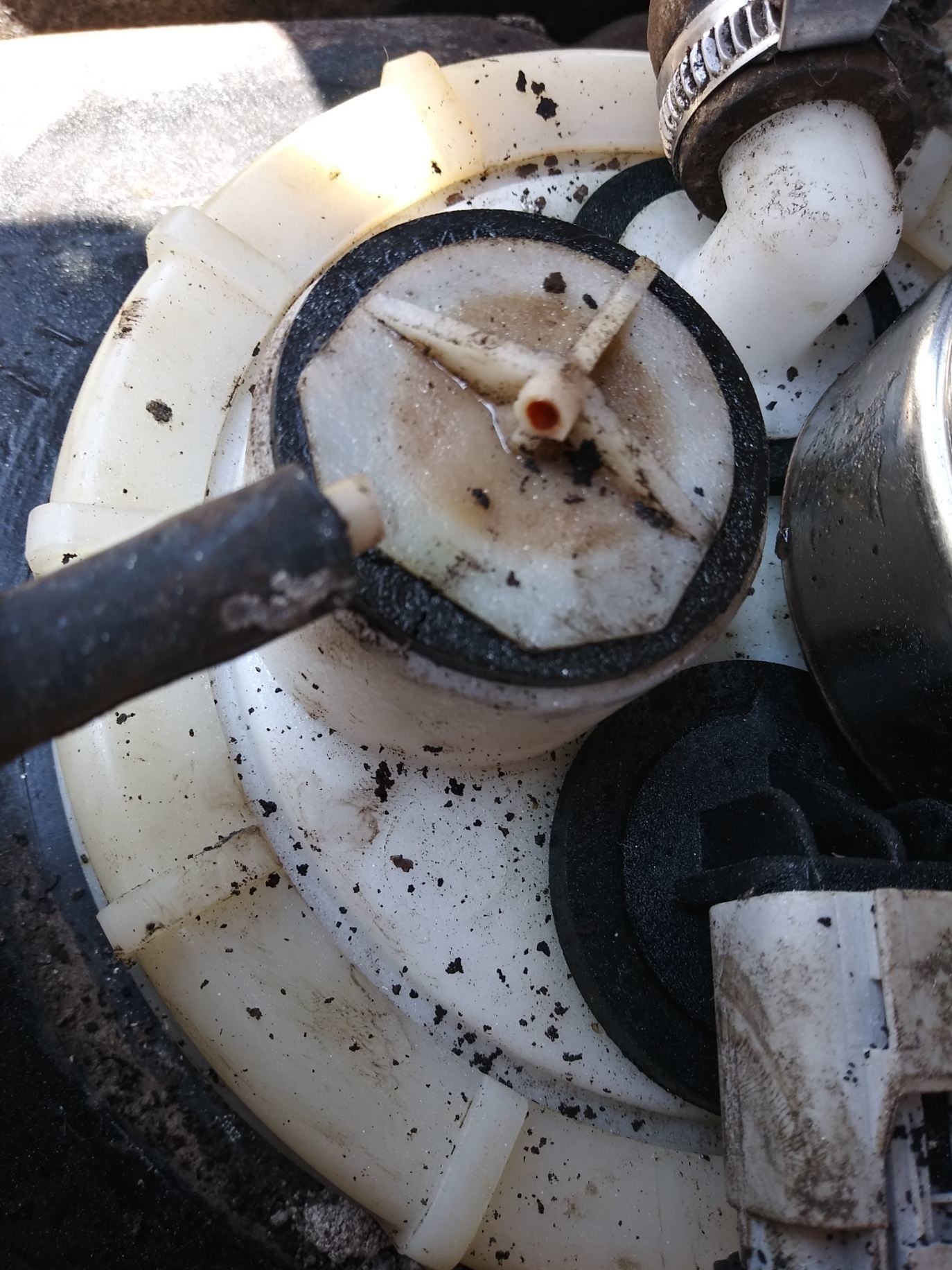

POOPYRYA
  • 17 POSTS
Got the piece out but the stump on the valve housing is so short i've been defeated.
I don't know how long ago was posted, but my brother found a forum stating that part number 911-001 is all I needed. Of course the parts site says it won't fit. But that's why I thought JCD should have at least a few shared parts, but I can't find a definitive answer yet.
Any more advice would be appreciated beyond my vocabulary to express.
Aug 18, 2019 at 6:08 AM (Merged)

  • 55,711 POSTS
I have seen people drill out the plastic and install a small pipe thread fitting to attach the rubber hose to. Does that part come with a new fuel pump module? Check out the diagrams (below). Please let us know what happens.

POOPYRYA
  • 17 POSTS
I'm not sure which part is the module. I ended up reaming the plastic and inserting a 1/8" roll pin, fiber glassed the top together and put the hose back on. I was lucky to save the nipple part that broke off in the first place. It is not pretty but it worked.

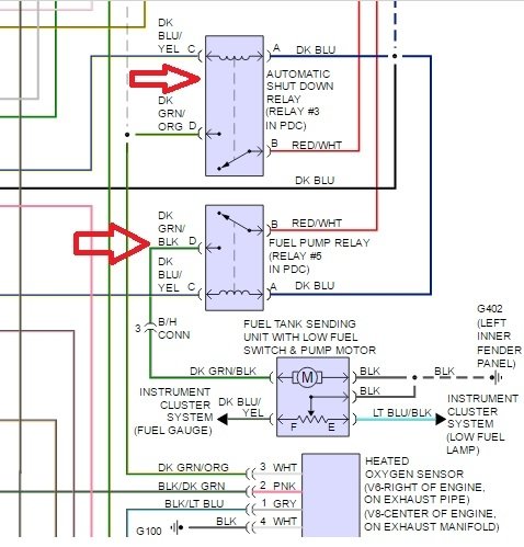

CJ MEDEVAC
  • 11,000 POSTS
Here's what I came up with:
Check Fuse D (30A) and Fuse C (40 A) in the power distribution center (PDC)
Also check these two relays in the "Prodemand" diagram I'm posting below.
Return with a grin!
The Medic
