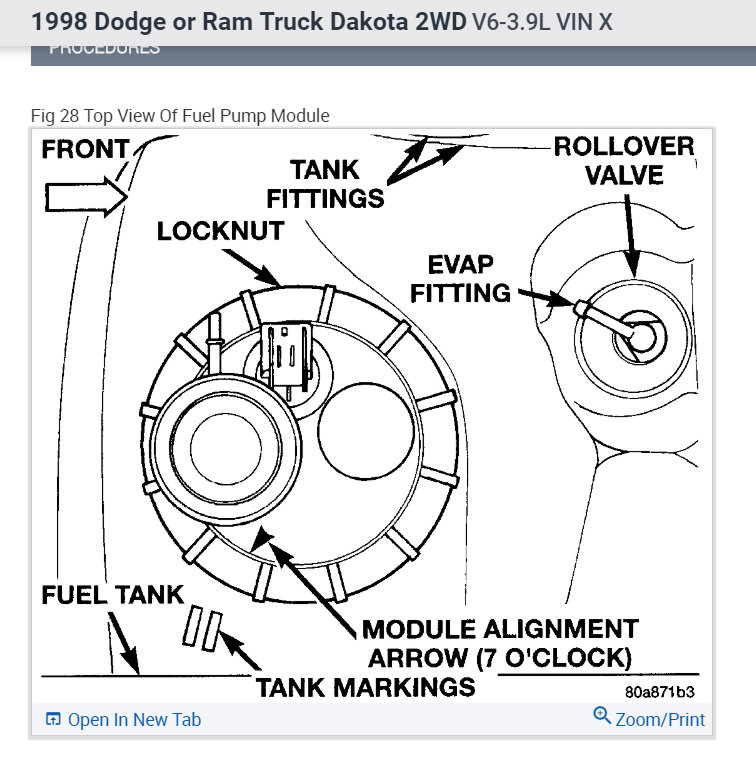

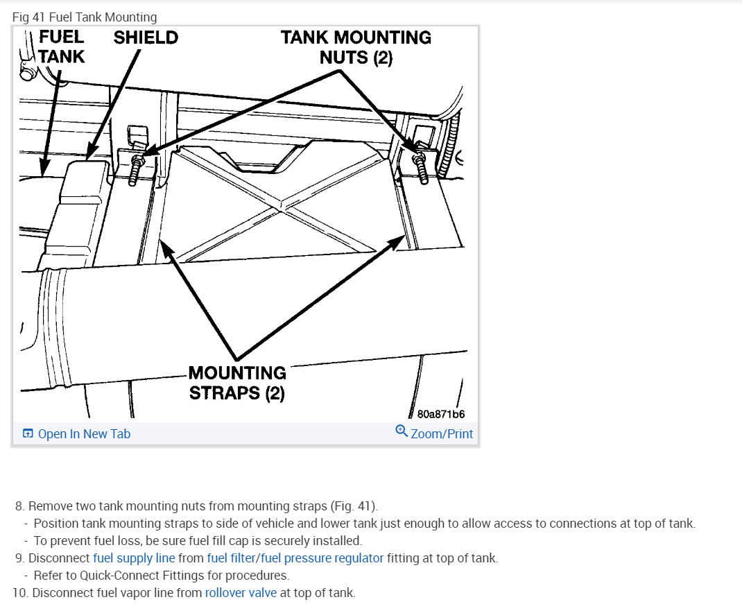

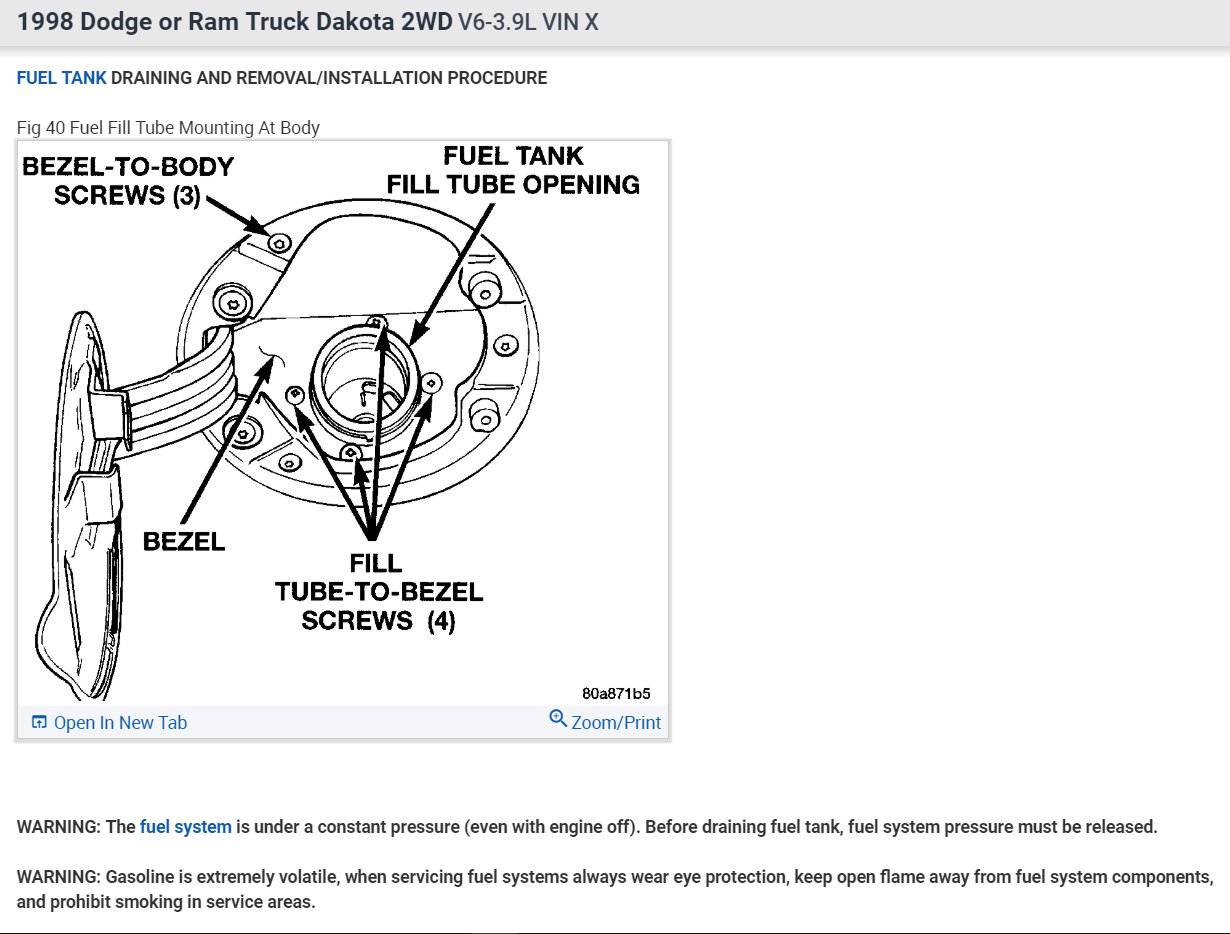

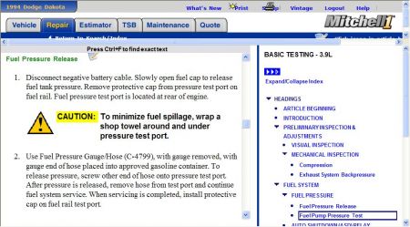

I recently ran it out of gas and ever since it seems to have noticeably less power. I really doubt the pump needs replacing but since the only fuel filter is on the end of the pump, I need to know how to get it out. Maybe remove the bed?
Nov 27, 2007 at 12:36 PM
BLACKOP555
  • 10,386 POSTS

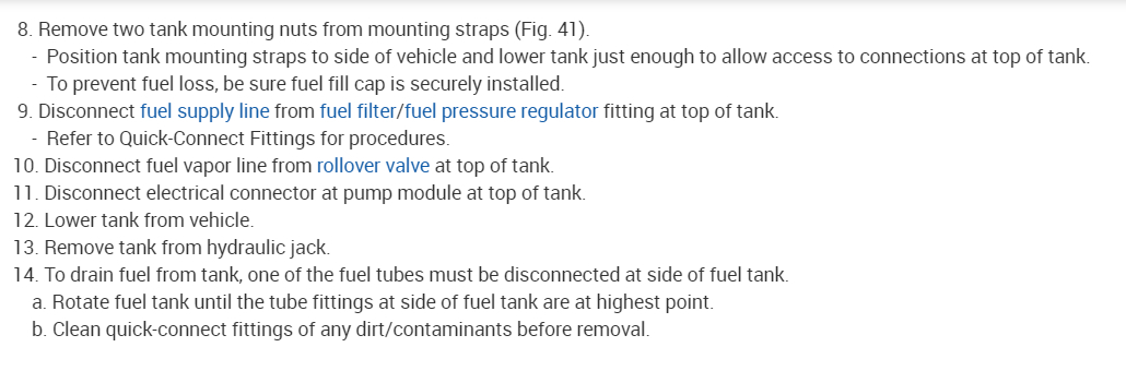

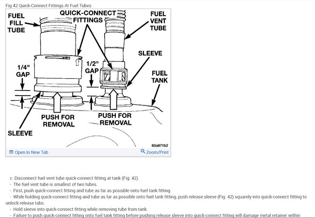

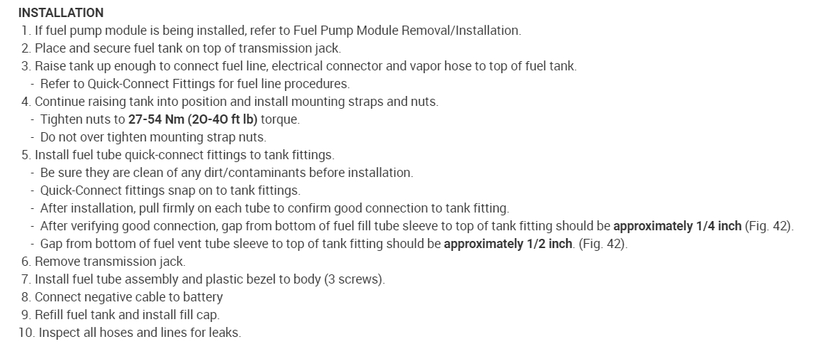

running pumps down that low with no gas to cool them is a sure fire way to ruin a pump, especially one over 100k miles. replace the fuel filter inline between the tank and the engine first, if nothing then drop the tank and you can choose to change the fuel pump filter or replace the pump. Here is a guide to help walk you through the repair with diagrams below to show you how on your car. I have also included a video on how to drain the gas out.
https://www.2carpros.com/articles/how-to-replace-an-electric-fuel-pump
and
https://youtu.be/Q5MH2gnyFH0

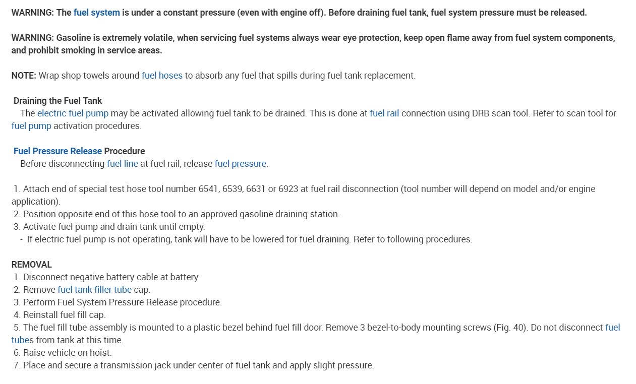

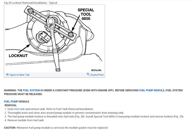

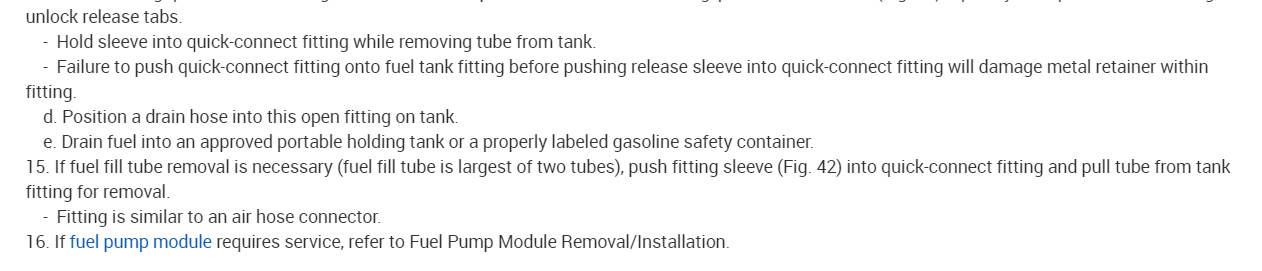

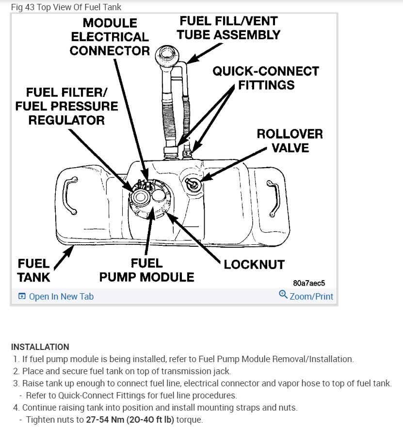

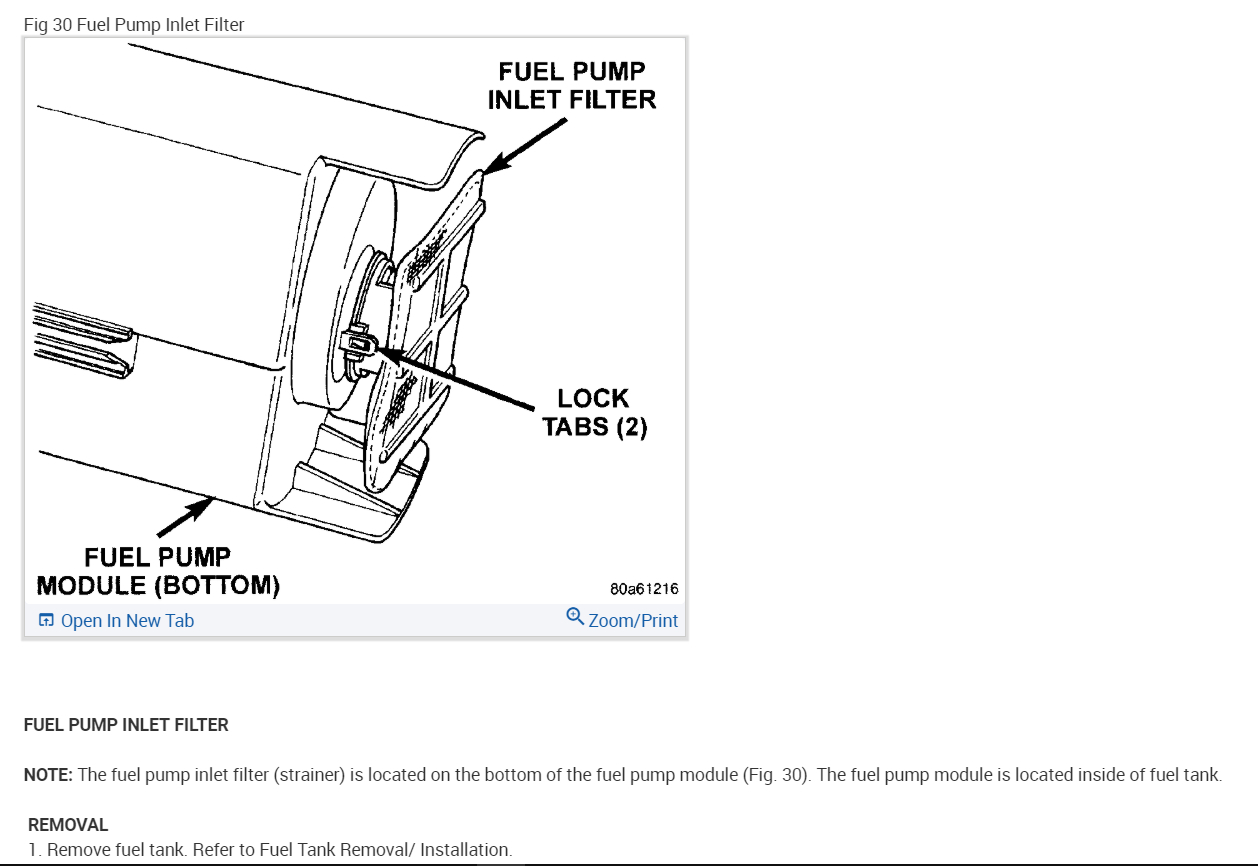

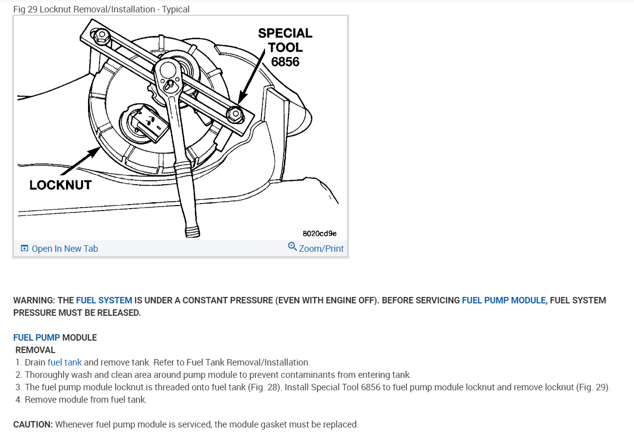

REMOVAL:
Depressurize the fuel system.
Drain the fuel tank.
Remove the fuel tank from the vehicle.
Disconnect any lines that may remain attached to the pump.
Thoroughly clean the area around the pump so that foreign matter won't fall into the tank when the unit is removed.
Check the top of the pump for arrows or alignment marks. Check for corresponding marks on the tank itself. Alignment of the pump is important for routing of wiring and lines. Matchmark the pump and tank as reference for assembly.
If the pump is equipped with "fingers" and "finger locks", apply some lubricant to the assembly.
Remove the pump locknut. Some units are fitted with a lock tab. Pry it back while removing the locknut.

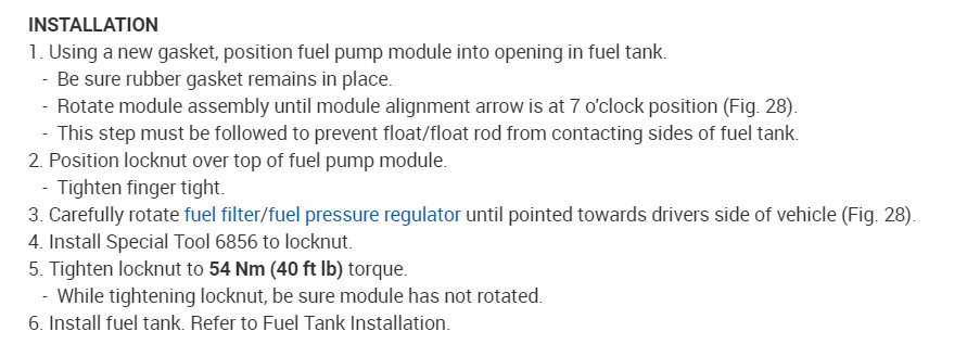

INSTALLATION:
Clean the filter at the bottom of the module.
Reverse the removal procedure.
Use a new gasket.
Align pump and tank marks to ensure correct routing of wires and lines.
If the locknut is the type without fingers and finger locks, tighten the nut to 40 ft. lbs. (54 Nm).

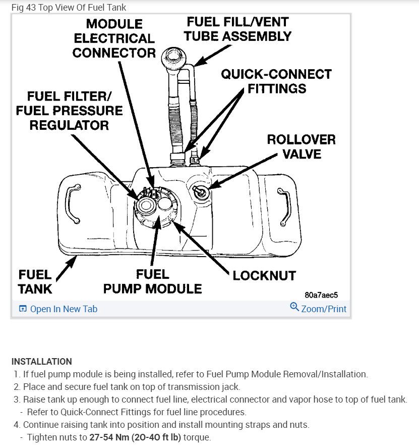

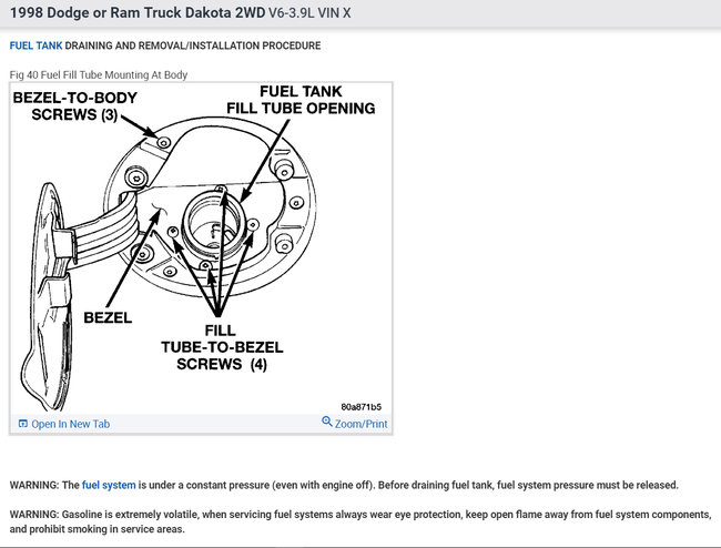

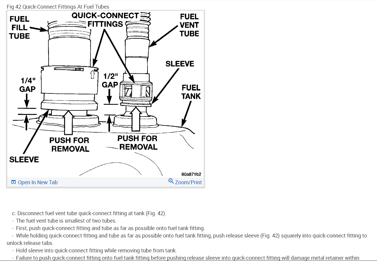

  • 110,244 POSTS
The pump is in the fuel tank. The easiest way to replace it that I have found is to actually remove the truck bed. There are 8 bolts that hold it on (which should come out easily) and then just disconnect the wiring to the rear tail lights and the filler tube at the fill location (3 screws I think). Have a friend help you lift it off and you have full access. Because I've done them before, it takes me about half an hour to complete. Otherwise, you will be dealing with the rusted fuel tank straps that always seem to break, trying to muscle out the tank, and then praying that the plastic tank doesn't crack when you tighten it back into place.
Let me know if you have questions.

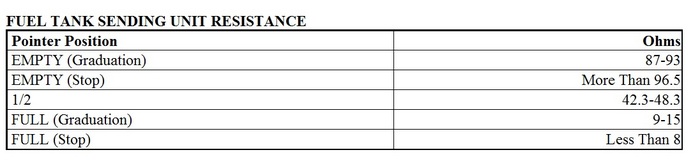

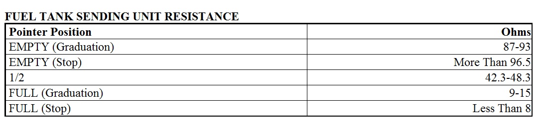

fuel gage stuck on 3/4 tank on 1995 dodge dakota( replaced fuel pump& panel)
Aug 17, 2019 at 5:39 AM (Merged)
JDL
  • 16,098 POSTS

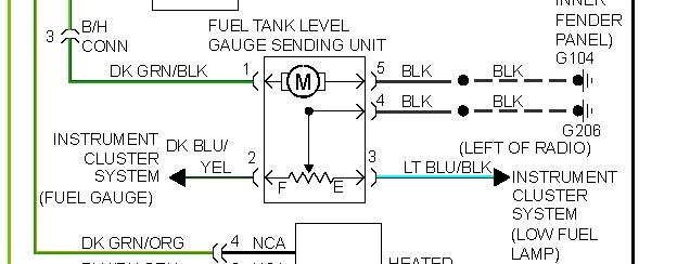

The wiring for the sending unit at the tank, take it loose, you can use different size resistor for full and empty, key on, see if gage reacts. I'll find the wiring diagram. You can get resistors at radioshack, doesn't cost much. Get a resistor close to ohms spec, if you want to test. Some people don't want no part of testing. That's up to you.
JDL
  • 16,098 POSTS
I don't know if you replaced the sending unit? With sending unit unplugged,key on, the gage should go to empty.
The wire colors for sending unit, one wire is yellow, the other wire is lite blue with black tracer. If you use resistor for full or empty, between those two terminals, key on, the gage should react.

  • 110,244 POSTS
Hi:
The fuel pump is in the fuel tank. From experience, the easyiest way to replace it is to remove the bed. There are 8 bolts holding it on, a couple wiring harnesses for the rear lights, and the filler tube which is attached by three screws. All you need is someone there to help you pick it up. Once it's off, you have full access to the top of the tank.
If you have any other questions, let me know.
NOTE: I recommend this way because fuel tank straps are usually rusted, and the tank is plastic and very easy to break when replacing it.
