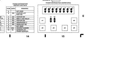

JDL
  • 16,098 POSTS
Hi, did you check the applicable fuses with a testlite? Even if the fuse is good, if no voltage on the circuit, the circxuit is dead. There is a fuse in the power distribution center, another in the regular fuse box, that has to do with ads and fuel pump relays. Fuse D in the power distribution center.
https://images.2carpros.com/forum/automotive_pictures/170934_dakota_1.jpg
Aug 26, 2019 at 11:21 AM (Merged)
MORENORAY
  • 6 POSTS
there is power fuses are good
JDL
  • 16,098 POSTS
I'd have to check voltage circuit at the fuel pump relay and asd relay. If no voltage when there should be, I'd have to track the circuit.
