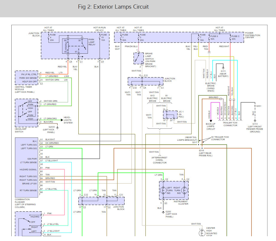

The turn lights work. The brake lights don't come on, on my truck or trailer. What and how do I check to identify and fix the problem?
Jan 24, 2008 at 10:19 AM
  • 75,988 POSTS
It sounds like the fuse #5 20 amp can be blown or the brake light switch is out here is a guide to help you test the fuse and a wiring diagrams to see where the power stops check the brake light switch first. Here is the brake light wiring daigrams below so you can see how the system works.
Check out the diagrams (Below). Please let us know what you find. We are interested to see what it is.

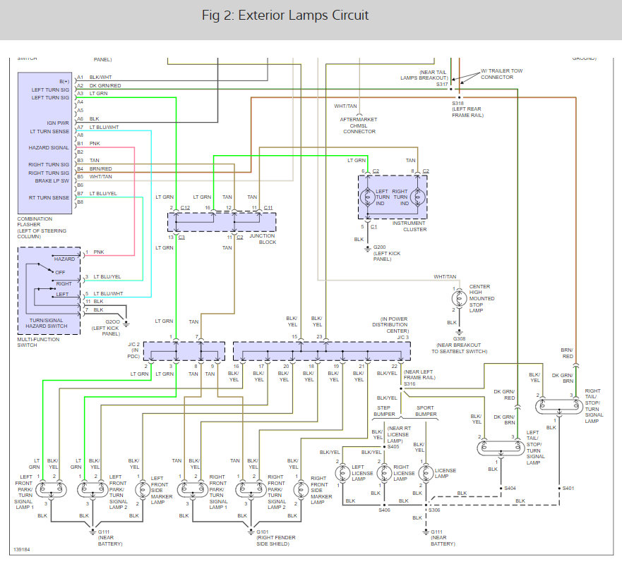

For the brake lights check and test the multifunction switch and for the reverse light check fuse no. 3 15amp and back lamp switch to include the ground circuit

Test the multi function switch the lower brake lights circuit goes thru there. The left brake is the dark green and red, right brake is the brown and red wire-

Its the turn/hazard switch-

Check the # 3, #5 and # 9 fuses (replace as necessary) then,
Check for power (12V) at the brake light sockets, when the brake pedal is depressed.
If no power there, check for 12v at the LT GRN wire at the "turn signal and Hazard light switch" when the brake pedal is depressed.
If no power there check for 12v at the WHT/TAN wire of the "turn signal and Hazard light switch" when the brake pedal is depressed. If there is still no power, suspect a faulty brake light switch.
If power exists at the WHT/TAN wire of the "turn signal and Hazard light switch," suspect a faulty "turn signal and Hazard light switch."

Did you check for voltage, anywhere? At the brake switch, pink wire with dark blue tracer is voltage, hot all the time. When the brake switch is activated the white wire becomes hot. You did check for voltage at the proper fuse?
The brakes lites are wired through the turn signal switch, they use the same bulb filament at the rear, just not at the same time.
