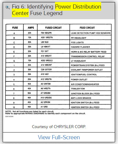

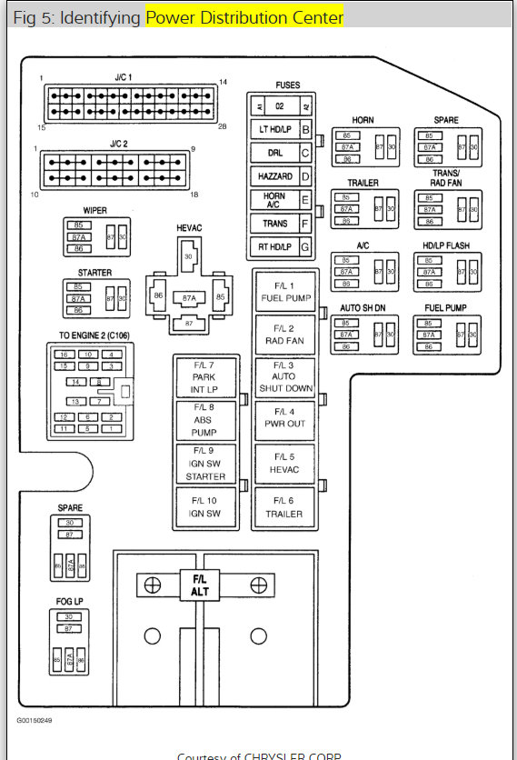

check under hood relay box fuses

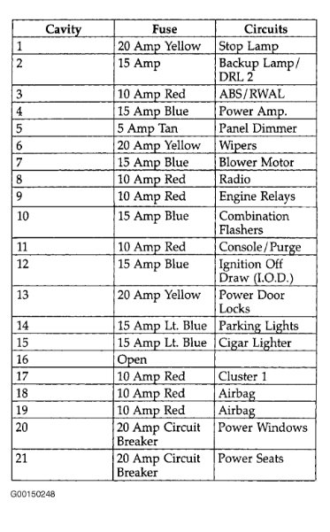

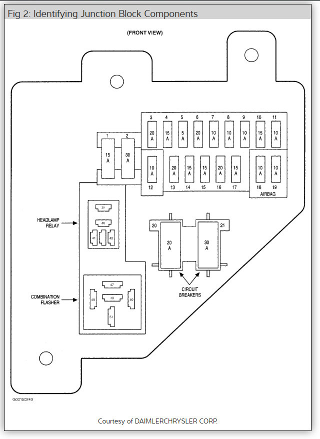

CAR-MAN145
  • 321 POSTS
The brake light Fuse #1 20 amp in the fuse panel here is a guide to help test the fuse and the fuse location below.
