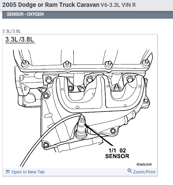

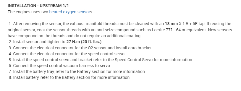

I was told that I have 3- O2 sensors, and that they need to be replaced. How do I do this and where are the located at?
Apr 8, 2009 at 3:16 PM
SQM
  • 6,383 POSTS

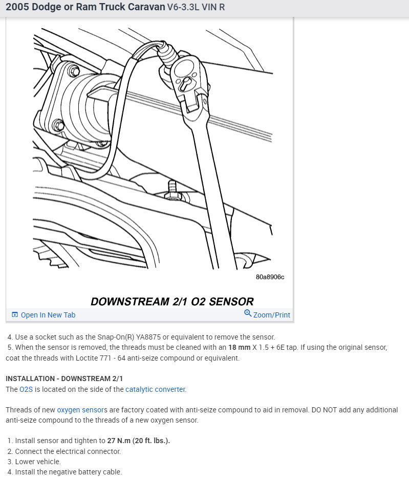

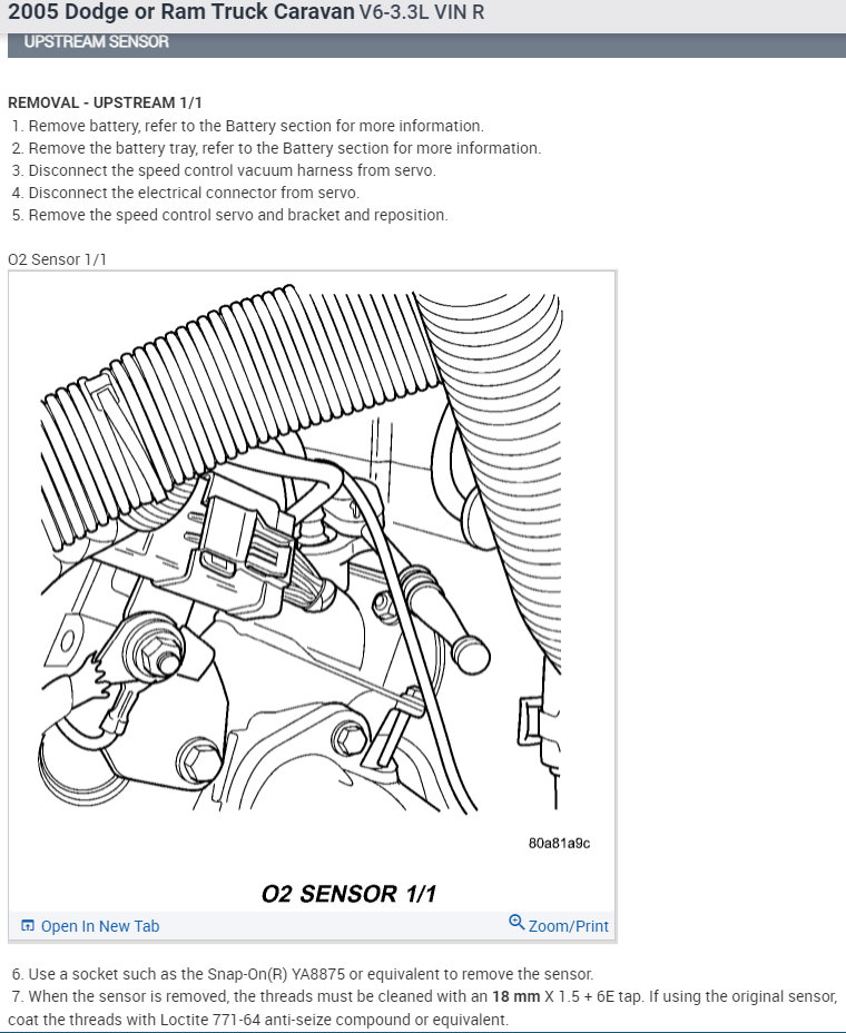

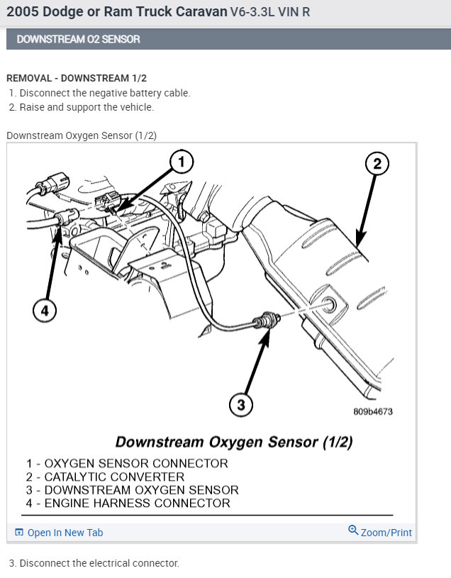

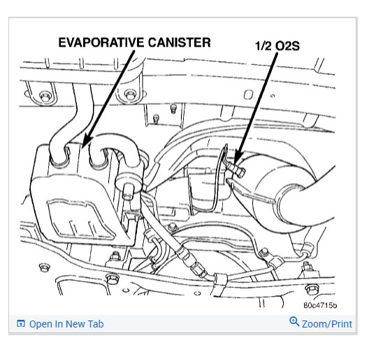

Of those 3 oxygen sensors, 2 of the located on each exhaust manifold and the third one after the catalytic converter under the vehicle on the exhaust pipe.

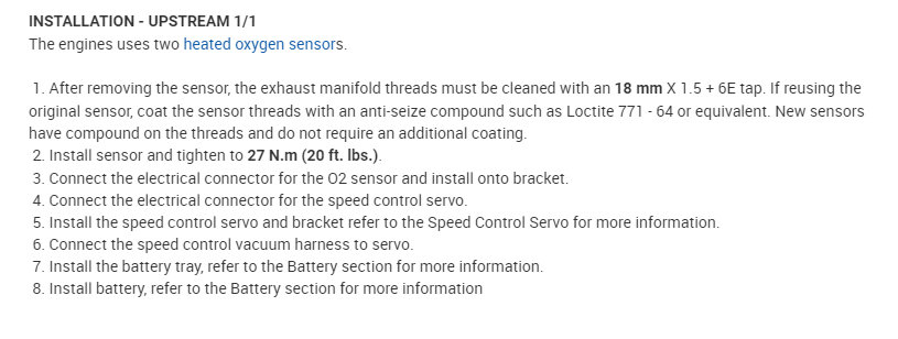

The oxygen sensors can be replaced easily. It is ideal to use a oxygen sensor socket with a wrench.
Keep in mind that the sensors have a tendency to be seized on the exhaust due to heat. It is a good idea to spray the base of the sensors with penetrating oil to help them loosen up.
Be sure that the engine is cool before getting started.
Here is a helpful article:
https://www.2carpros.com/articles/how-to-replace-an-oxygen-sensor
I have attached diagrams for each with the replacement procedure.
