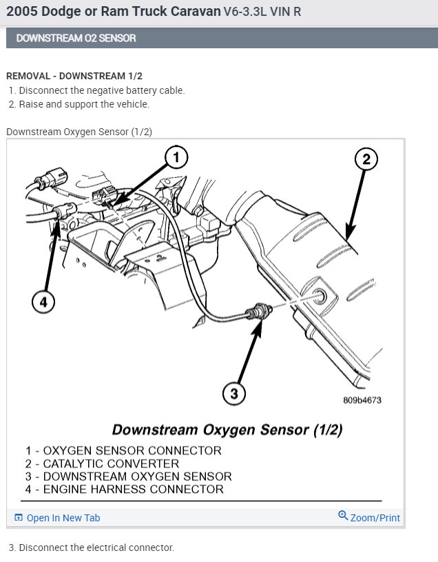

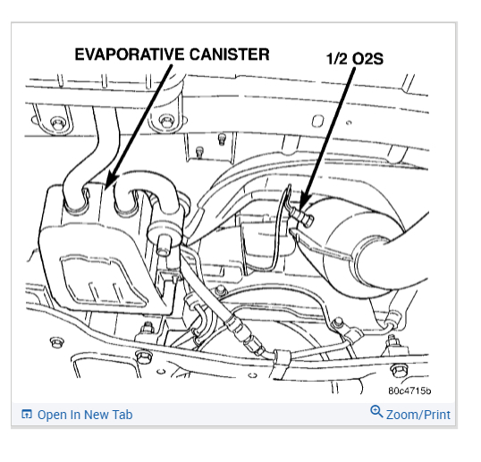

obd11 scanner says p0138, 02 sensor. how hard to change and where is it?
or is this a false reading that could be something else?

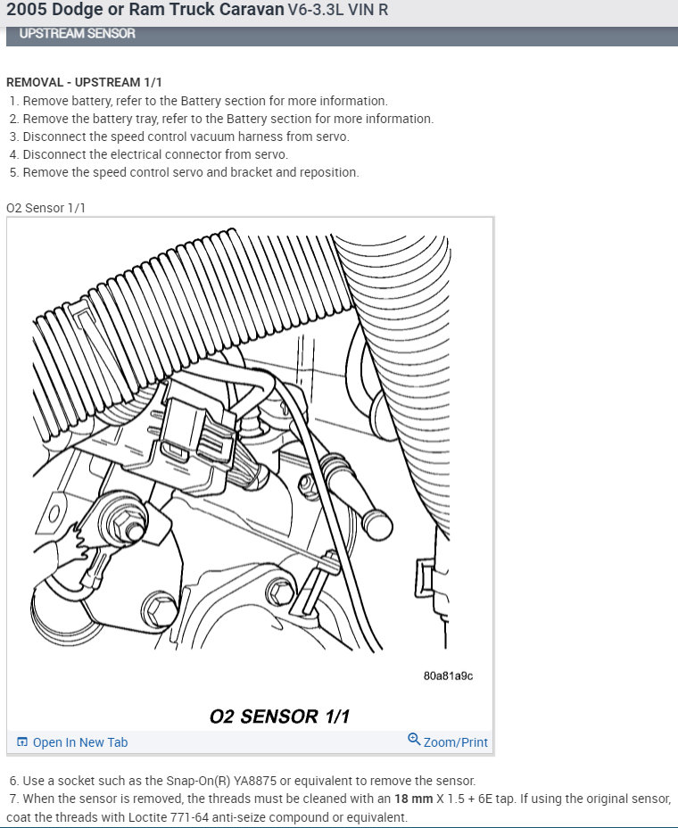

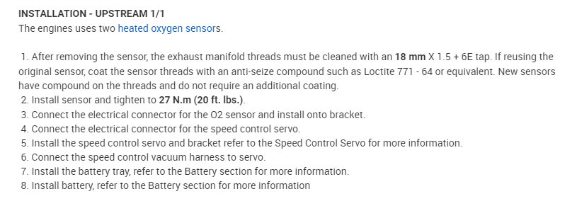

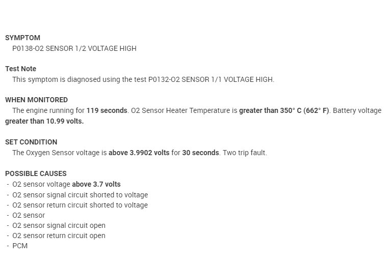

The Code: P0138 - Oxygen sensor voltage high, bank 1 sensor 2.
This code can be triggered due to a bad oxygen sensor, issue with the wiring circuit, faulty PCM.

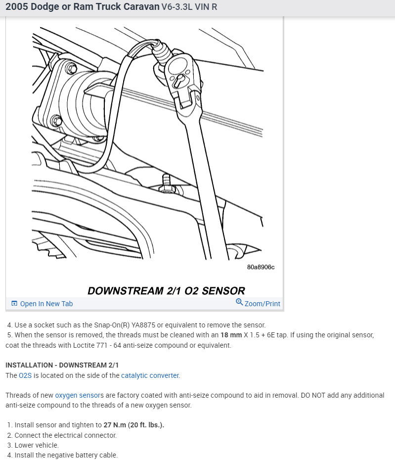

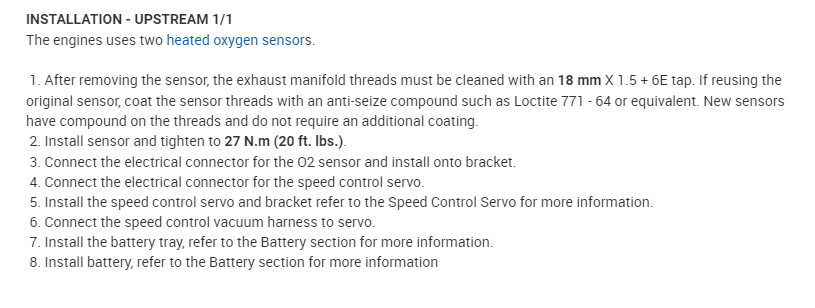

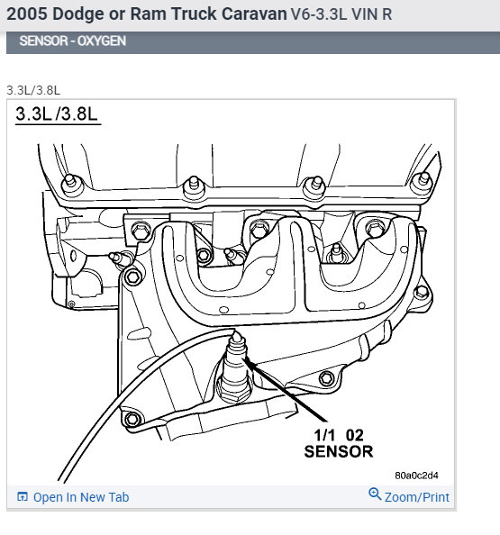

So yes, this can be a bad oxygen sensor, but it could be something else as well. This oxygen sensor bank 1, sensor 2 is located after the catalytic converter (see diagram below)
https://www.2carpros.com/articles/how-to-test-an-oxygen-sensor-02-sensor
https://www.2carpros.com/articles/how-to-replace-an-oxygen-sensor

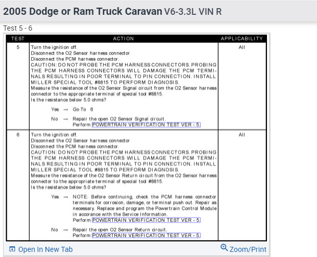

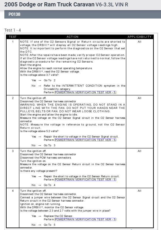

I have attached the trouble shooting steps for this code below.
Follow those steps, as it will help determine the issue.
