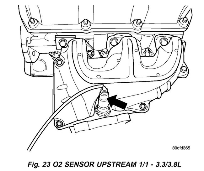

location of 02 sensor, Bank 1 sensor 1
Sep 20, 2010 at 10:40 AM
BLUELIGHTNIN6
Experienced Mechanic
16,542 POSTS
your vehicle's oxygen sensor 1 / 1 is on the exhaust manifold. the oxygen sensor 1 / 2 is in the catalytic converter.
Heres a guide on how to change it, not vehicle specific, but will give you an idea of what to expect
https://www.2carpros.com/articles/how-to-replace-an-oxygen-sensor
See the picture attached below
